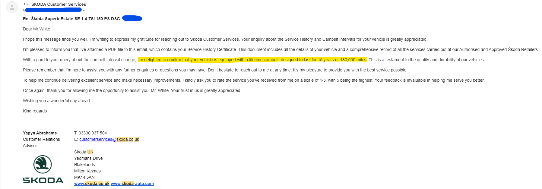

The 1.4 TSI used with the PHEV will have the same Cambelt change as Skoda / VW announced last July.   Long time no bother mister all night long. Years and years no touch.

Apart from the confusing cambelt situation all maintenance items are very similar between the two cars.

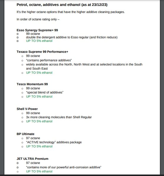

The 1.5 TSI ACT might be as much an issue as the DQ200 DSG attached to it.
If sluggishness is the issue.
Have you tried running it on Tesco Momentum 99 / E5 ?

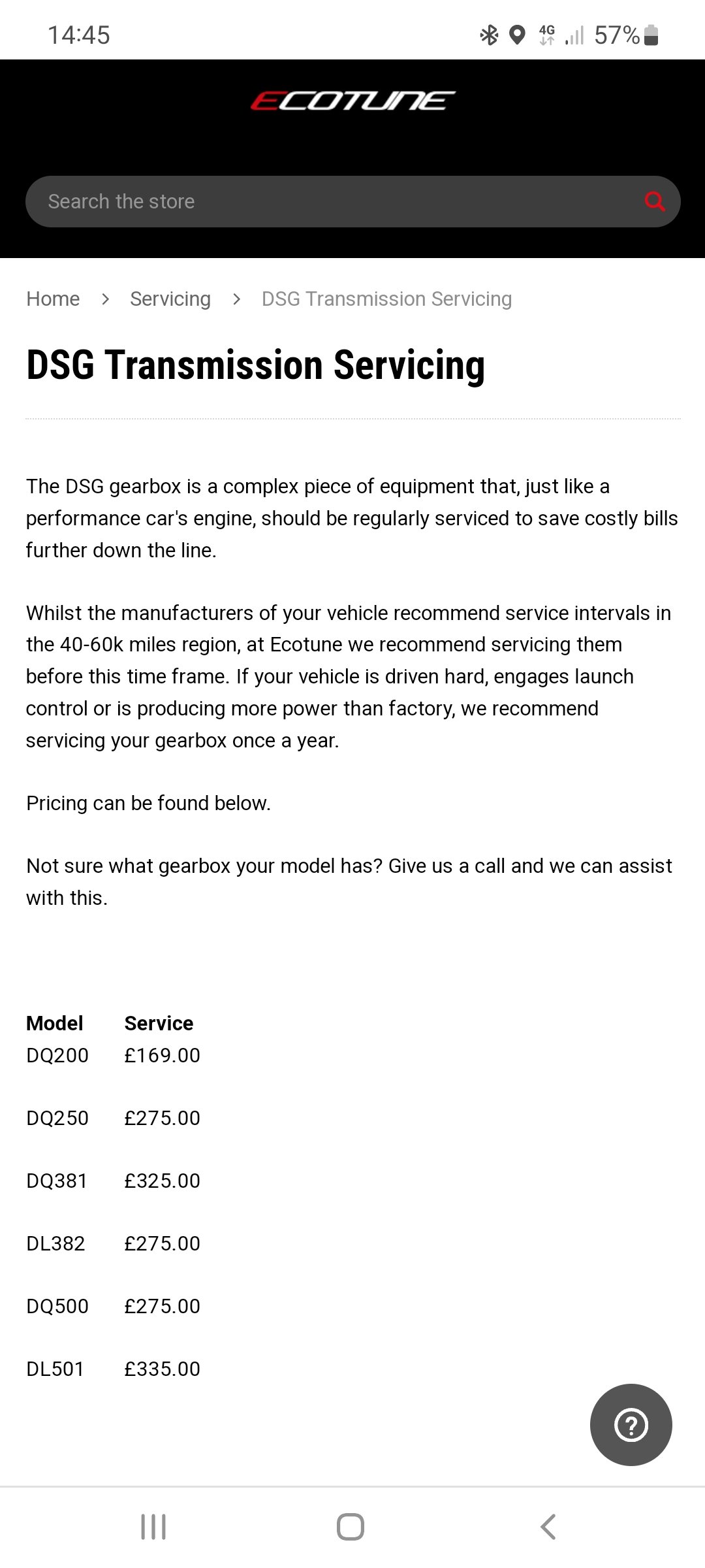

Hi, I occasionally put E5 petrol in, like this tank I filled with Sainsburys E5, but did not notice any difference with gearbox. I can't say it is sluggish, it is totally fine in most cases, only when I slow down to go over long speed bumps that are covered in potholes the gearbox jumps to 1st gear and then very hesitant to move to 2nd, even if I use flappy paddles, until you rev the engine (in 1st gear) up to 3000-3500rpm. I will make a video, it will be easier to show, hopefully.
I have spoken to dealership, couple of times, they say gearbox is fine which it is if you don't have massive speed bumps around! :)
I checked gearbox specialist in Glasgow, they quote £169 for DQ200 service, not sure what they service.
29 minutes ago, Winston_Woof said:
"Eco" Tyres, generally harder compounds for lower rolling resistance. In my experience that also leads to increased noise howver YMMV.
What annoys one person may not bother the next :)
Couldn't agree more. As I said, every one in the garage thinks Superb is dead quiet and when I said it is not they looked at me like I am stupid and know nothis about cars! :)
@Vlady   Is that one of Henry,s in Glasgow quoting £169?    That is guff.
There are 2 oils in a DQ200 DSG.  They would not be replacing both, and no idea why they would replace 1.
That is maybe someone thinking of giving it a 'Reset'.

It is an Ecotune Glasgow, not Henry's.
They know their stuff.
No way would i have them or anyone touch it while it has a Manufacturers Warranty covering it though.
You do not need to pay to have a DQ200 serviced.
 If it needs a Software Update have that done at a Main Dealers with the Master Tech supporting that it needs done.
PS
I would ask Ecotune. What oil are you replacing, in the MCU or the Gearbox.  Damn cheap.

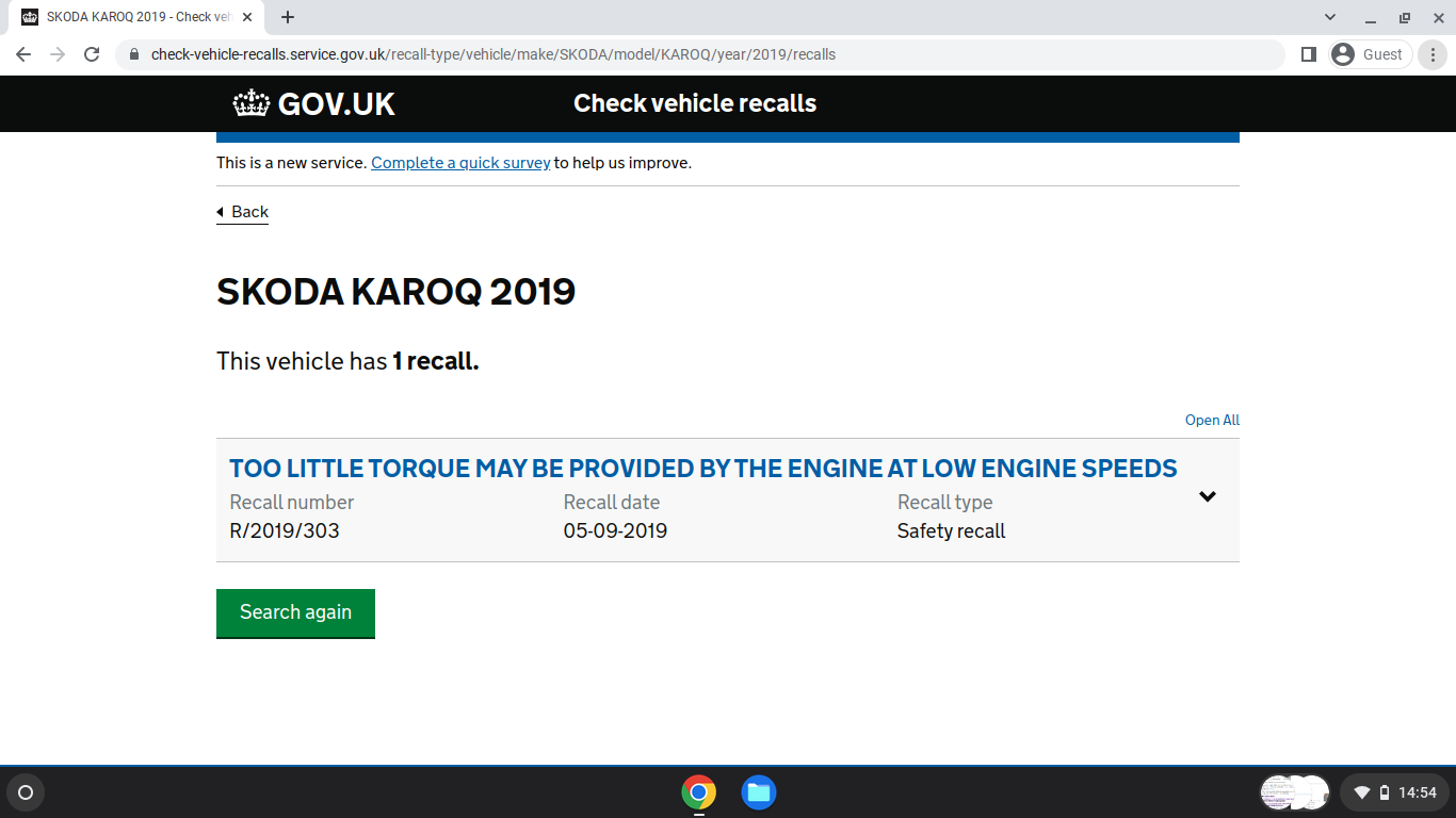

@Vlady   Was your build date after the Recall Action series of vehicles.
Or did Skoda or the dealership say it was?
There was not just a 1.5 TSI ACT engine software update, there were 2 DQ200 DSG updates i believe.

My car is 2019, it still has couple months of additional 2 year warranty but service department at Henry's said the gearbox does not need software update, i asked them before almost straight away after I bought the car. The car, according to them, does not have outstanding recalls either.
It must be something wrong with it, I am surprised no one else had this issue.
Plenty have had the issue.
Plenty were told no software updates available.
   If it is your car then getting a Software Remap of the DSG by EcoTune might be well worth having.
I had Remapped DQ200,s but also Clutch Packs and with Twin Chargers running 200+ bhp.
I would not remap a 1.5 TSI ACT engine though.  I would rather have an Extended Warranty if the car was a keeper.

I don't know , number plates are SJ69MKN, it is end of September or early October registered.
I asked dealership which is Skoda in Glasgow about issues with my gearbox and if all recalls were done, they said gearbox is fine and no recalls are needed to be sorted, I don't know uf they were sorted prior I bought the car or the car just didn't need it.
