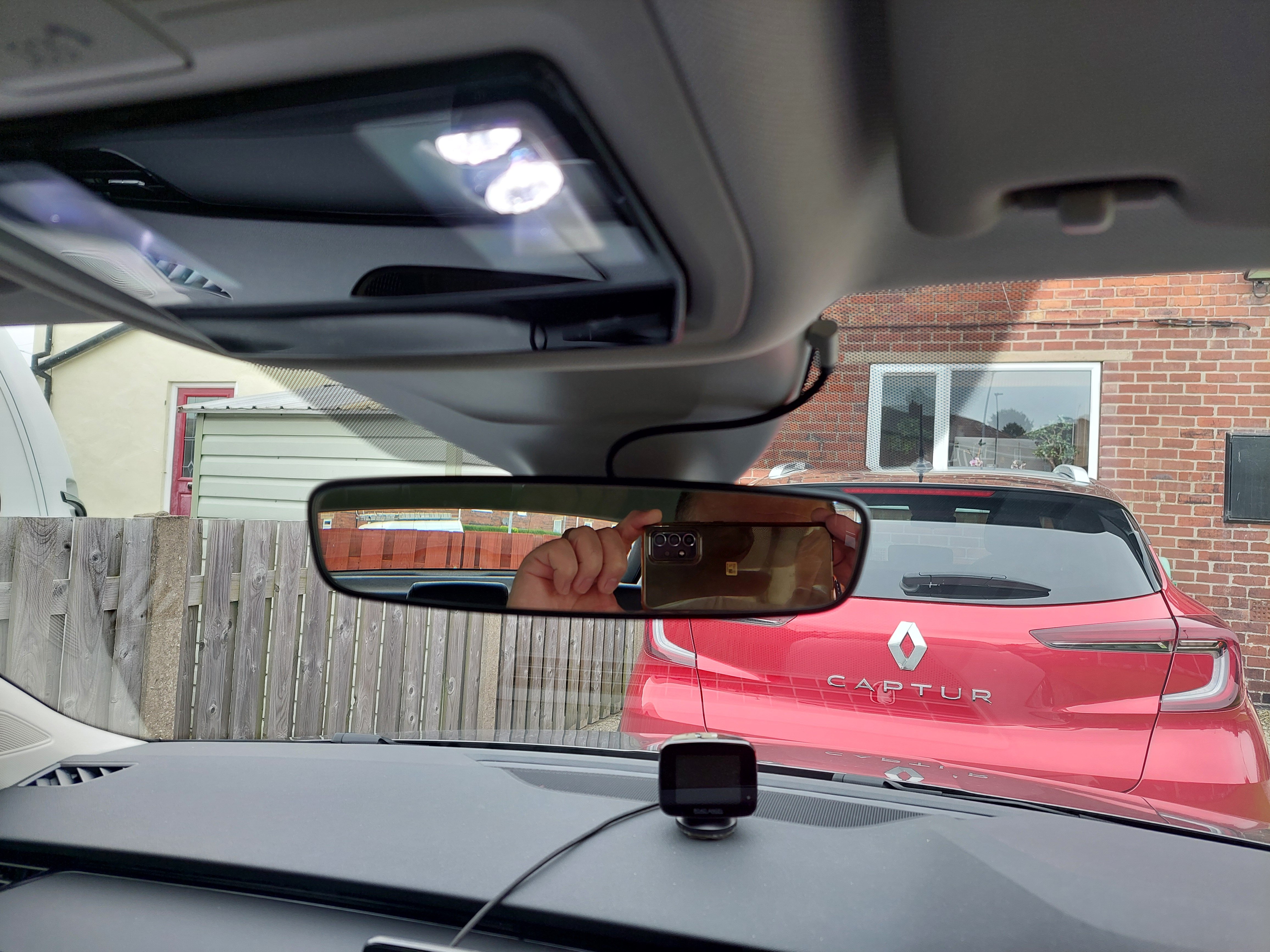

  • Fitted a Garmin Mini 2 over the weekend using a 30cm right angle USB C to right angle Micro USB cable.    I’m happy with the install and how it just blends in around/behind the mirror.
  • This one from Amazon is perfect for mine..  length is ideal with no drooping wire.     0.3m USB C to MICRO USB, OTG cable, charges Micro USB devices, angled plug, data cable, charging c

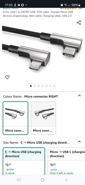

0.3m USB C to MICRO USB, OTG cable, charges Micro USB devices, angled plug, data cable, charging cable, USB 2.0 https://amzn.eu/d/1VpXQDGScreenshot_20240331_170005_Chrome.thumb.jpg.ce1efe1ff181e419550b260e542796e3.jpg

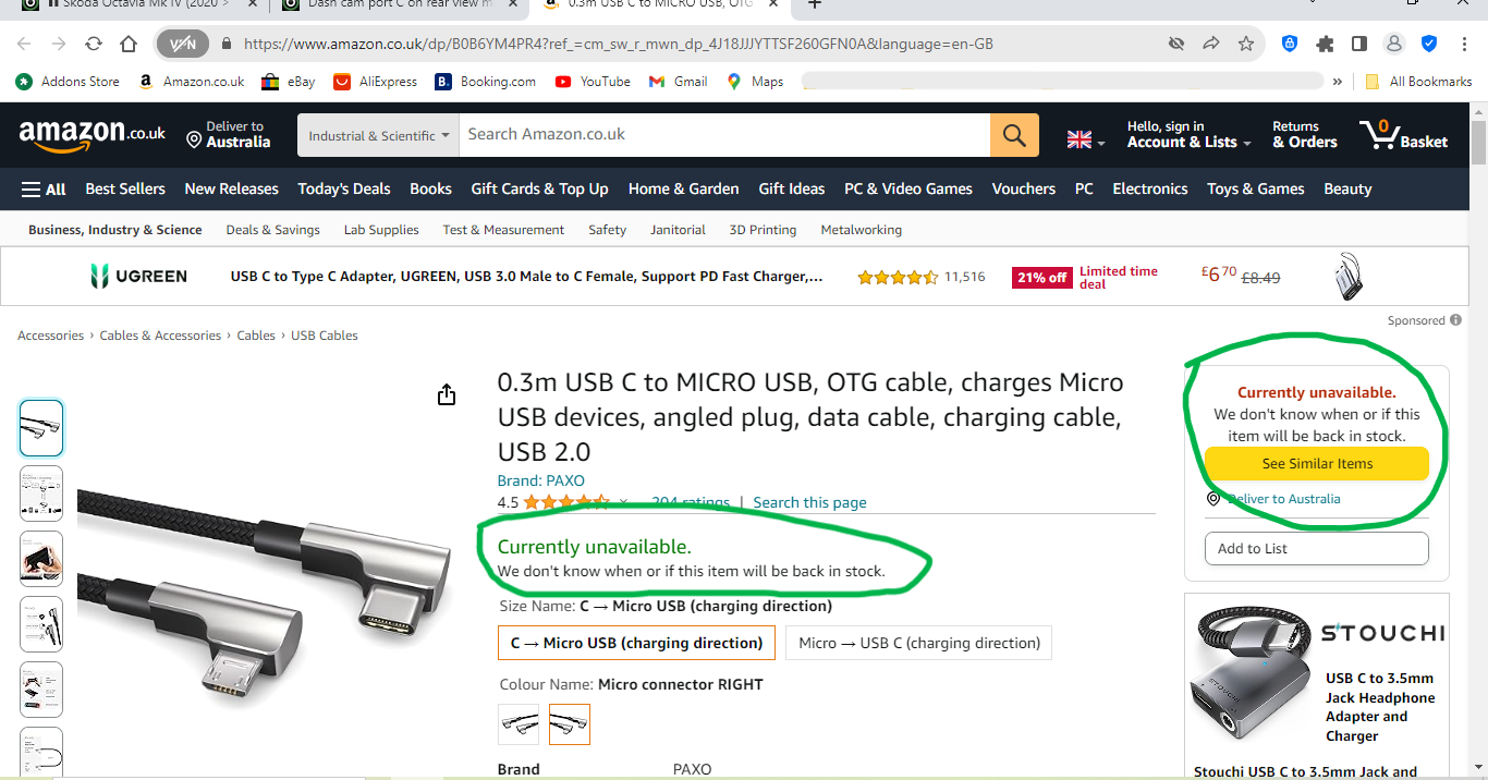

It's still out of stock!! To quote Amazon: "we don't know when or if this item will be back in stock". Searched exhaustively and can't find this exact cable anywhere.
Strange... if you click on the link ( in green ) it's showing as in stock
Says it's in stock for me. Prime next day delivery
Strange indeed, no idea what's going on. I've clicked on your link each time I've looked. For some bizarre reason I must be getting a different page, even though it's taken me to Amazon UK as it should. Just for your interest, here's a screenshot of what I'm seeing:
Your screenshot of the Amazon UK site states 'deliver to Australia'. Pretty sure that's why it's showing not available for you.
I doubt it. Whenever delivery to our region isn't applicable, which sometimes occurs from foreign Amazon regions, the message is always specific in that context i.e. it wouldn't say the item is "out of stock", or "we don't know if or when the item will be available", it would simply say "delivery unavailable to your region". This particular situation is very odd.
I just set my VPN to Melbourne, and my Amazon location to Australia. The lead is showing as not available.
Switched it all back to UK and it's in stock with next day delivery.
I think that is your answer I'm afraid.

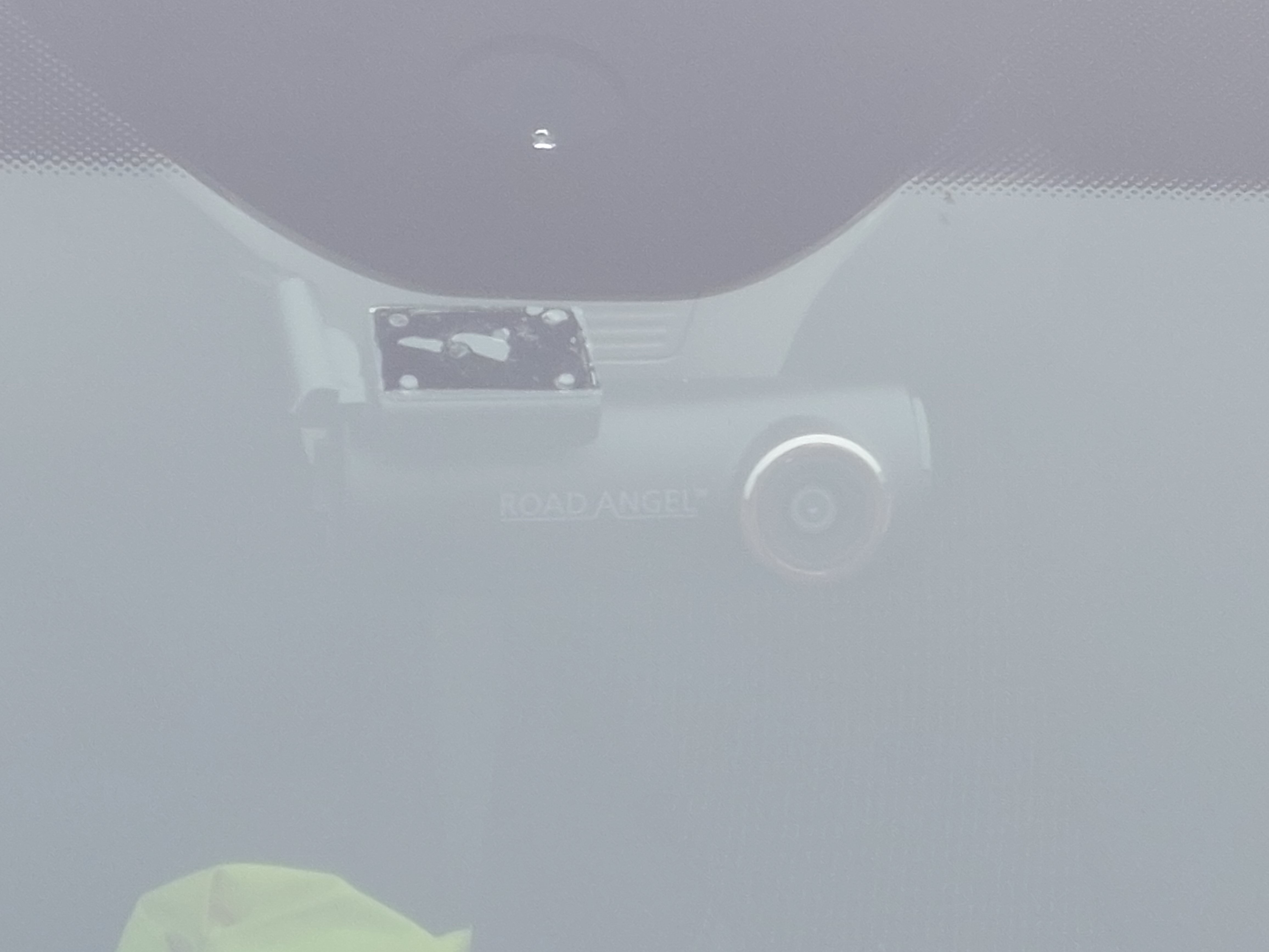

Hi newbie here. I have the 1.4 IV and was also impressed with a USB C in the rear view mirror housing. I would just like to add that i had front and rear in my Volvo but the front camera will not power up from this usb c port at all. I have the road angel halo ultra which is the model that will not power up as i believe there is to little current to power it up.
I have fitted the road angel halo drive which is fine.
I would just check the power requirements before you take the plunge and buy a FFC. The road angel is a neat and compact unit and sits behind the rear view mirror and with the ucb c to usb c 30cm cable its also very discreet.

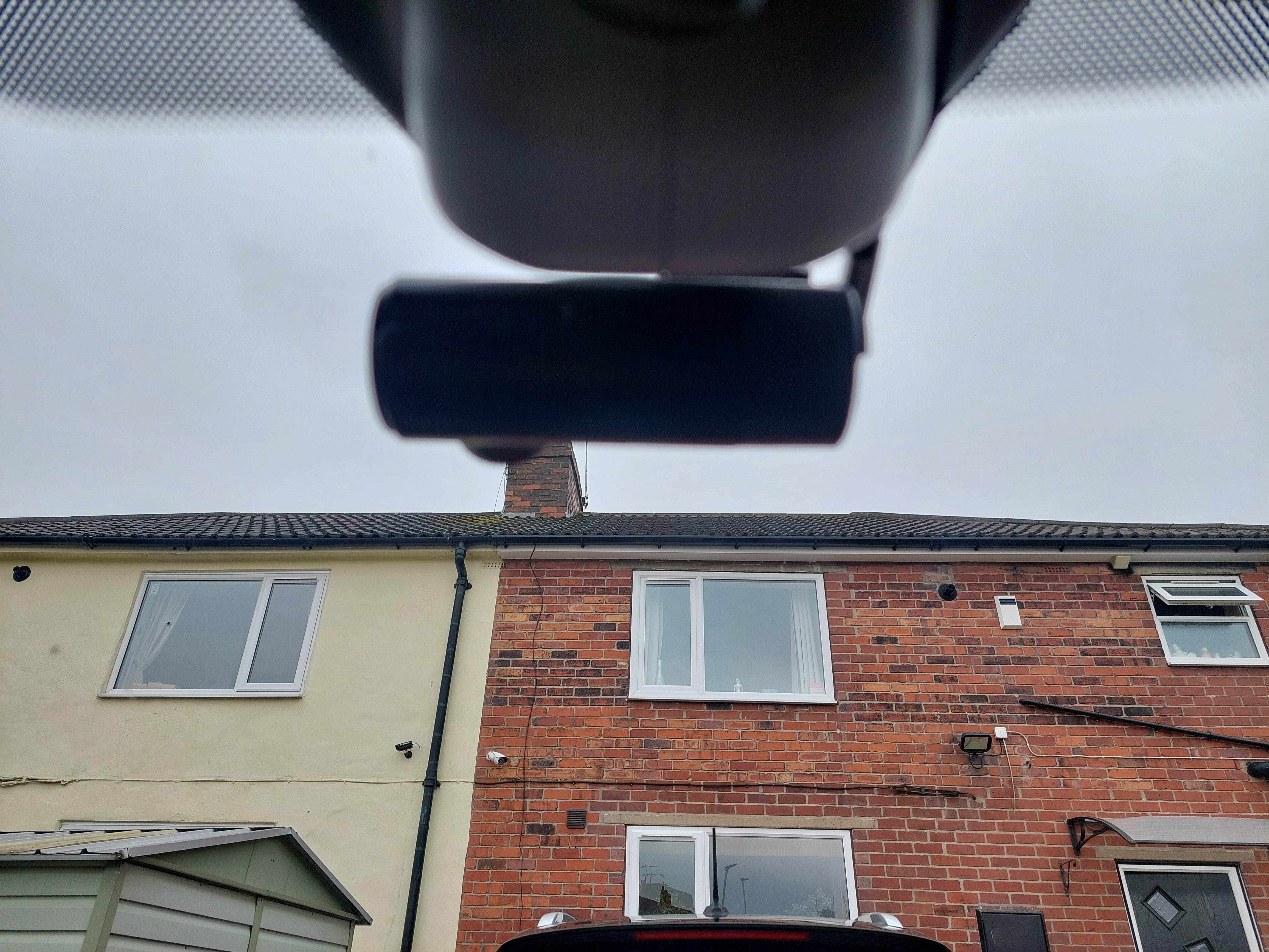

I will take a couple of photos to show mine...
hope this helps
Nicely hidden behind the mirror! Thanks

Hi i have had a couple of makes, I had road hawk for a few good years but recently say a couple of years ago i changed to road angel. In my XC 40 i had this camera in the rear and the road angel halo ultra in the front but as i said the usb c will not power up the ultra model, it also wont from the 2 usb c ports in the centre console nor the one in the rear.
I don't subscribe to the ones with screens in them as i think you are paying for something that isn't really needed. The road angel has Wi-Fi connectivity to view and download clips which is fine for me. i haven't put one in the rear as the car i have wasn't specked with a rear wash wipe which is beyond me lol..
