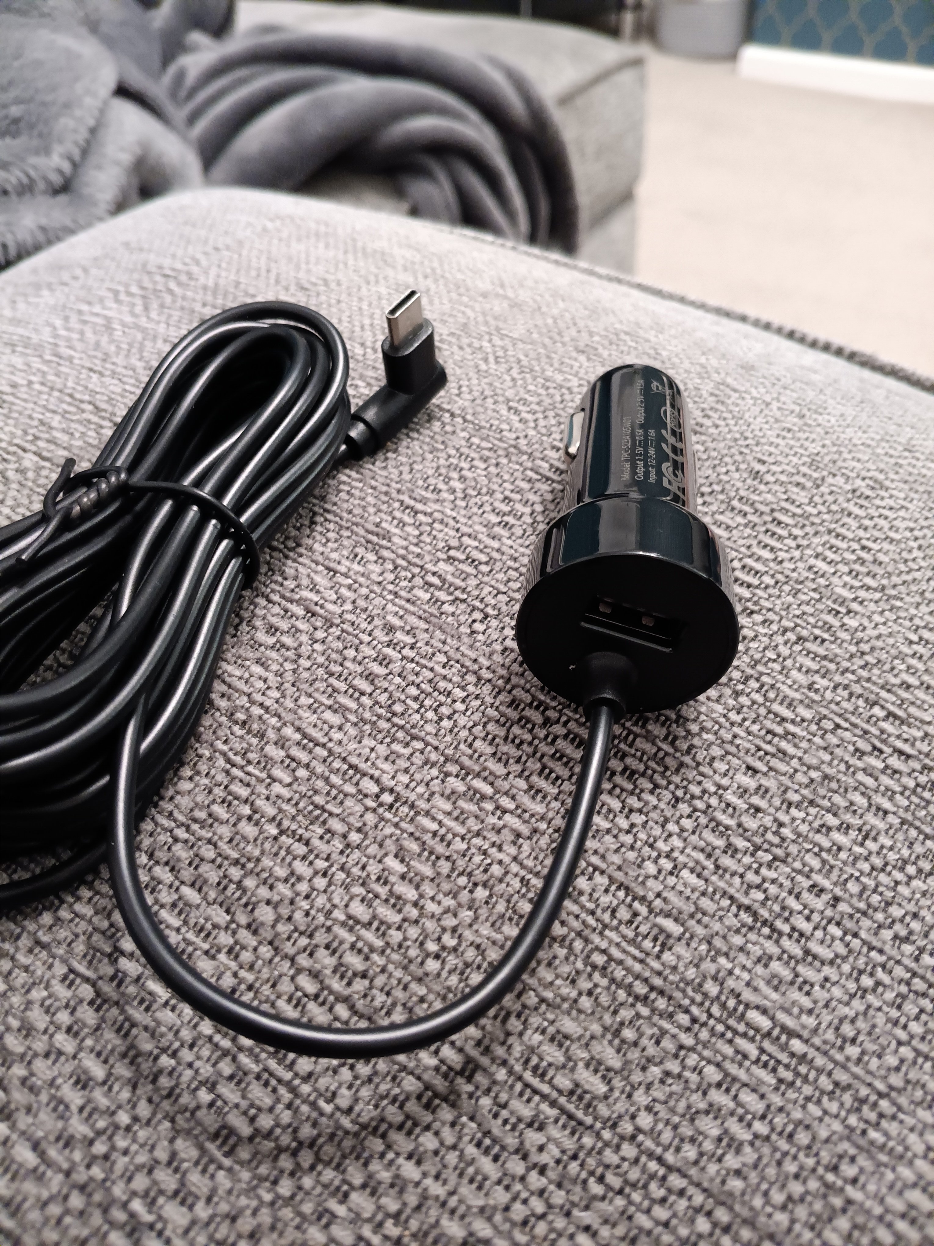

Just got a dash cam with USB C port. Plugged my USB C to USB C cable in to the mirror port try to power it.
No power up. Tried all the car C ports and no joy.
Only powers up from the 12v cigarette socket.
All the dash cams I see on Amazon etc all seem to have the 12v cigarette cable from the pictures so I assumed 🙄 that the USB C port would just power it although I know its only 5v

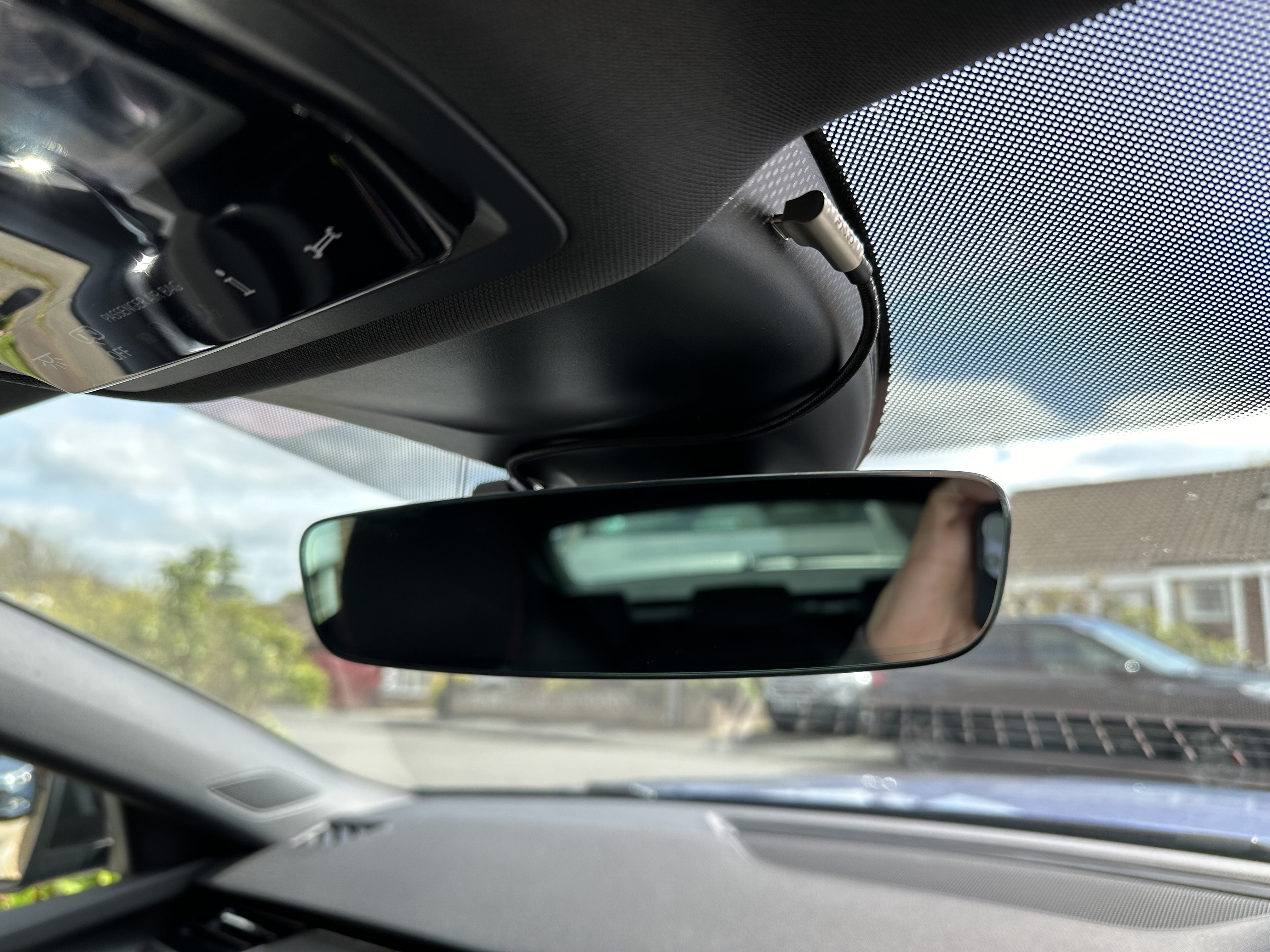

  • Fitted a Garmin Mini 2 over the weekend using a 30cm right angle USB C to right angle Micro USB cable.    I’m happy with the install and how it just blends in around/behind the mirror.
  • This one from Amazon is perfect for mine..  length is ideal with no drooping wire.     0.3m USB C to MICRO USB, OTG cable, charges Micro USB devices, angled plug, data cable, charging c

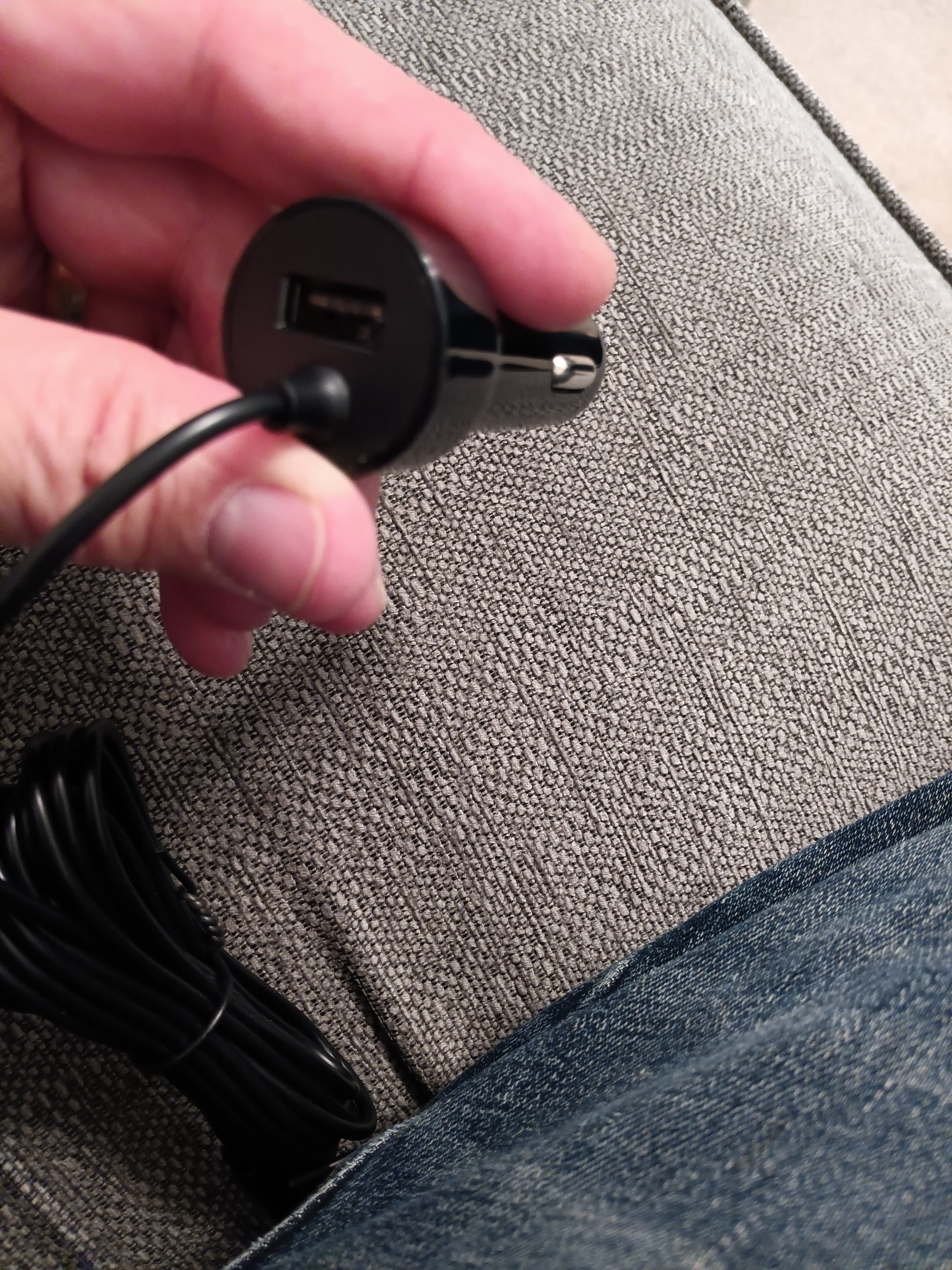

i know it will be too long but have you tried the cable that plugs into the 12v lighter plug or is that not usbc?
The lead is USB C from the camera to the 9v cig plug in. The sig plug in has a USB port too.
Only other lead in the pack is the rear view camera
The plug will have voltage output and current output on it, i managed to make out 5v on the amazon advert but couldn't read the amp draw needed.
