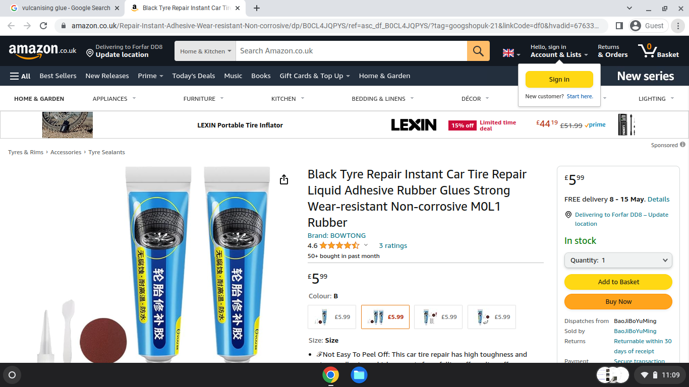

As to the tyre having a cut on the sidewall, what do you think to applying a dab of superglue to keep this together? There used to be TV advert years ago where superglue was used to mend a fan belt which had been cut in half, good idea or not?

If a flap of tyre was to get glued down then Black Bostik has been the Kerb Side Auto way, or vulcanising glue.  Puncture repair glue. both surfaces left to dry almost. then put together.
Bodging R'us!
Edited by Rooted
Bodging R'us!
