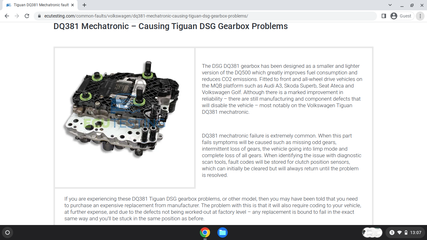

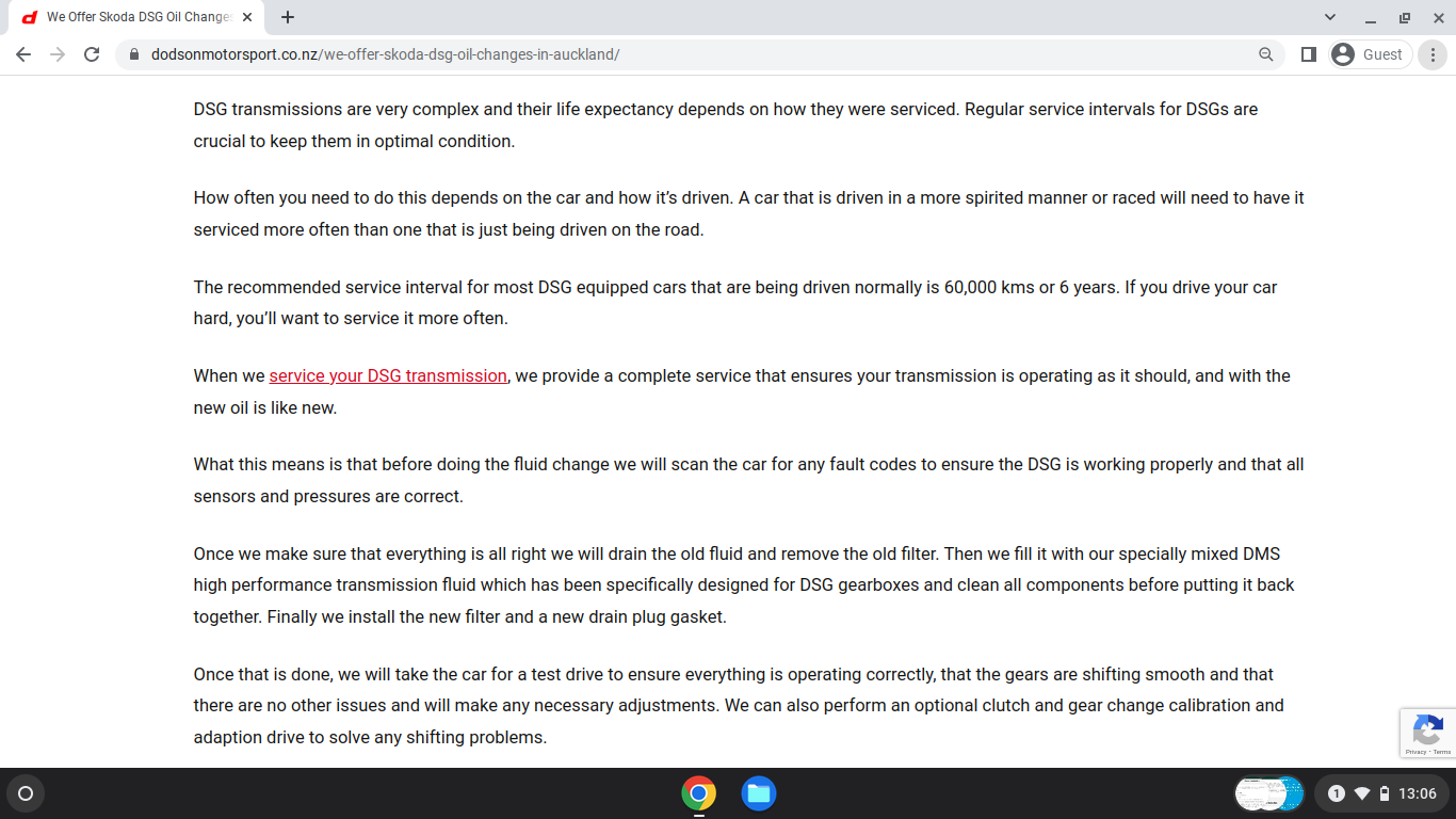

Sadly if a DQ381 7 Speed Wet Clutch with the RS the Service Schedule is at 80,000 still according to VW Group.
That might be reduced considering the growing number have issues with these DSG, particularly the MCU,s.  Time will tell.
As long as the Warranty is covering it.    If anyone at a dealers says never heard of issues that might be because they are deaf.
You do get treated better in NZ than the Rest of World.
Back in 2012 when there was a Global Recall on DQ200,s and that Excluded Europe as VW tell Europe what to do, there was a Recall / Service Campaign in NZ and all cars with a DQ200 got new MCU,s.
Rest of World, Synthetic oil change to mineral and a software update.  So regions a 10 year / 100,000 mile warranty.
EU / UK / Europe, nowt till 2014 & that was not a Recall, just a service campaign, Oil & Software.  No Warranty extension.

I have checked with the dealer the gearbox in the RS is indeed the 381. The service interval is 60,000km. The first service is included in the 5 year service plan but is not included if one opts for the 3 year service plan.
@HenryNZ  Either VW / Skoda have changed the Schedule / Guidelines for Oil Changes of DQ381, or who gave you the information does not know what a DQ381 DSG is and is going by the Servicing of DQ250,s or DQ400-e,s
http://briskoda.net/forums/topic/514055-karoq-7-speed-dsg-fault-4x4
This is an issue with people and places that customers trust to get accurate information from and servicing and maintenance.
Always get stuff in writing and their name and job title, and signed,
Email reply from the salesman: “the vRS is using a DQ381 transmission, service is every 60K generally unless otherwise stated by time. A DSG service is included in the price if you go for the 5-year service plan. If you go for the 3-year service plan, then you’ll have to cover the costs.”
I note 60,000 km is about 40,000 miles; perhaps they have changed the servicing interval here to 40,000 miles? Are the megatronic faults related to service frequency? If one is to service DSG more frequently, will it reduce the risk of the reported faults?

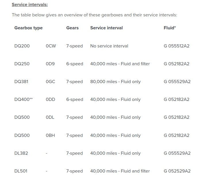

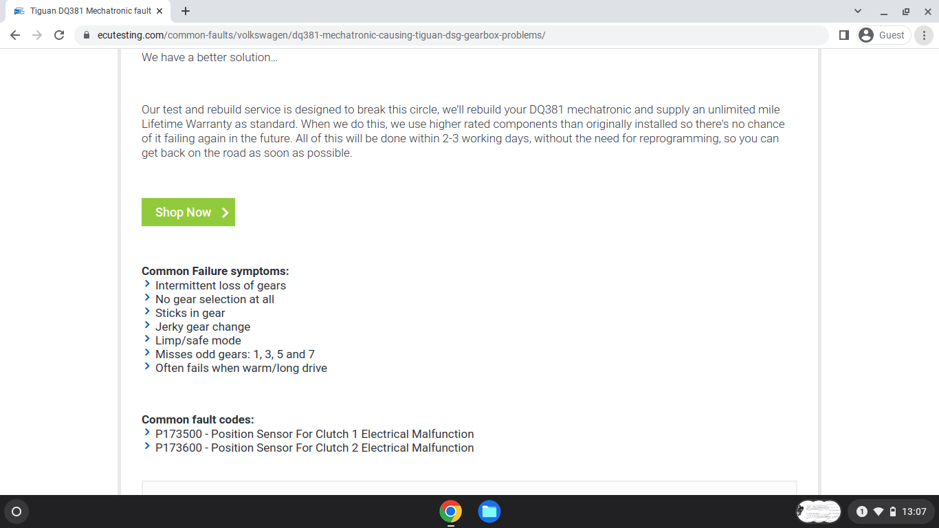

@HenryNZ  Thanks. So the Salesman needs to 'Phone a friend',  and DSG,s have never had servicing Schedules , Guidelines, Recommendations or Advice on Servicing by time.
It was just Service Charts that lead people to think of at 4 years / 40,000 miles / 60,000 km.

& they are fabulous.   But the wet clutch ones have the same oil in the box and the ECU and really changing a filter seems to be just 'Simply Clever' and 40,000 miles oil changes.
(Audi say 38,000 miles.)
The 80,000 Schedule on DQ381,s are making no differences because MCU,s have needed to be replaced on more and more long before even 40,000 miles has been covered.
Plenty people offering MCU repairs rather than Replacement.     Lets see in the coming years if VW have yet again ba-llsed things up.
