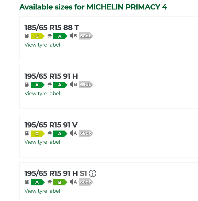

The same tyres in different sizes can have different ratings too
Screenshot2024-04-26at22-12-59MICHELINPRIMACY4TyresATSEuromaster.png.f7972f02bde3e3050fb69a08c31296bf.png
Screenshot2024-04-26at22-16-47MICHELINCROSSCLIMATE2TyresATSEuromaster.png.77be9177a5fbef1a7a96a4ff0916adcb.png
