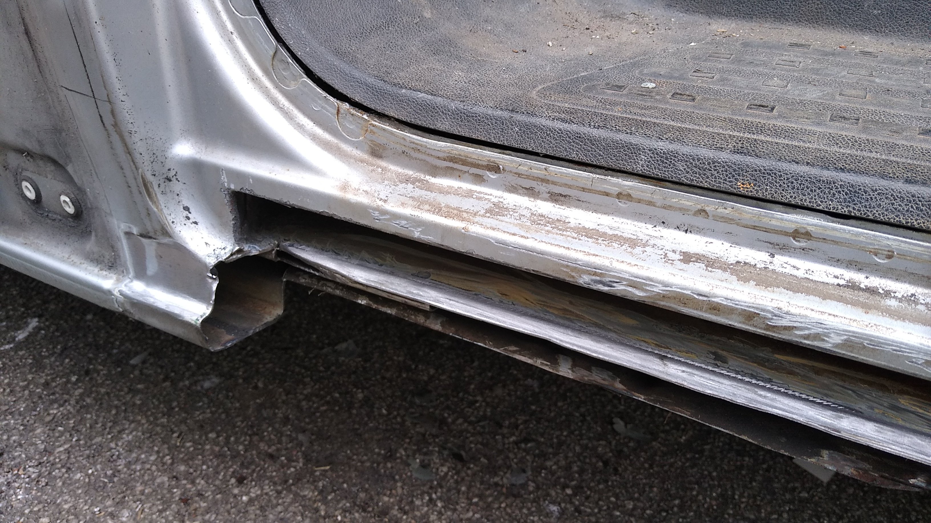

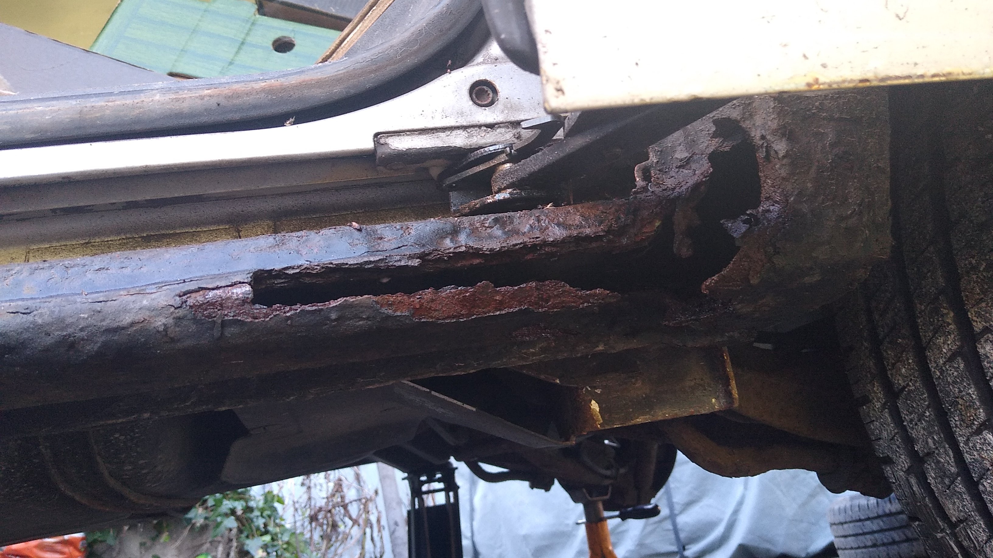

ok, I did some stuff... I pointed a needle scaler at various bits and lopped the back off the sill.
There's so much more going on in here than at the previous spot we did.
counting from the right in the next photo; the third bit of metal needs repaired, whereas the second bit is actually fine.
The left hand bit is box section, I guess, but it's not giving me access to the third bit I need to patch.
I can either cut out good metal to get access and stitch it back in, or repair the box section by doing it as two Ls that join underneath.
i can't really weld at the innermost side either because the suspension is in the way... it COULD be dropped, but urgh.
Either that or plate over the lot and lap weld and cry and pretend it's NOT a jacking point :D
Anyway I'm thinking about it.

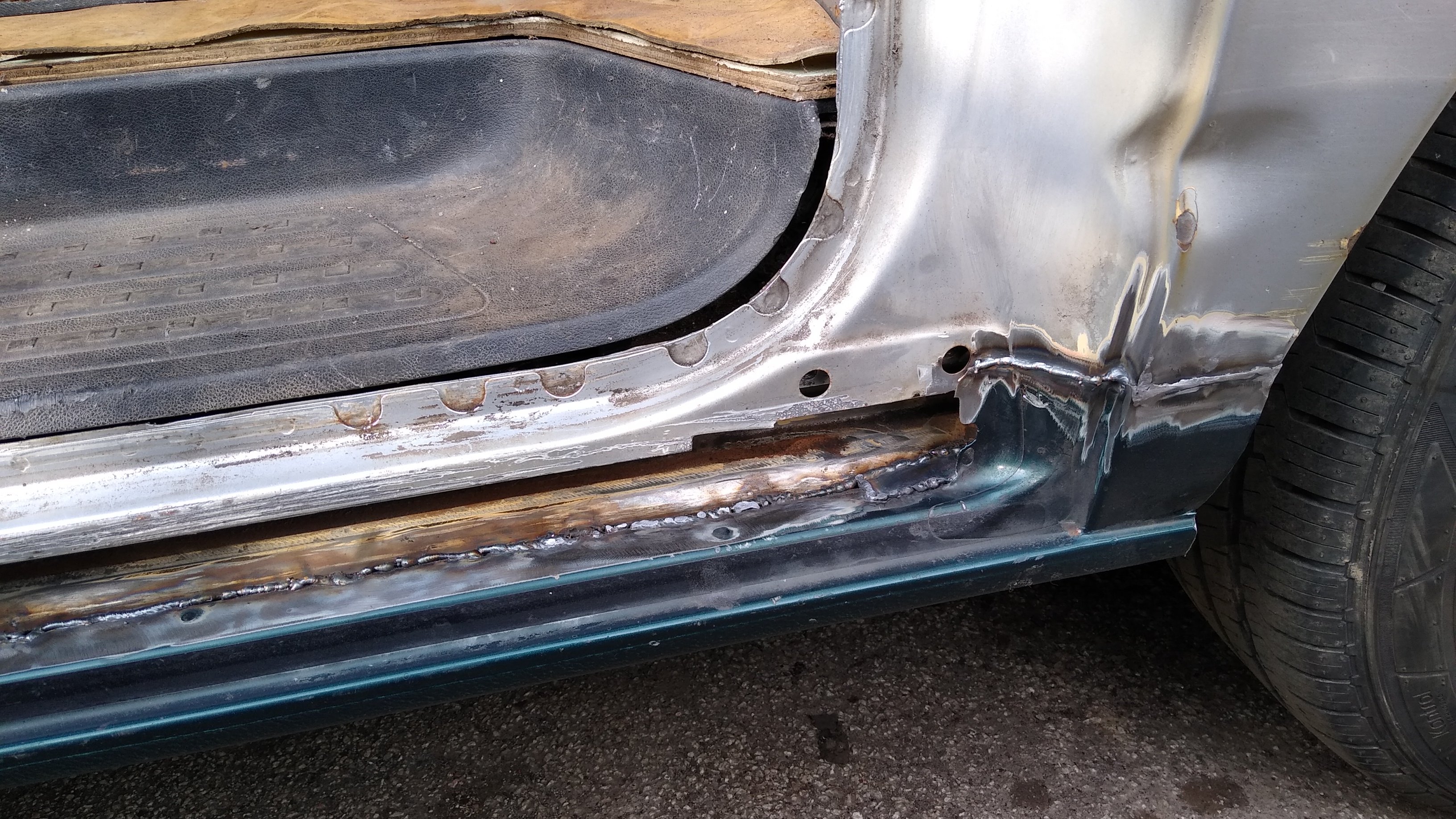

Only just come across this thread. I will be watching with interest. Great work and perseverance. :) I know what you mean about the welding (lying on your back getting burns from sparks like bad wasp stings!) And what you often start with can look pretty scary. I had a poorly repaired sill rot out on my T5 van after 10 years. This is what it looked like after a dig around with a screwdriver..
Old sill cut out
Second hand sill (body cut) welded in.
I was lucky my rust was so limited so kudos to you for sticking at it with yours. 👍 You will get there and not many folks will be able to match your story in the pub! :)
yeh, turns out I don't have to cut back too far to get good metal, but the geometry is now killing me.
