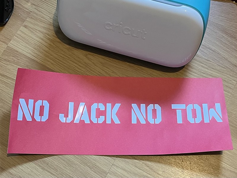

It still needs more time to set up, but in the meantime I squitted this out of my tiny cricut as a stencil for the yellow paint I got.
It's sticky backed stuff, so i should be able to slap it on the axle, mash around it and go to town for a few coats of yellow.
Hopefully that will produce sharp enough text to be readable after 50,000 miles. After it's coloured in, I'll shove some top clear coat over it to try and protect it a bit.

Tomorrow I plan to get the no jack warning painted on the axle, the hammerite has had plenty of time to settle.

The vinyl was **** and didn't stick to the axle, I got it on there with frog tape but it wasn't TIGHT like we needed it to be.
I threw some yellow at it because, well, we're here now.
and tbh it'll be perfectly fine for what i need it to do, remind me not to break this beam, after i touch it up with a black paint stick.

I touched up the DON'T sign on the beam with a paint pen so it's a bit more readable.
