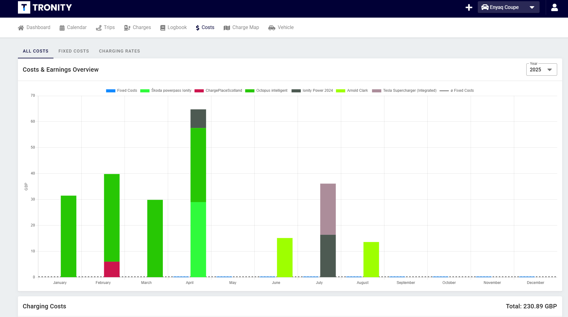

Here's the snapshot for 2025 so far:
Distance covered: 7,157.54 miles
Number of trips: 61
Total charging cost: £230.89
The graph below covers both public charging and charging at home both on grid and from solar (which is why the Summer months show close to zero cost).
To put that in perspective: that’s about the cost of 2.7 fill-ups for my diesel VW T6 camper van — which would only get me around 1,168 miles. And that’s with a respectable 40 mpg, hauling beds, a cooker, fridge, and more.
Of course, the economics shift if you can’t charge at home. But for me, home charging not only makes the car cheaper to run — it also slashes our household energy costs. Compared to neighbours still using gas heating, our winter energy bills were around five times lower.
