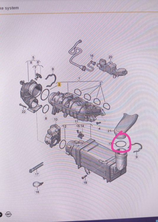

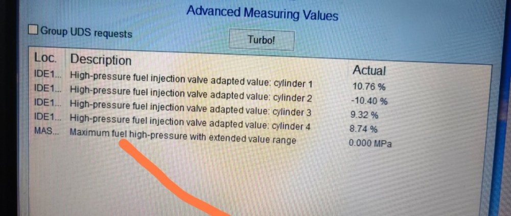

Hello. I think i have fixed the problem. I have found that i have a missing oring... now the misfires are very rarely and i have only at the starting engine for 30 second and the running is very bad... I have checked and i have -13 for injector 2. I have used an aditiv for cleaning and now is -10, and at idle the running of engine is not smoothly.
