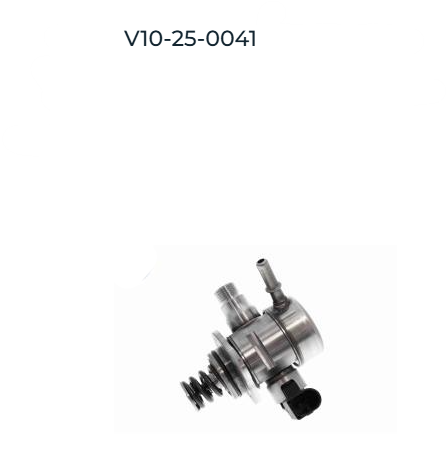

I’m thinking that both are linked and there must be an issue with the high pressure fuel pump but I really can’t afford to fire the parts cannon at it any longer.

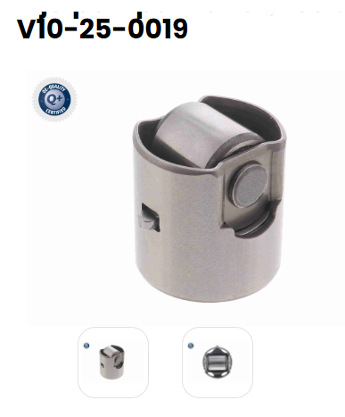

I guess the fuel problems are due to the high pressure pump, more exactly with the piston on the bottom of the pump that can be changed separately.
As of my knowledge they must be changed at every 40k to 60k Km.
