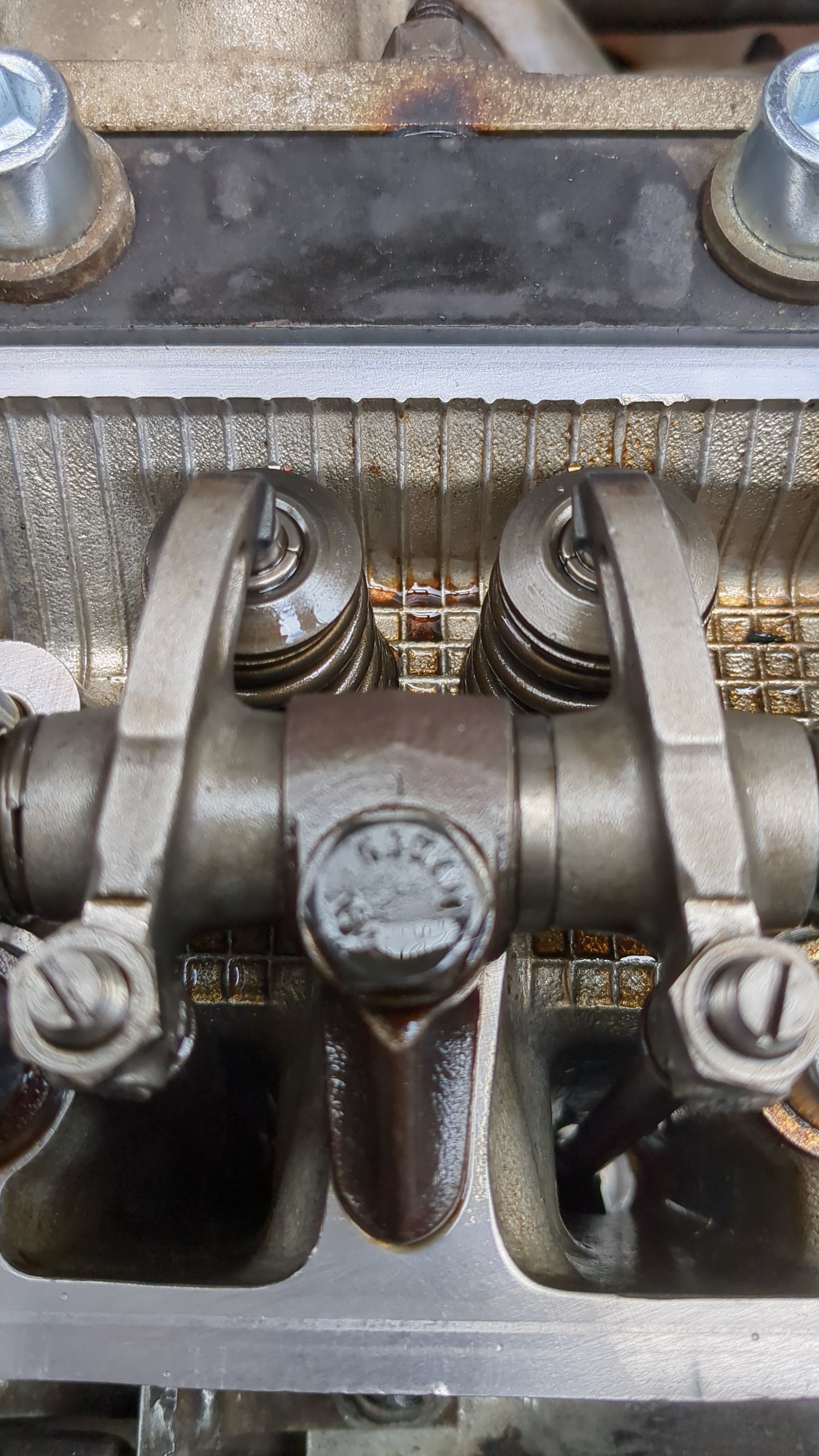

I put on piston 1 and with the exhaust valve closing and the intake valve starting to open from piston 4 I tune piston 4 with 0.20mm and 0.25mm ... then piston 3 with piston 1 etc ... Right?

Before proceeding further check the valve clearance or better yet completely remove the valve train and perform compression test again
When cylinder 4 has both valves overlapping you adjust cylinder 1
When cylinder 2 has both valves overlapping you adjust cylinder 3
When cylinder 1 has both valves overlapping you adjust cylinder 4
When cylinder 3 has both valves overlapping you adjust cylinder 2

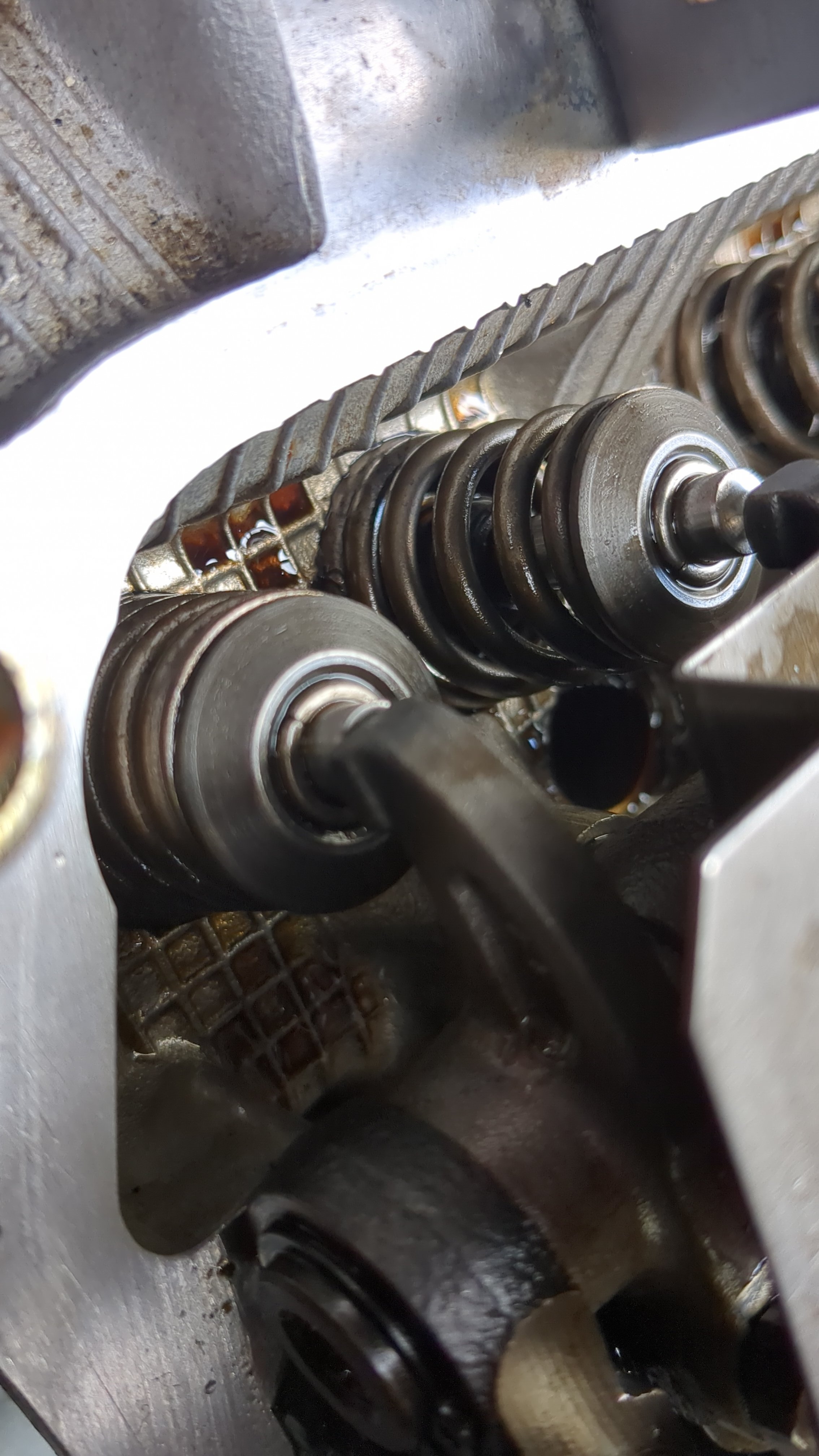

For example, when I overlap cylinder 4 with cylinder 1, only the intake valve is loose and the exhaust valve is tight and can't be relieved, so the spring is always under pressure.
Cylinder 4
Cylinder 1
Its the same for cylinder 2 (overlap) with cylinder 3..
The intake was closed and the exhaust valve was open. And even if you loosen the exhaust screw, it's always under pressure and you can't fine-tune it.
I think you havent understand what valve overlap is
While rotating the engine your helper keeps an eye on cylinder 4 valves
The sequence is going to be
Intake valve will open
Intake valve will close
Compression stroke
Power stroke
Exhaust valve will open
Then will come a time where as THE EXHAUST VALVE IS CLOSING THE INTAKE ONE IS OPENING, so both valves will be slightly depressed at the same time.
This is the point where you stop and adjust cylinder 1 valves

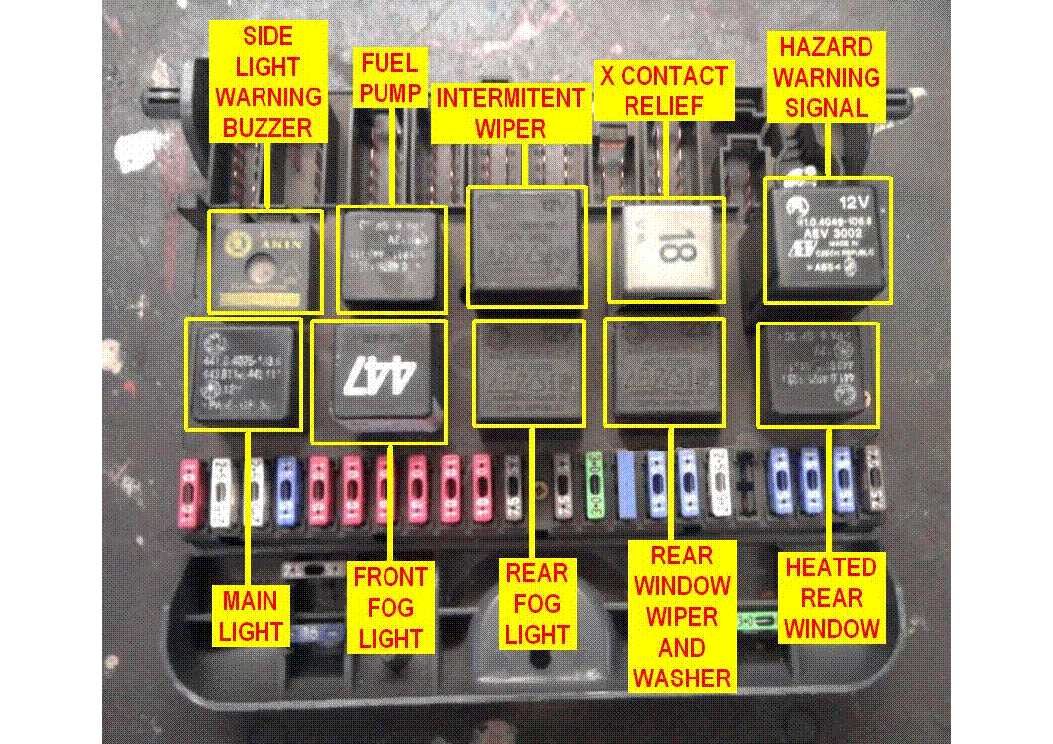

His ignition fuses are the first 10 and the third 15 ... The relays aren't part of the ignition, right?
Any suggestions?
