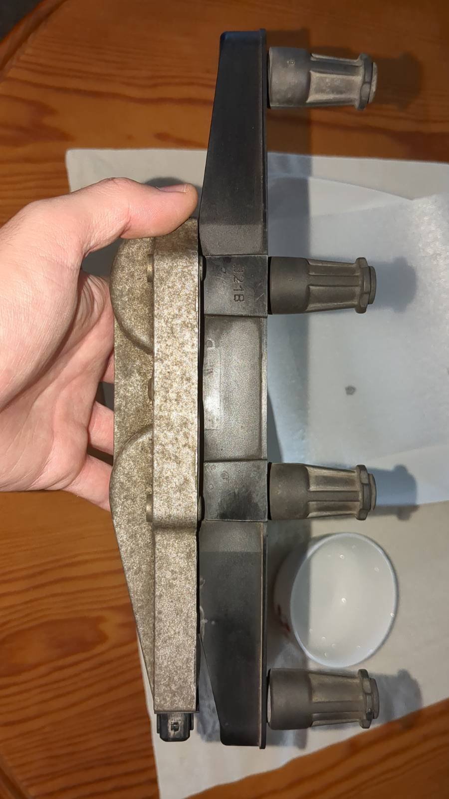

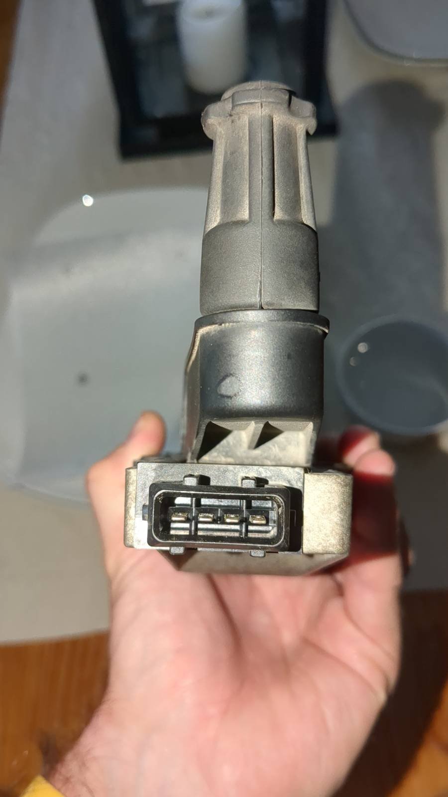

I began to think it was strange and that it might be the spark plug coil that wasn't sparking the plugs.

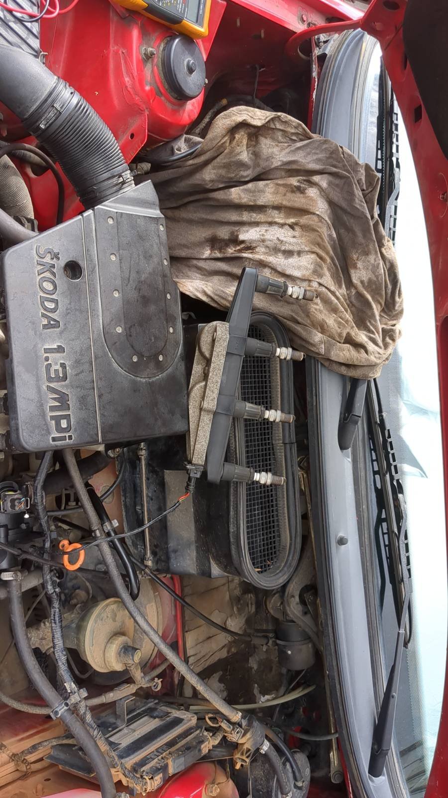

Is it OK to test the spark plugs in this way if they spark?
I don't know if you can tell me the correct measurement values for these coils.

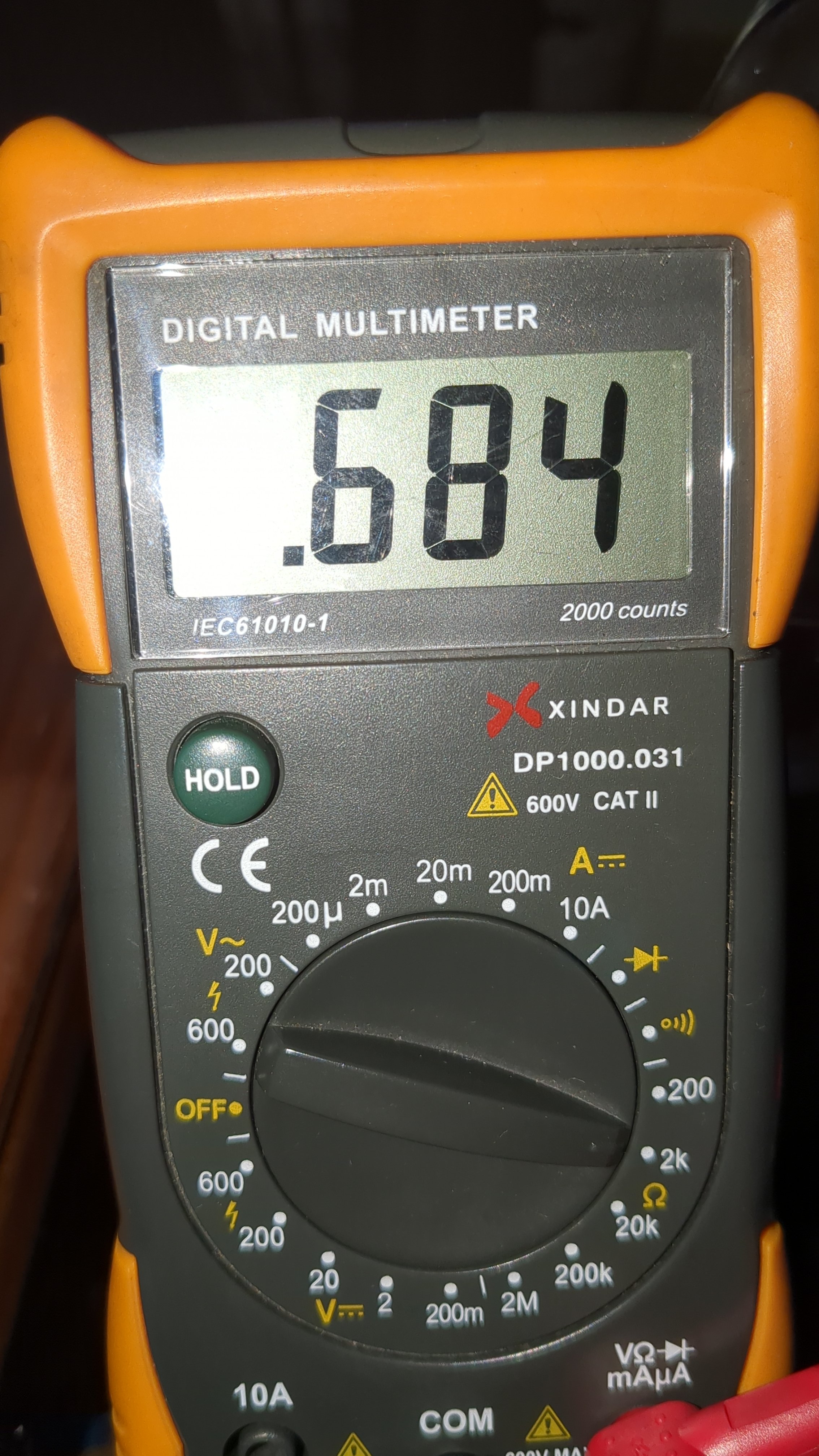

I measure the coil itself, where the old ones fit in, and they're all around 8.30ohms.
I measured the pins where the plug fits, and on the multimeter in the diode area, I measured the pins and it only read the 2nd, 3rd and 4th pins, giving 1.5 and 1.9, more or less.

I also forgot to mention that when I try to start the car, the pistons/plugs are filled with gasoline, i.e. there doesn't seem to be any spark, whether the plugs are old or new.
I it looks like the problem is in the coil.
they don't spark at all, neither with the new spark plugs nor with the old ones.

They won't spark like this. The plugs need to be connected to ground, normally it's done through the engine block.
Oh correct..
Can I touch the spark plug to the valve cover? And is that the right part of the spark plug?
Do they all need to be or is just one enough?
The problem is that the spark plugs are filled with petrol when I try to start the motor, because there is no explosion/spark.
So... I went to test the ignition coil again.
(the video makes some noise)
The ignition coil is ok alright ? Does the spark seem ok?

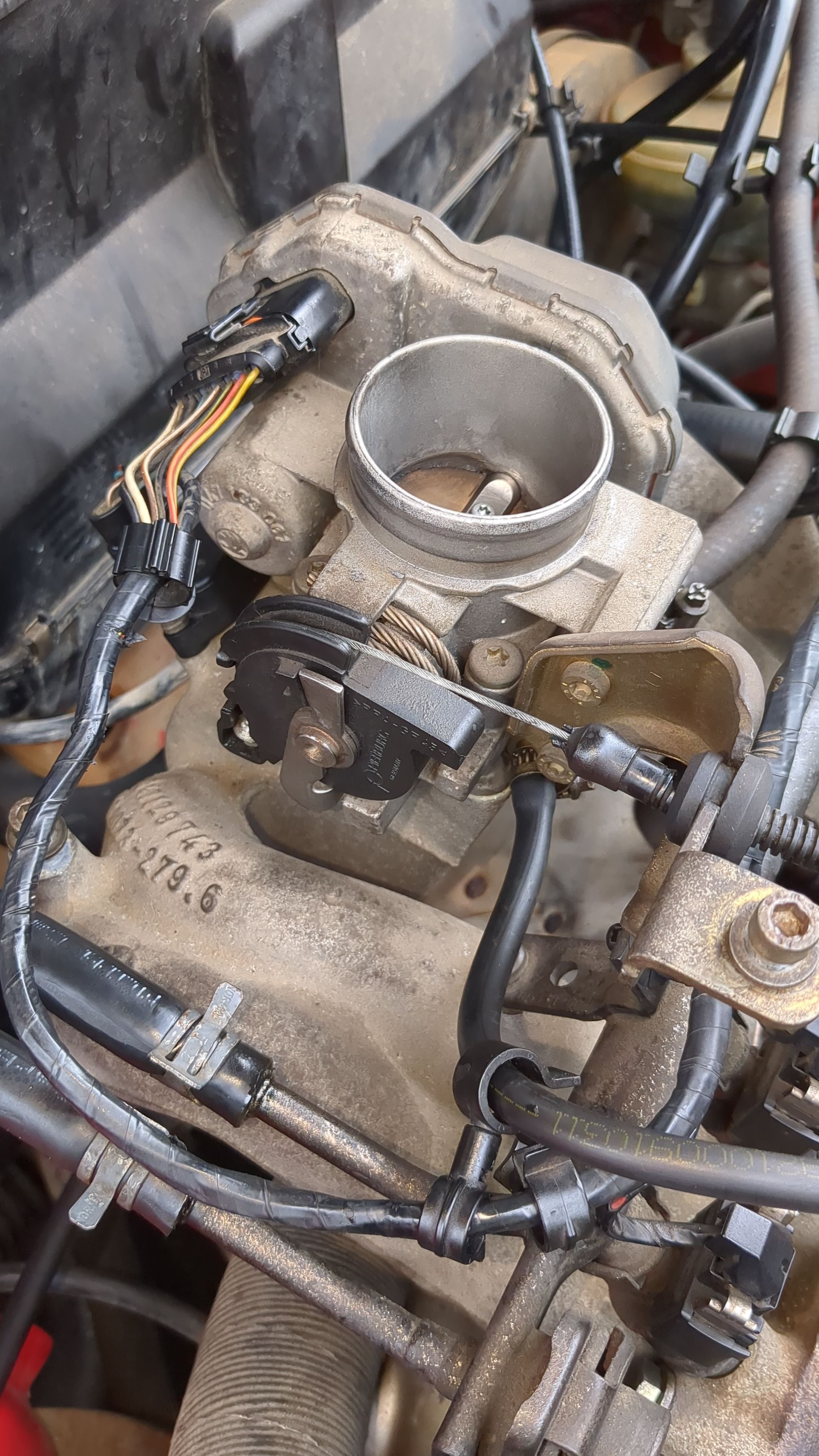

When I turn the key and it tries to start, shouldn't the throttle open slightly?
While I was trying to open the throttle, I could sometimes hear a explosion (plok).
The video starting..
Opening the butterfly

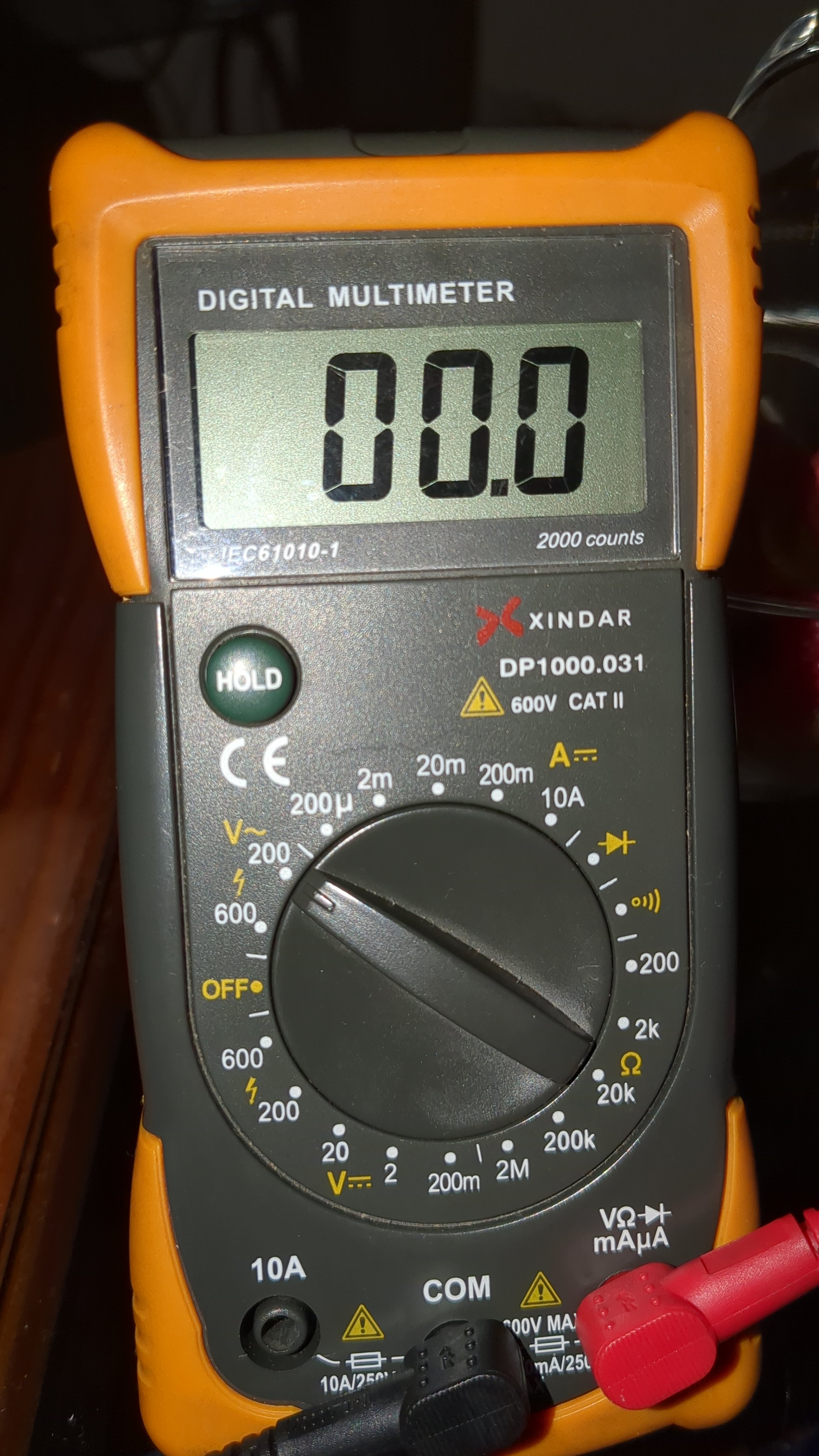

Hello guys..
Now I test the crankshaft sensor and I think its not good.
When I try generate voltage, it only gives me 0 volts, it doesn't generate 3/5 volts
Is this the right way to test it?
Thank you guys

5 hours ago, Joob said:
crankshaft sensor
Run a scan tool or just made an ECU reset, tampering with this may cause an error and the memory will "hold it" and the car will turn off suddenly.
The coil is fine
yes the ECU decides the opening for the starting sequence. it will automatically open the throttle as much as its needed while keeping all 4 injectors spraying fuel simultaneously
That doesn't sound right, first and foremost you don't touch the throttle yourself, let the ecu take control, secondly are you sure you are getting fuel?

I've always assumed that the ECU opens the throttle slightly on its own, but even if it did I didn't turn it on, and I've sprayed brake cleaner and nothing.
Hello guys..
Thank you guys
Is not possible from this ?

2 hours ago, Joob said:
Check the another video .. The crankshaft sensor is new but nothing dammm
Each video sounds like the starter has no load at all - which would suggest low or no compression. Did you set up valve clearance correctly after head gasket job?

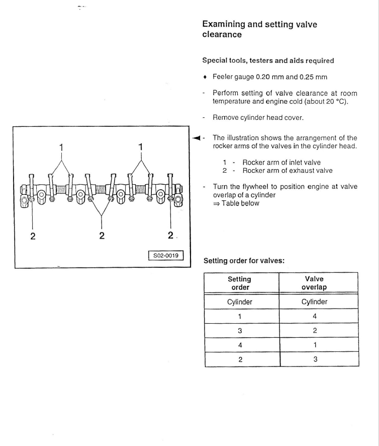

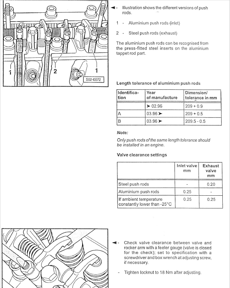

That could be the issue. Since it's a pushrod engine, any head-off procedure requires adjustment. Atleast twice, because the head gasket will squish a bit after a few heating cycles.
It's possible that the clearance was set too low and valves didn't close properly. That can result in heat damage.

Do you know the correct valve values?
Yap is cheap 20€ more or less

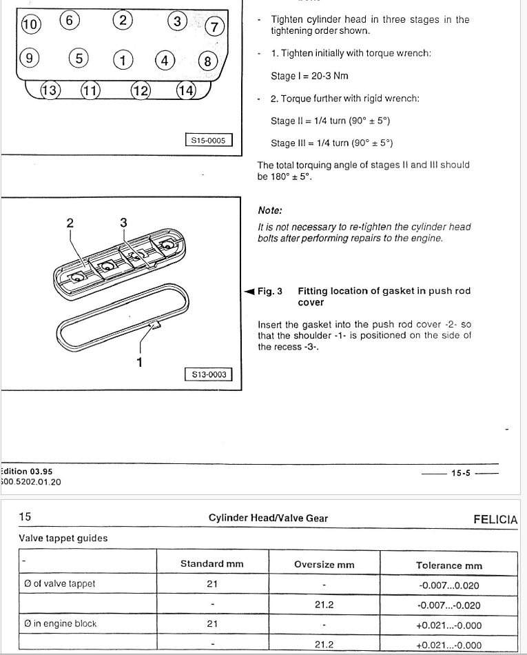

It should be around 1,1-1,2Mpa on a new engine, I found around 0.9Mpa for a worn engine, difference bellow 0.1MPa. 3bar (0.3MPa) is way too low. Rule out measurement error, otherwise it's really bad.
Edited by Papez
Thanks for the tip.
Can you give me a simple explanation of how to tune the valves?
Is it piston 1 with piston 4? etc. ?
