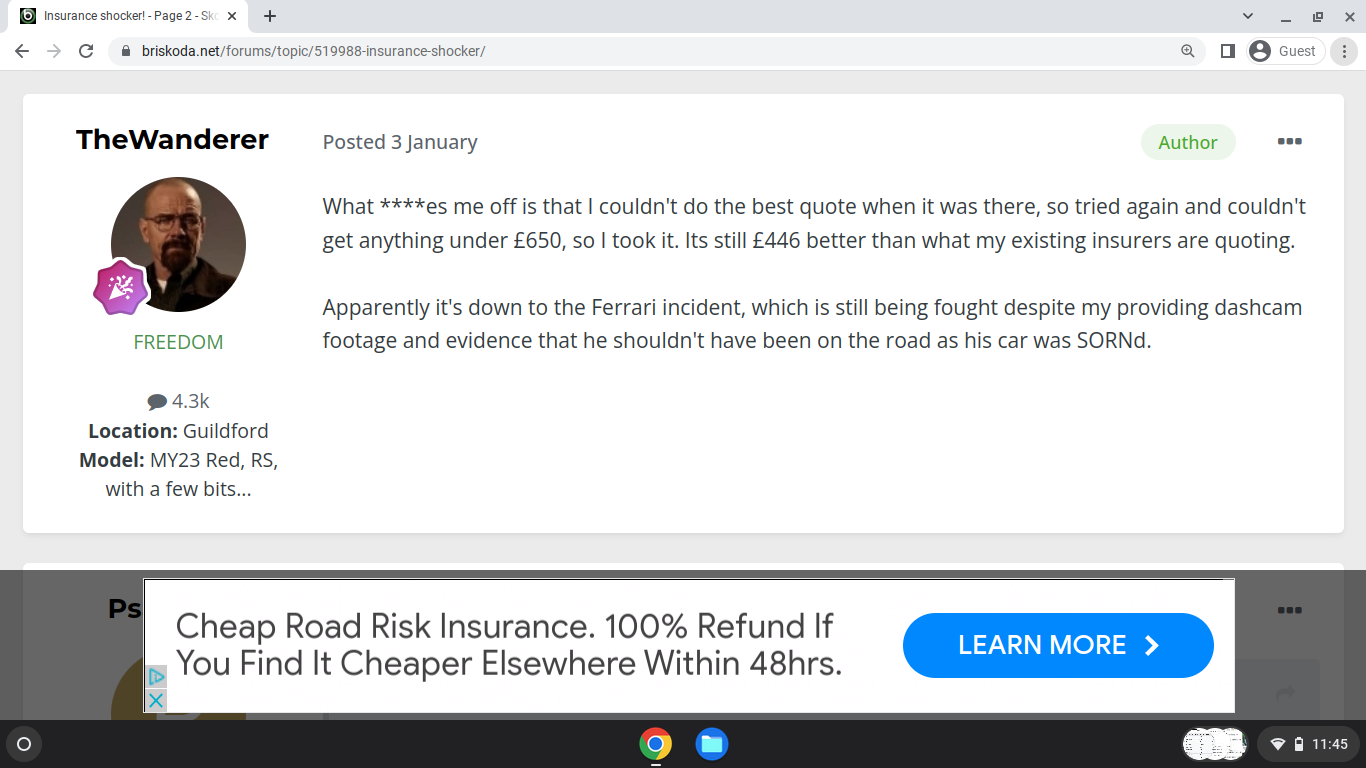

The Ferrari driver is to blame for overtaking when there was a Skoda wanting to do the same, or is it just the Repairer, it is not Skoda though.
Well the car released the parking brake yesterday whilst parked outside of the accountants office as well.
When it was home is sounded like the parking brake was applying & releasing, as well as similar to operating the gear switch!
Then showed 2 to say there were updates, the screen went blank, came back in Engineering mode where it offers you updates of software, FEC etc, I turned it off, it then showed me the Engineering Menu that's used for firmware updates and then went blank, it then went back to loading settings and telling me to enter my S-PIN next time the system starts!
