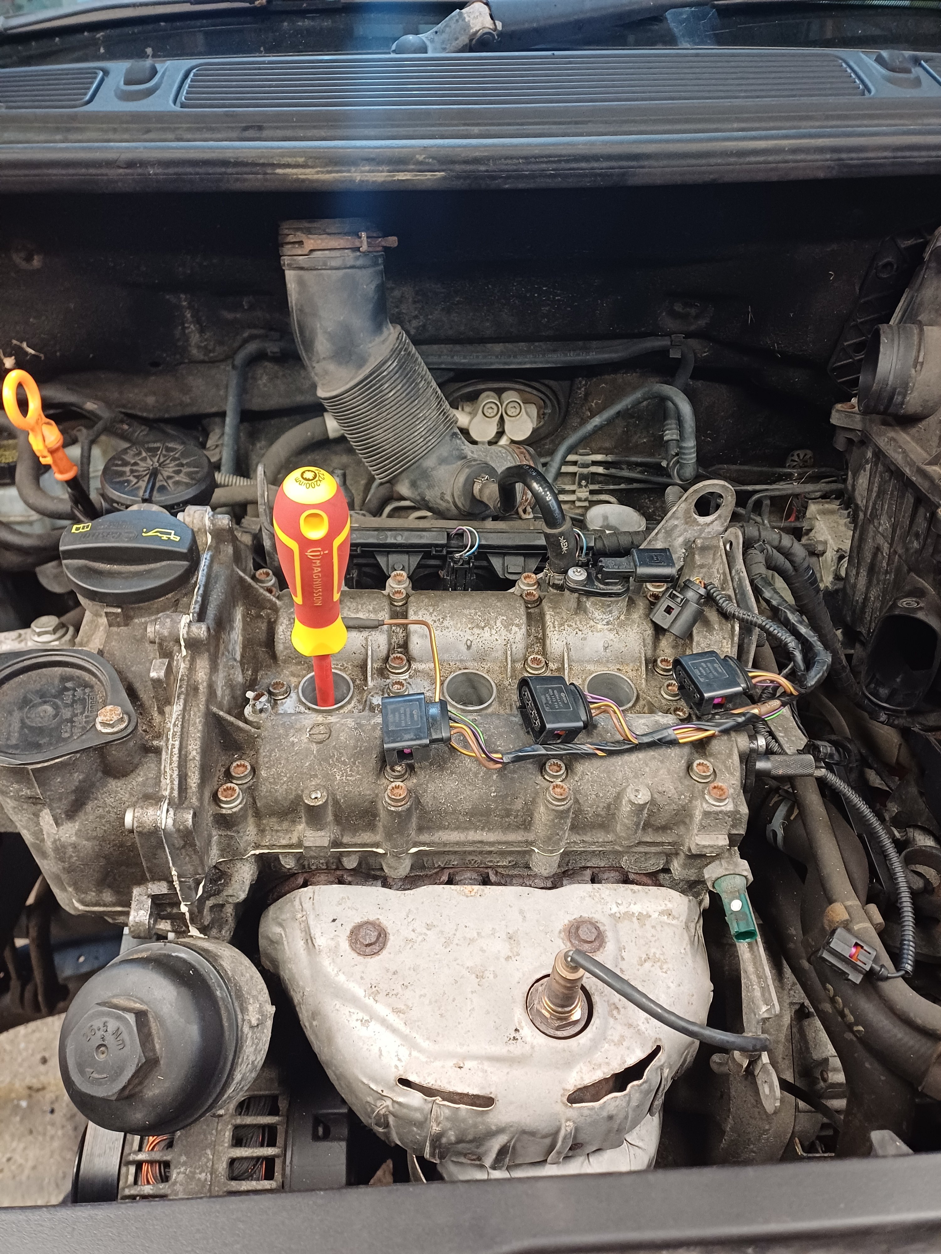

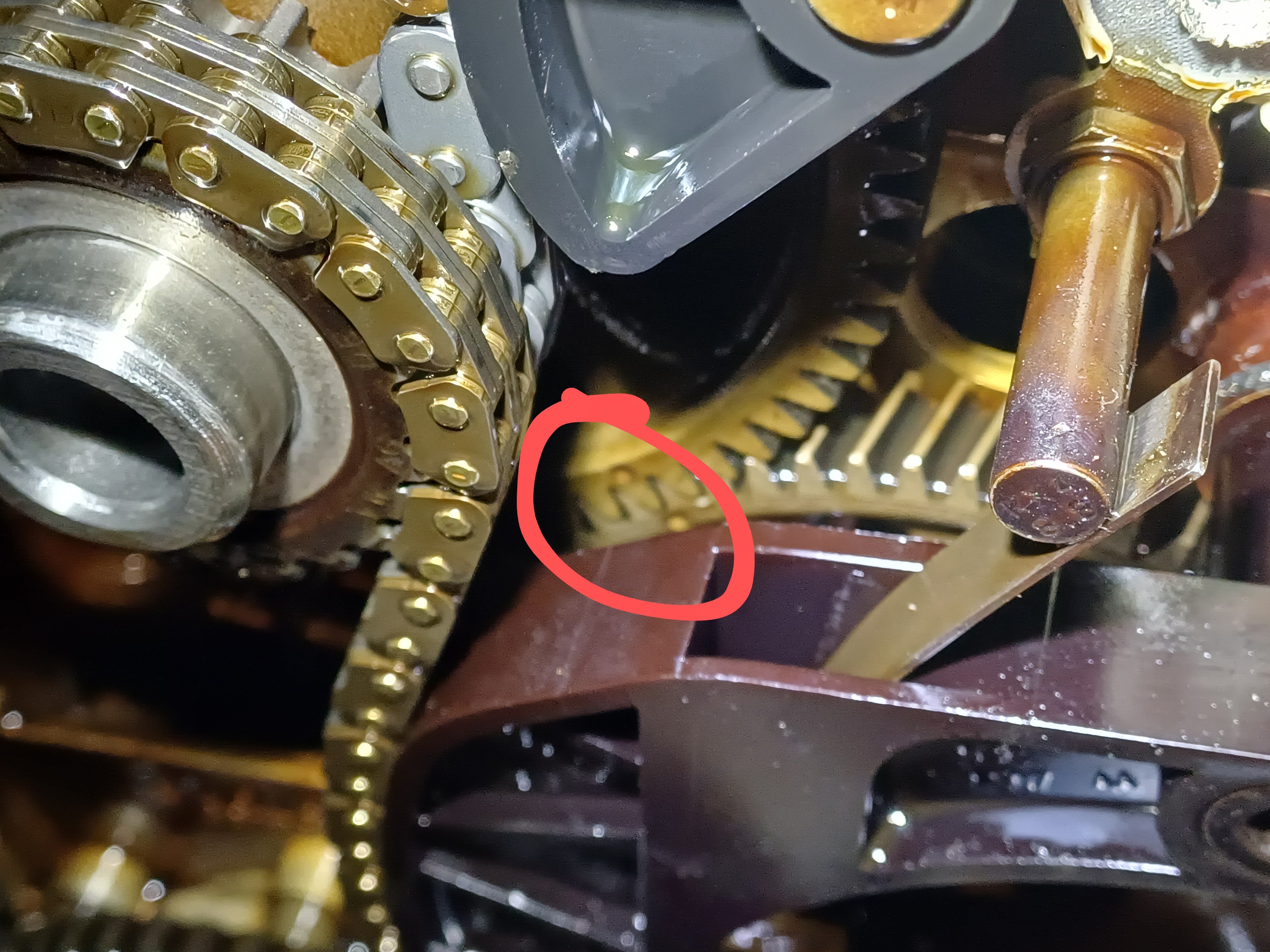

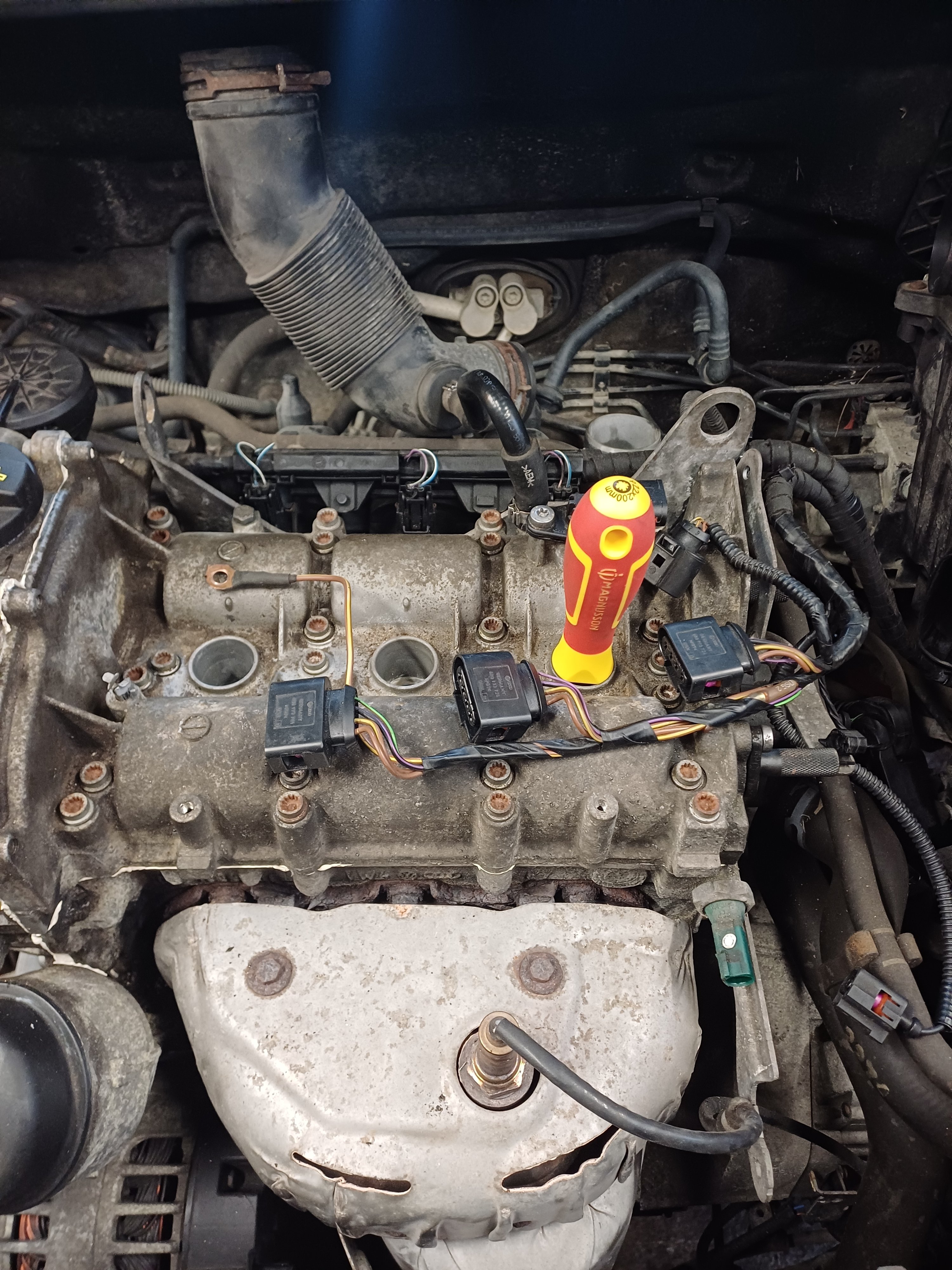

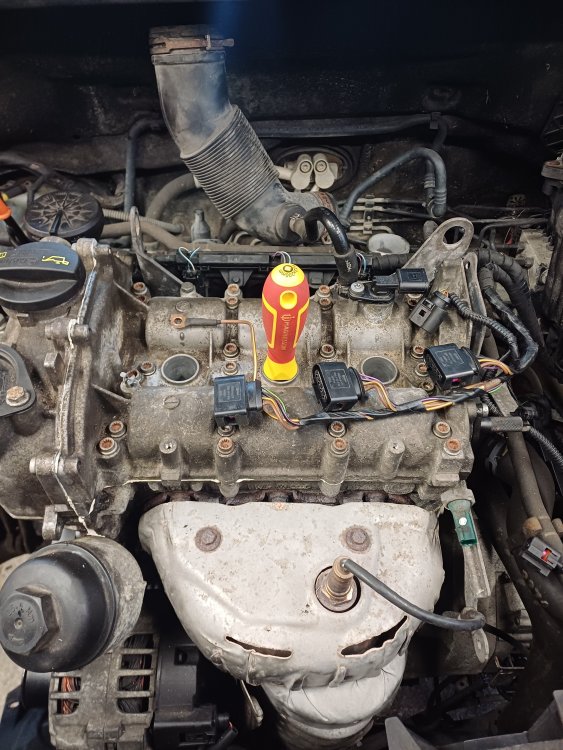

We watched some videos and thought the timing was out by 180°. I did some checking and didn't think it was the case as piston 1 was TDC when crank/cams had the locking pins installed. To further verify timing was correct i stripped all the parts off and removed timing cover to make sure the two dots on the cogs are lined up (picture with red circle).
