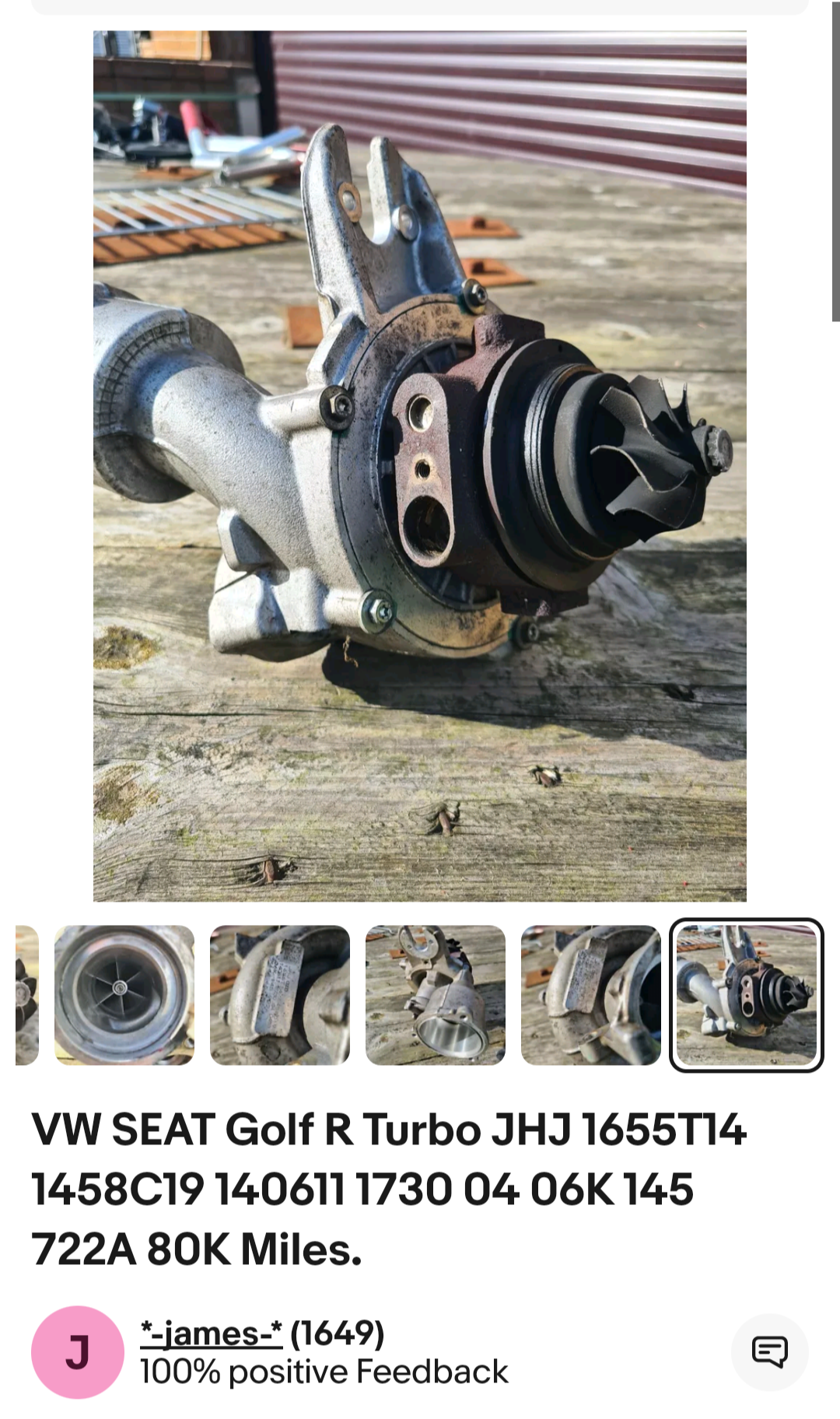

On the money again dude.. I bought one last night for £100. 06K 145 722A part number taken off a Golf R with 80k miles, so I'm feeling pretty confident it's the right one 🤞
Next research is who best to refurb it if needs be. The question is straight refurb or refurb with improvements 🤔

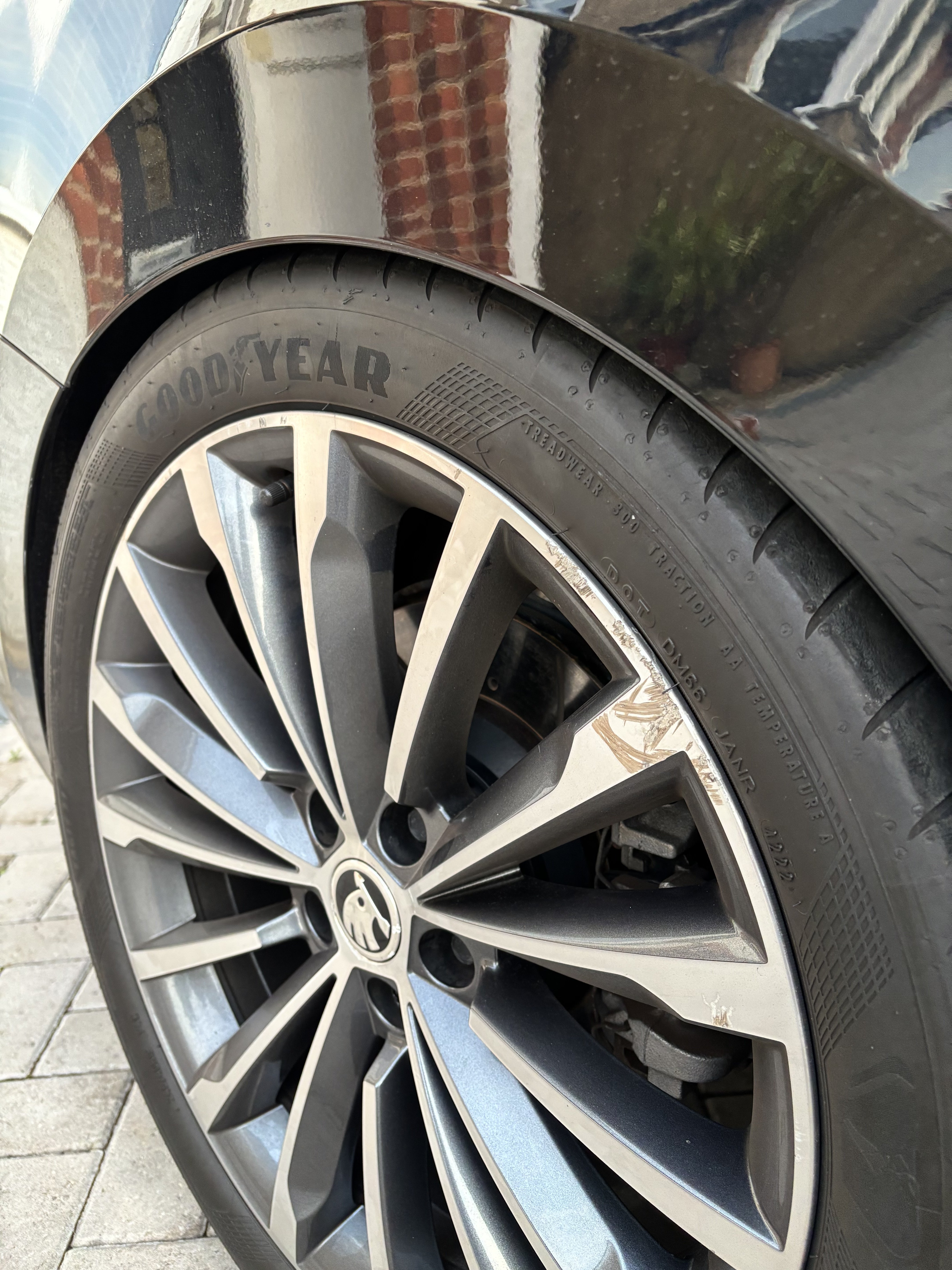

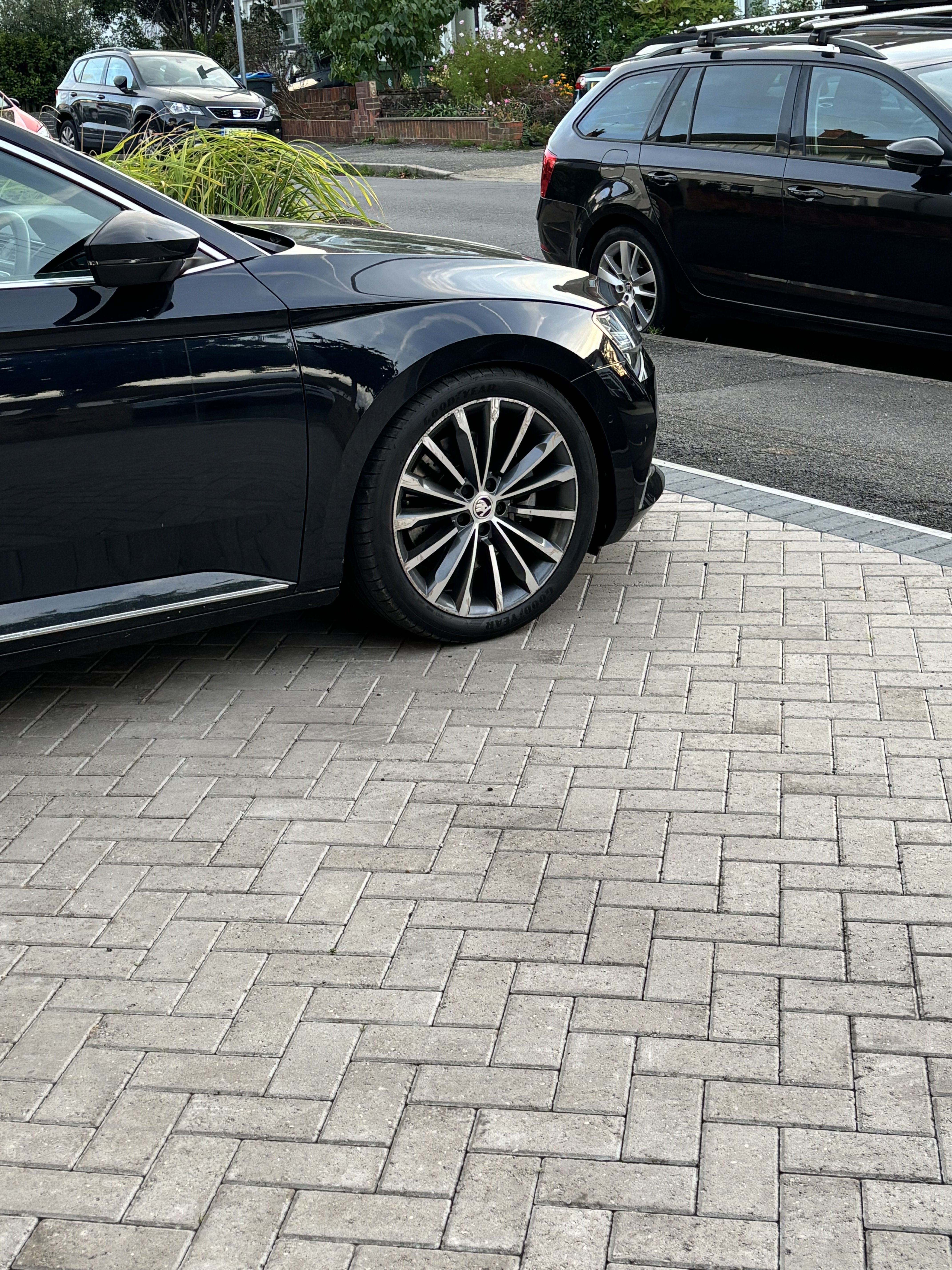

Arch gap crimes definitely needs to be sorted.
What's the proposed solution?
No parts for the time being. Need to get the DCC slider mod done first so I can use more than just Sport.
The classic is Eibach Pro Springs and Bilstein B6s or B8s for a slightly lower shock. The arch gaps definitely need closing so a lower stance will definitely happen.
Although the esteemed JRRS did say that the original shocks are designed to be better - something about number of valves. Either way, plenty of consensus about the B6s being decent.

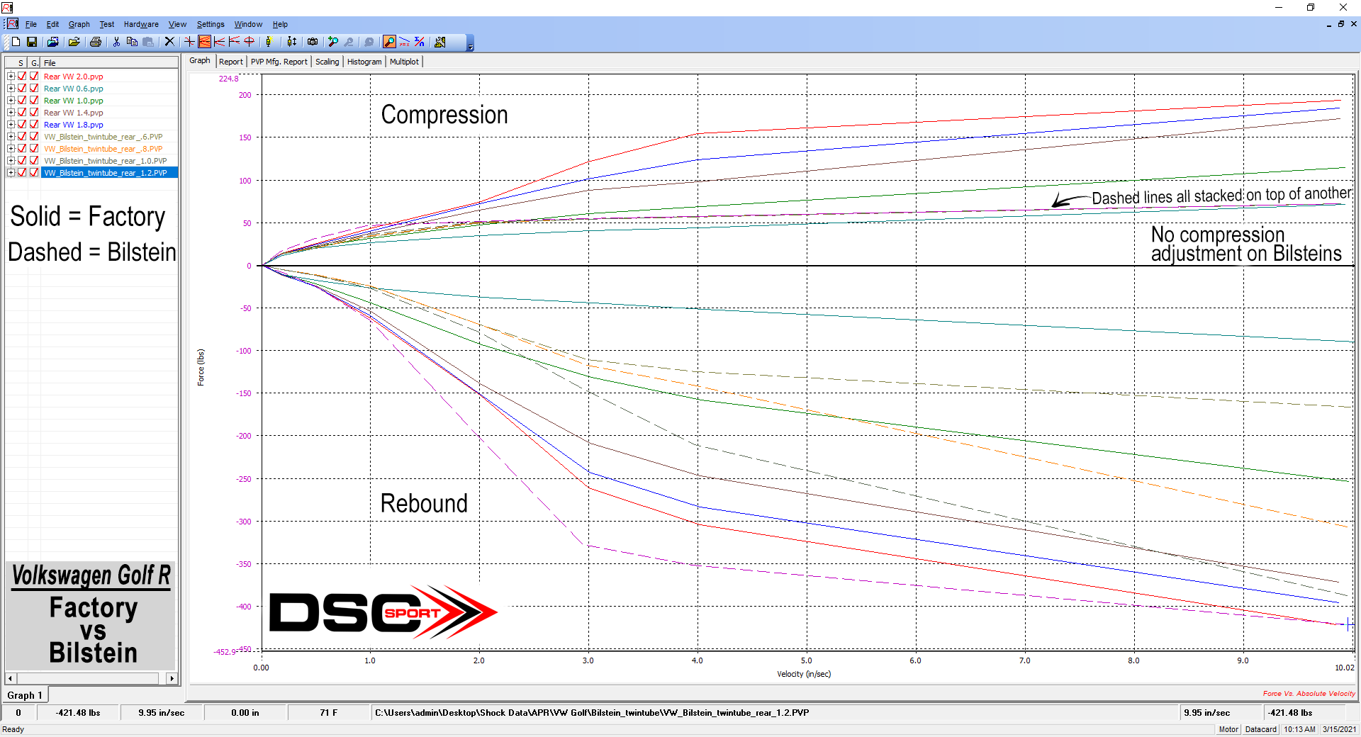

According to testing done by DSC Sport, the Bilstein Damptronics can only control rebound well.  It doesn't do compression well.
The factory DCC shocks can do both, and even exceptionally well with the DCC Slider Mod as it uses a much better algorithm to handle rebounds and compression.
Below is the finding from DSC Sport:-
"We had some pretty interesting findings today when shock dynoing the Bilstein Damptronic B16's for a MK7 Golf R (part number 49-255874). We found the Bilsteins only are able to control the rebound, while the factory shocks are able to control both compression and rebound with their valving.
This means the Bilstein Damptronics are a less capable setup when looking at compression adjustment, but still happen to have slightly greater rebound range. Basically the only benefits to the Damptronics are adjustable spring perches to change ride height and stiffer springs. But are not beneficial when looking at the "active" functionalities of the shock.
This is due to the valve used in this specific shock, however in other Bilstein kits we have tested, like the Porsche Kit, the valve is different and was able to control both rebound and compression."
That’s the stuff. And that’s B16s which are meant to be higher spec than B6? Better than B14 I think. So basically the adjustable features of the B16 are the only improvement over standard…

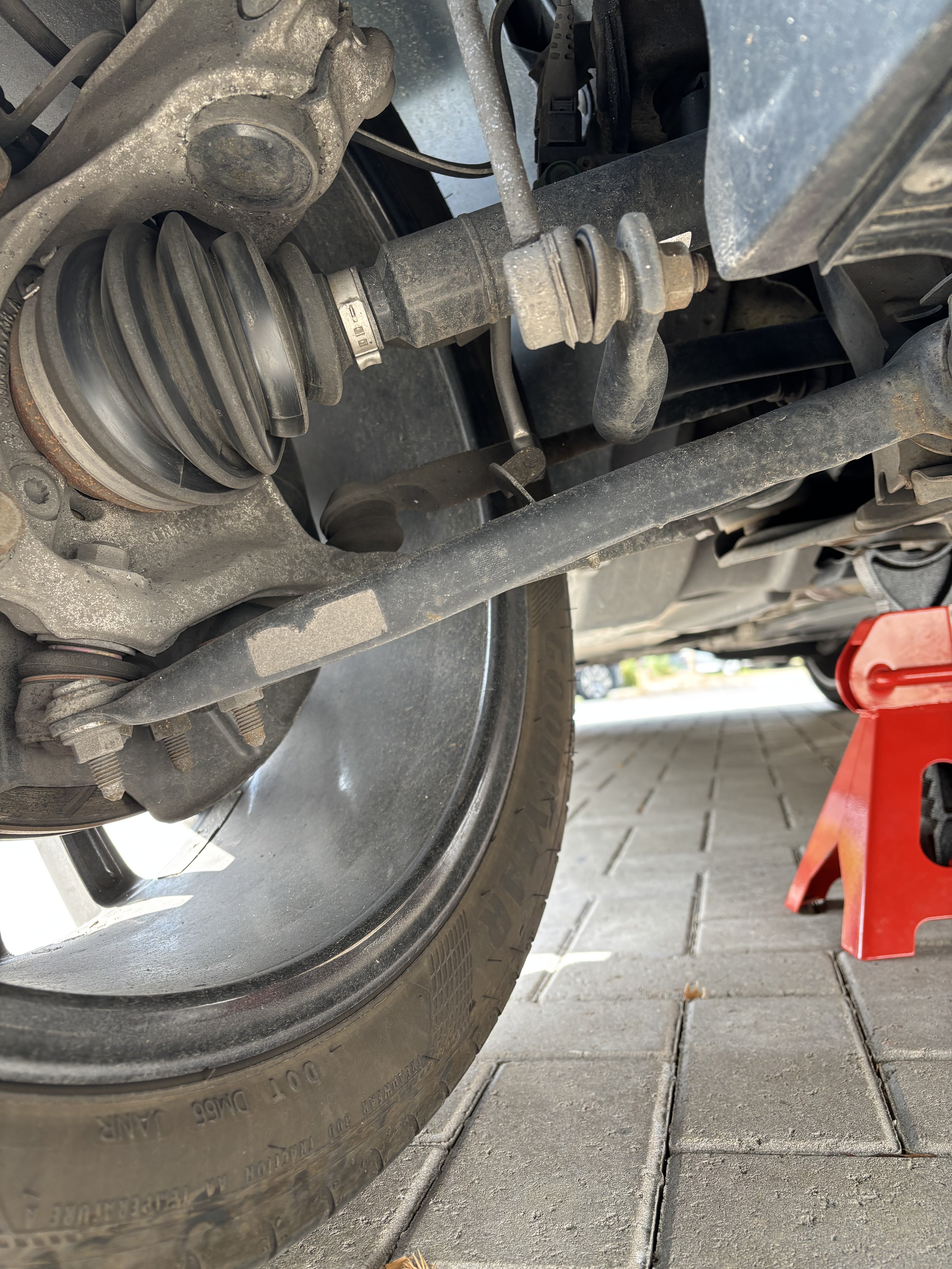

MOT this morning with ‘full’ dogbone and white line 25mm ARB fitting too. As long as the former isn’t so obviius the mrs thinks there’s something wrong with the car, fingers crossed it’ll feel a bit better and tighter

It applies to all Bilstein Damptronics range, apart from the Porsche versions, which I have not seen or read about in the past.
As for the new Gen2 DCC - it's a completely different setup, using 2x valves, unlike just the 1 valve with the current DCC.
Gen2 will require different wiring circuits, different modules altogether, different gateway, and have flow on effects to lighting, steering and ACC.
Not a retrofit for the mk3 Superb.

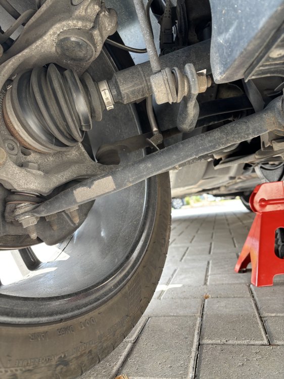

Whiteline ARB fitted. 25mm set to stiffest setting. Feels really good. Have done some fast flowing A roads punctuated by some roundabouts and feels much less dramatic if that makes sense.
Dogbone upper has gone in but the lower was the wrong part. AwesomeGTI are swapping the version over thankfully so will hopefully get that sorted this week with any luck.

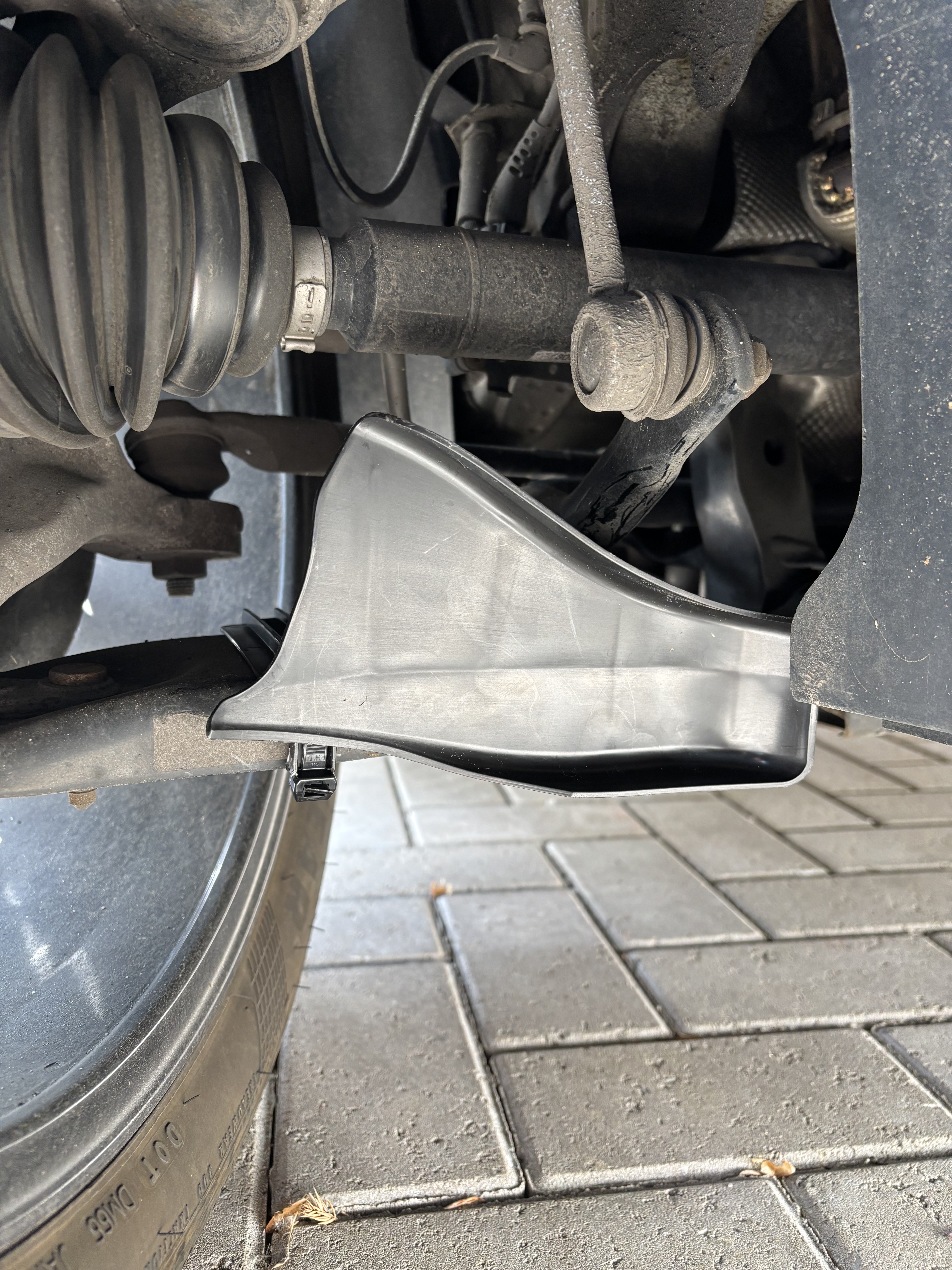

Most recent addition to mine is the RS3 brake ducts. Developed by Audi Sport they sit on the lower arms and feed air on the back of the disc to help cooling. Whilst I don’t always do any heavy or repeated braking I do have stints braking down from dual carriageway speeds to a roundabout with the car loaded up and the aim is these will help to keep the disc from not hitting too high a temp.

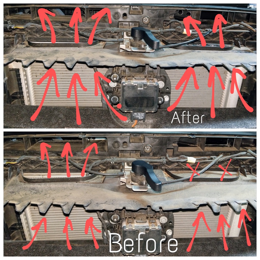

Also had the front trim panel cut out so airflow was better into the car (although looks like I’ve taken a pic of the wrong side 🤦🏻‍♂️). But both sides are now completely open. Again, the guy wanted to do a proper job rather than drill some large holes so he got a saw out and cut it completely open. He was really finicky about doing everything absolutely right.
That was one of the first things I did many many years ago - opened up the blocked second air intake opening behind the grille.
Many people would think opening up blocked bit on the top of the air intake was sufficient, or getting an aftermarket air-intake with both inlets open would do the trick - but both would yield no gains on the Superb unless the blocked air intake behind the grille was opened up.
