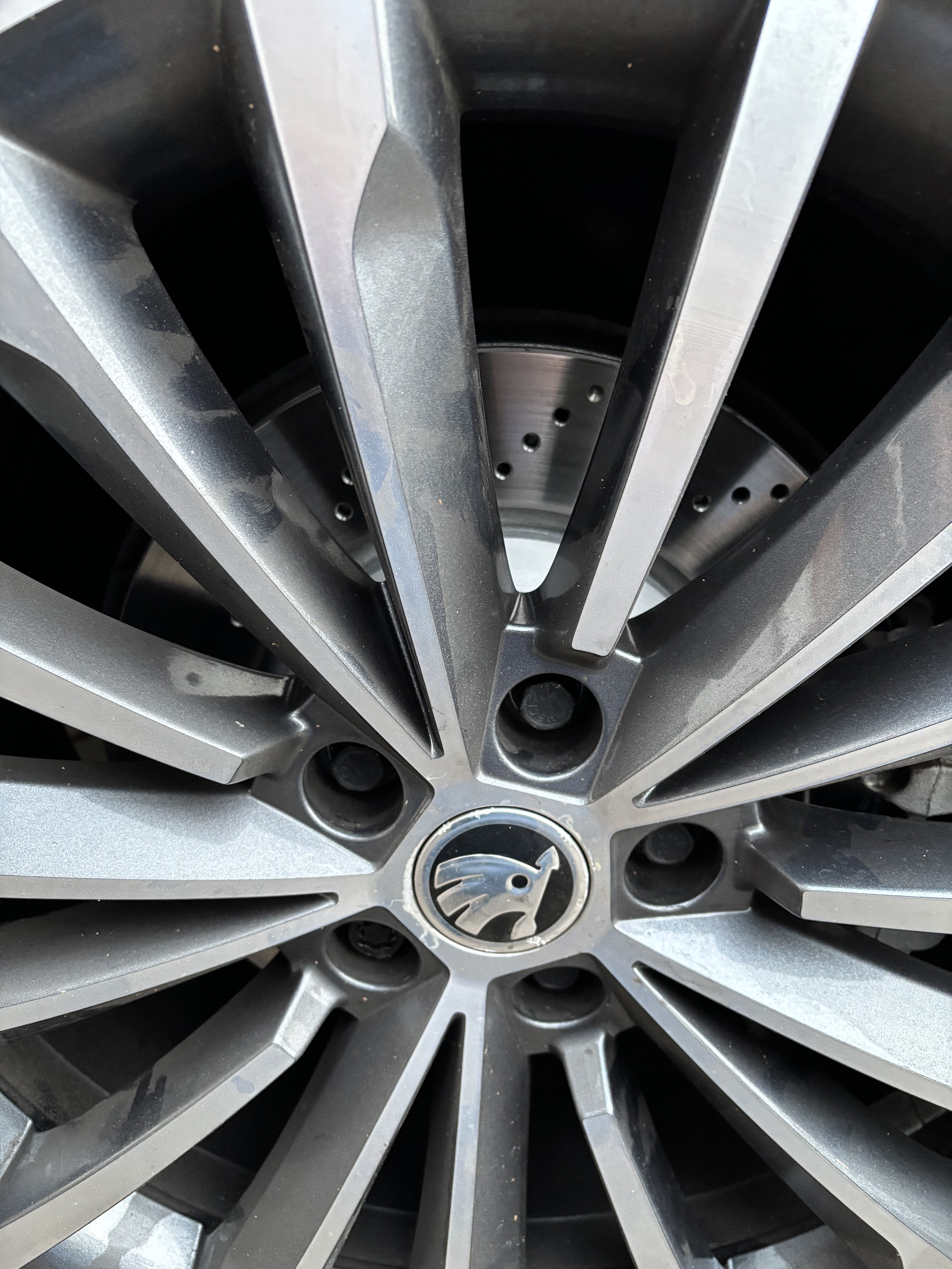

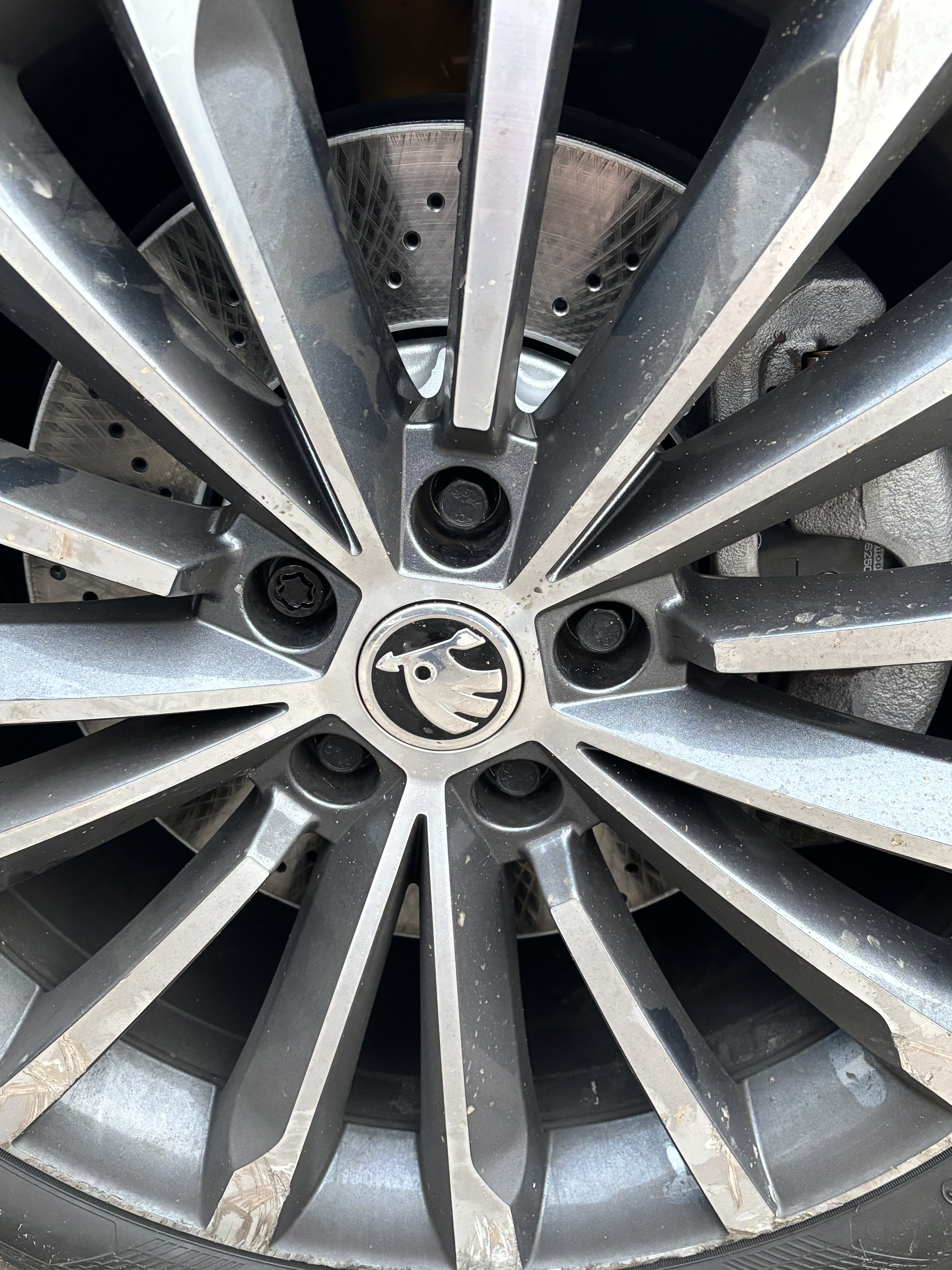

Brakes replaced. The Mtec/ATE stuff was ok but I definitely felt like I was pressing harder on the pedal when having to haul the speed off when loaded up.
Still just finishing bedding in so haven’t used these in anger yet but they look decent and I’m enjoying the lack of groove/noise. Getting old.
Front - Golf CS reps made by SHW performance.
Rear - VBT CS lookalikes to match.
Pads are Ferodo DS2500 all round
