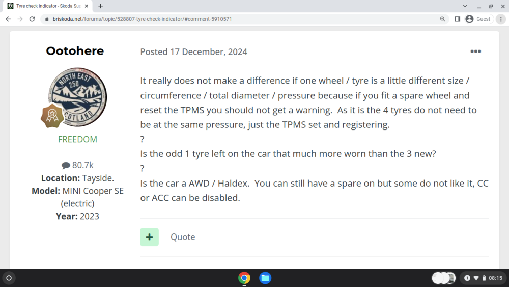

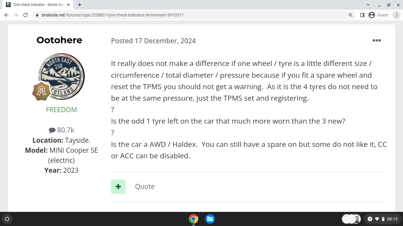

It really does not make a difference if one wheel / tyre is a little different size / circumference / total diameter / pressure because if you fit a spare wheel and reset the TPMS you should not get a warning.  As it is the 4 tyres do not need to be at the same pressure, just the TPMS set and registering.
Is the odd 1 tyre left on the car that much more worn than the 3 new?
Is the car a AWD / Haldex.  You can still have a spare on but some do not like it, CC or ACC can be disabled.

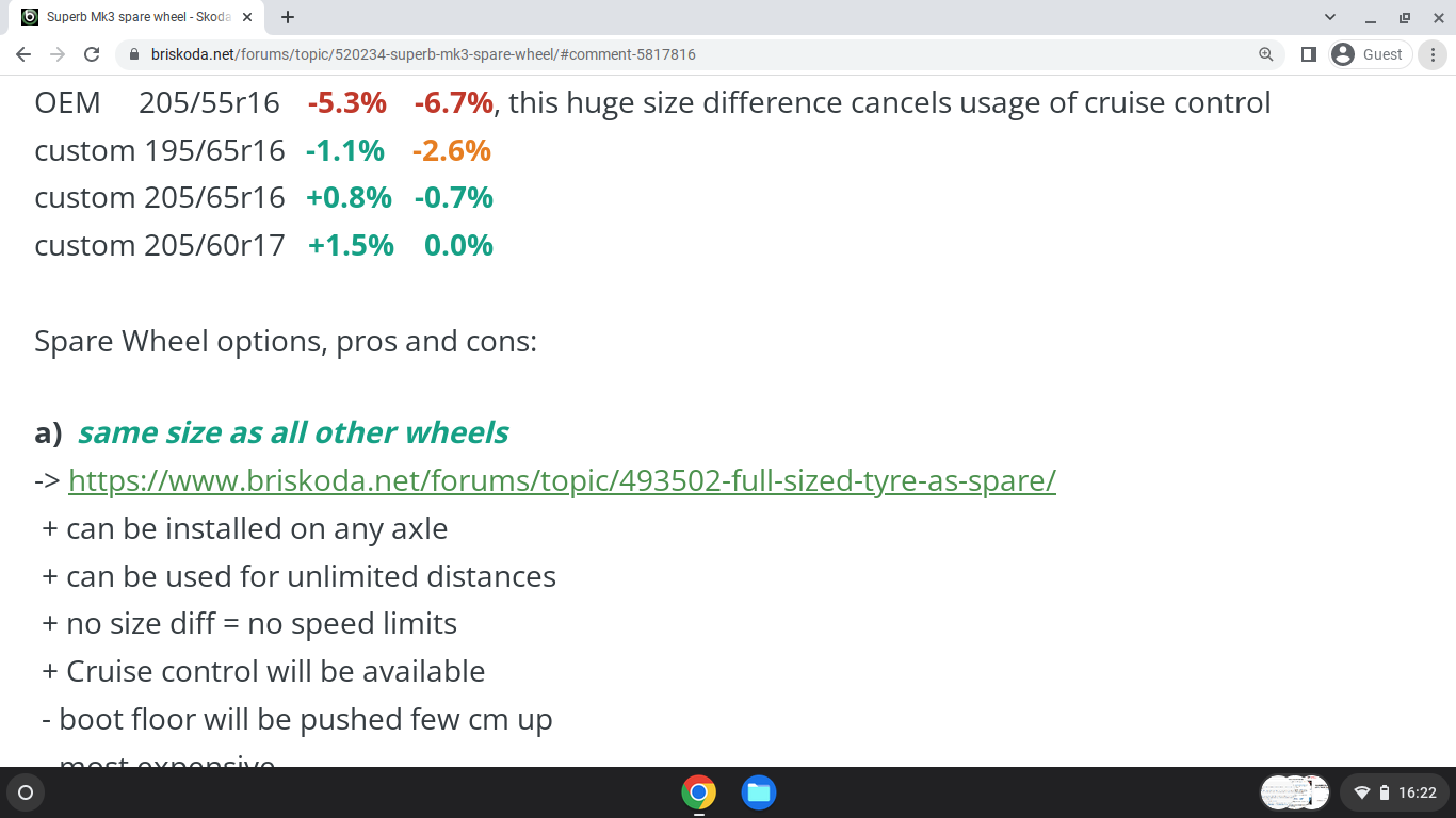

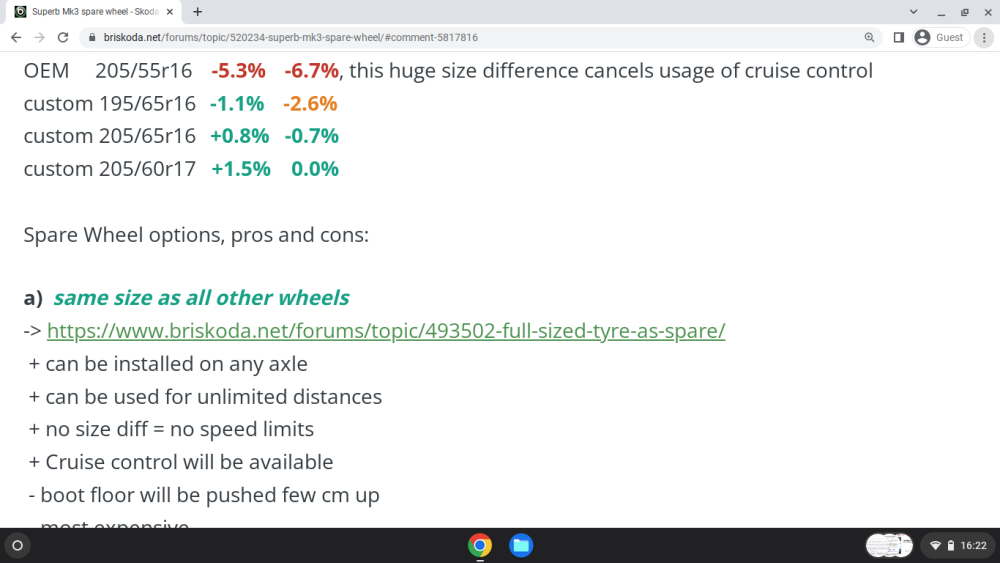

A big difference in the Circumference / total diameter. % as you show...

@Ootohere - with a spare tyre on, even after resetting the TPMS, the car still knows u have a spare tyre on because of the difference in rotational speed, and hence it disables the ACC.  Reason for this is because ACC automatically applies the brakes to manage the speed, and since the ABS sensor knows about the spare tyre - it can't "safely" regulate the stopping power for ACC.
I've personally experienced this with my Superb, when I had the spare tyre on - it would not allow me to use ACC until a full-size tyre was back on.
