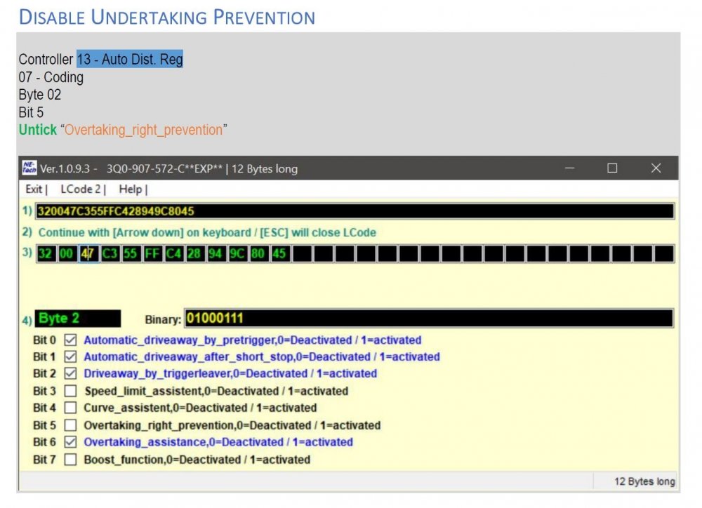

U can disable the "under taking prevention" using OBDEleven or VCDS.
Coding below.
Under taking prevention is known to b trigger happy by slamming on the brakes when a car slows down to turn left in the adjacent left lane (for LHD) or when turning right in the adjacent right lane (for RHD).
Very annoying, and yes, can b dangerous if someone rear ends u.
Disabling it will not cause it to slam on the brakes.
Edited by JR RS

Wait, I think the topic is mixing more factors, and it would be good to split them apart.
One thing is the fact that out could happen that the system, in our view, "overreacts" because of liability compromises of the manufacturer. It cannot be overriden, and it cannot be disabled or eliminated. We just need to "adapt" to it .... If someone does not want it, then must buy a different car that either A does NOT have such assist systems or B a different manufacturer with a criterion more adequate to a particular diving style. I have in my stable vehicles far less efficient in overall braking scheme than the Superb, and everything has its pluses and minuses.
This said, what JR suggests above is gold - it was one of the first things I've done, remove the undertaking prevention, because even without it there is sufficient margin to drive within normal limits. Another thing was to disable "prediction speed limitation" which in my FL has removed the bothering "bend ahead" braking. True this works only with ACC/PCC on, but nevertheless... I did the same adjusting all parameters to "minimal/aggressive" and the car is not invasive in its assistance.
