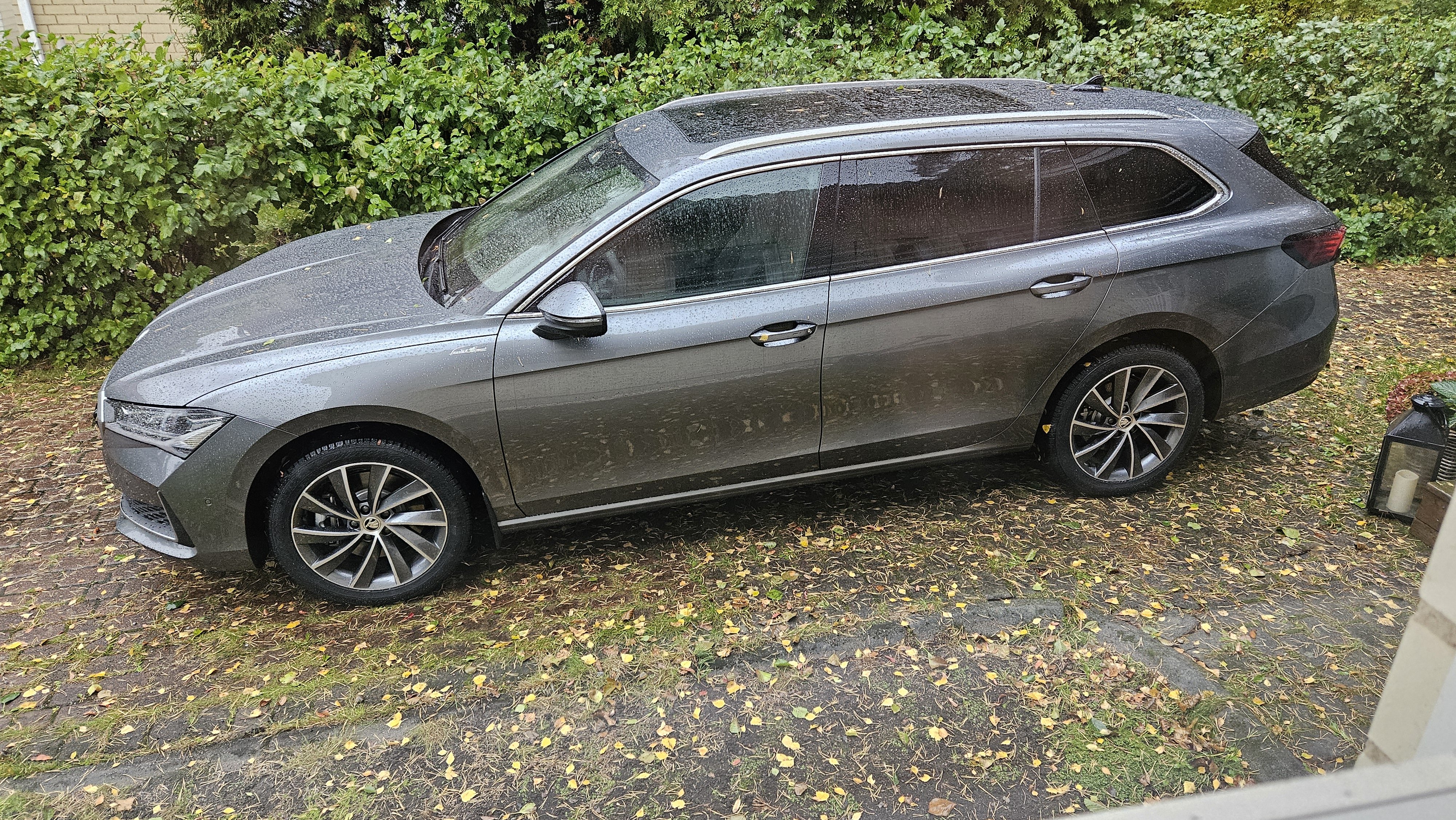

I dont know the weight or quality difference but i think it also on your color of choice. i think these are the belatrix although they look different from the sales pix. for me they are perfect with my car and color⁸
Thank you for the reply, the color+wheels combination looks amazing!
This is basically the same option I was planning to choose, the graphite grey plus Belatrix (18''), or in your case Veritate (19'').
