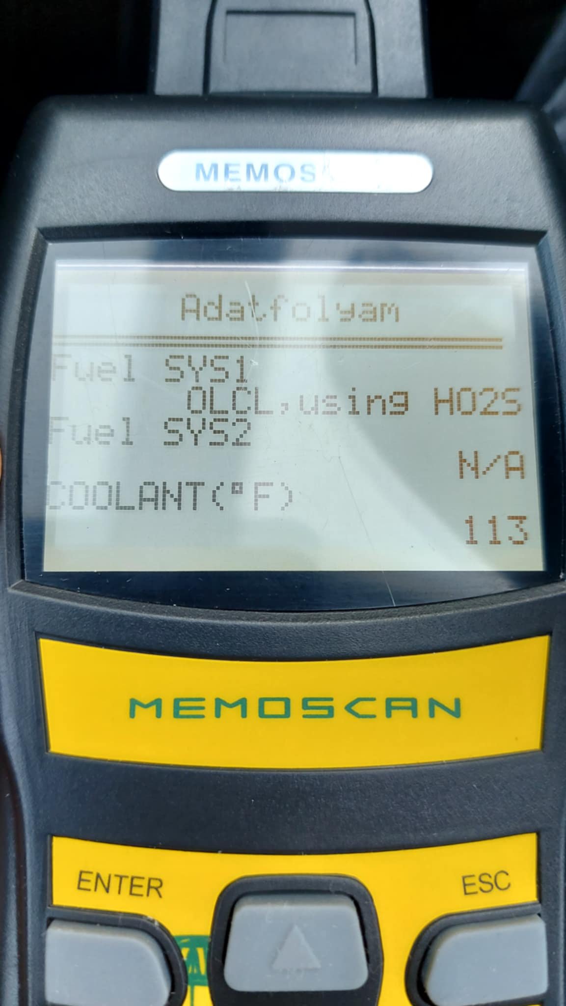

Well, I went over to a mechanic friend of mine today. It is certain that the thermostat is not open, it is certain that the engine would heat up as it should, but for some reason it cannot. It was specifically read with a VW group OBD reader. The inlet coolant temperature is 45 degrees Celsius, the outlet coolant temperature is 5 degrees Celsius. The car had already traveled 30 km. His tip is that there might be something with the auxiliary pump. My car was a police car and it has a Webasto heater. The cooling water is also circulated in this system. Could these be related? I am attaching some pictures of this Webasto.
UPDATE!

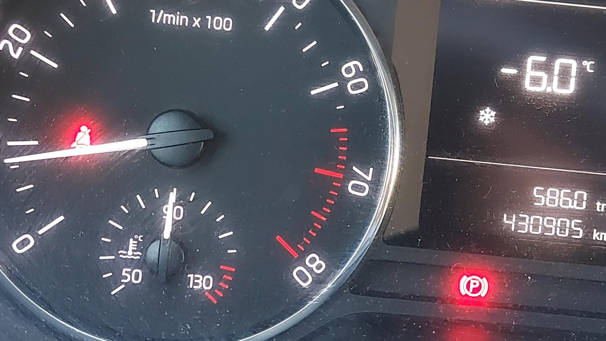

This morning, after driving about 5 km, the water temperature started to rise and did not drop. It stopped at 90 degrees and stayed that way, neither going up nor down. The outside temperature is between -6 and -8 degrees. After I arrived at work, I opened the hood. The fan was spinning at maximum. I was able to touch the pipes again without any problems, but I don't know how hot it should be now. I plugged in the older OBD reader I had and it again read the water temperature around 50 degrees. I don't know exactly where it read this temperature from then. The car had a transmission repair not long ago. Before that, it threw the START-STOP ERROR, but after the transmission was replaced, it was fixed and working. This morning, it threw this error again. I thought it had something to do with the transmission, but it's suspicious that these two things happened at the same time. Now I really don't understand what's happening... 🤣
Certainly interesting. I believe that the temperature that is shown with the gauge is read from the cylinder head. If your tool reads the outlet from the radiator it would make sense in this case. However it would not make sense with the earlier readings if the thermostat was closed.

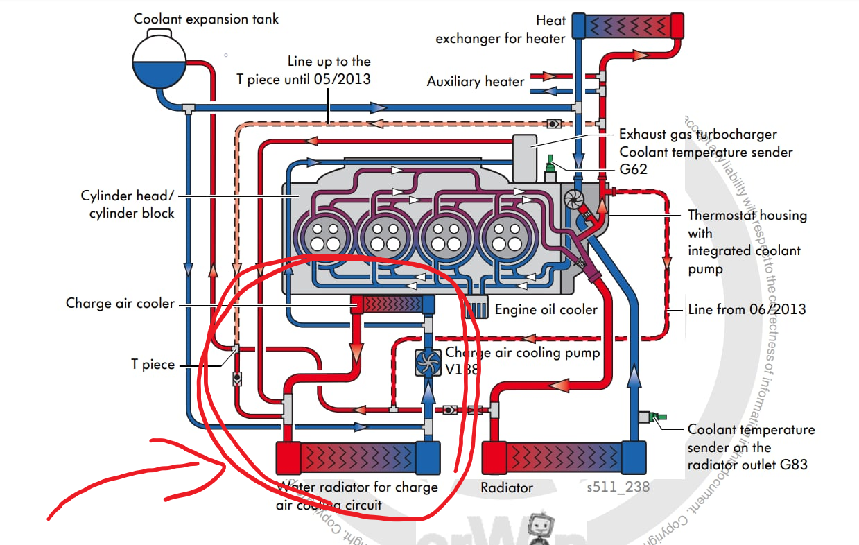

I believe you have another coolant circulation for the charge air cooler + exhaust around turbo. This circuit has its own electrical coolant pump that should run on demand. Theoretically if it runs all the time it would cause excessive cooling, but I think it is isolated from the main coolant circulation so should not cause your problems. But i guess it could be possible if the isolation is also failed. You friends VCDS/ODIS whatever VAG tool could be used to see if the pump is running even when the car is cold.

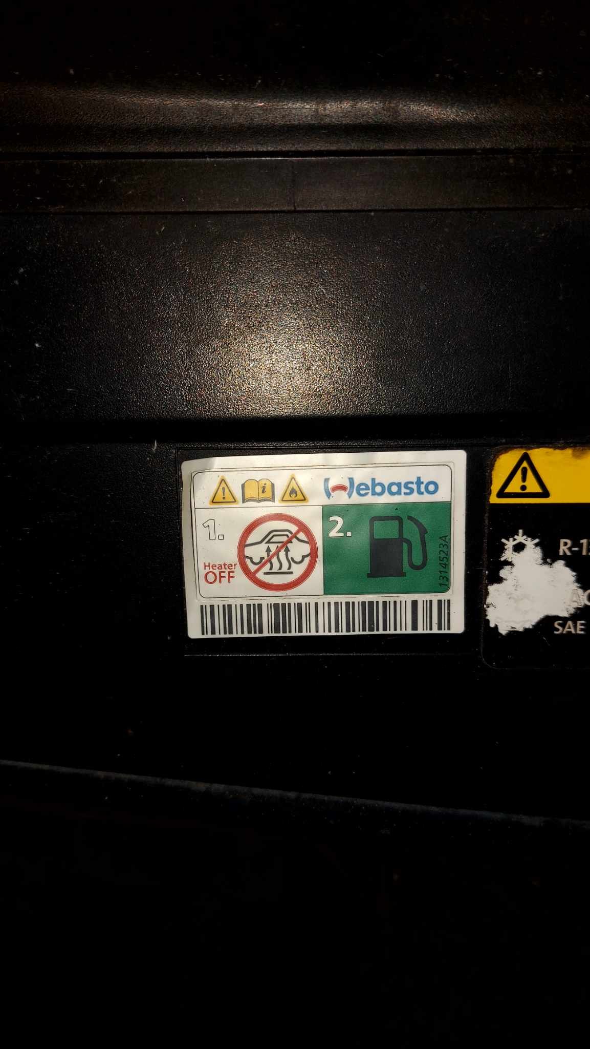

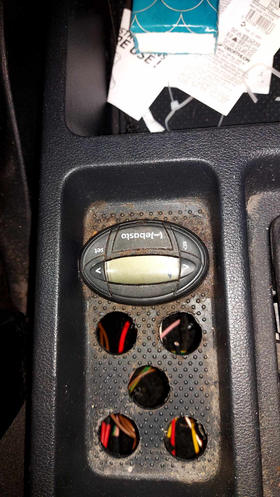

The webasto. Well it should not cause cooling but theoretically if there is multiple problems with it, it could be cooling the coolant to some extent but i dont believe it. The unlikely scenario would be that it runs automatically everytime you start driving and the system works even tho there is no flame in webasto (should not work then), meaning the webasto water pump runs and the combustion air blower blows cold air into the combustion chamber, making it basically a cooler instead of heater. However now that I think it, it would not have enough cooling power to cause your problem even in this case...
Well okay your webasto is installed by a third party so in case it is installed somehow wrong (wrong pipes or something) then maybe it could related. Have you used the webasto? Does it work?
I still see most likely reason to be one of the two thermostats being faulty somehow. Or the charge air cooling circuit running all the time and being connected to main circuit.

This Webasto heater was probably installed by a 3rd party. It has a monochrome display. I tried to adjust it, but it didn't do anything, there was no sound. I'm trying to disconnect it from the system because I don't need it.

Anyway, first, I'll try disconnecting the entire Webasto system to see if that's the problem.

Might be possible that cold enough weather has not triggered the charge air circuit pump and thus it is not cooling now. Yet I feel the cause is more likely one of the two thermostats at the water pump. But I follow with interest what the outcome will be. Surely this will get sorted out eventually :)
I will also be very surprised if the webasto system is the cause. If installed correctly I can not believe it would cool the engine so much even by the very unlikely theory I presented. How you plan to disconnect it? Unplug power to its pump and blower? That should disable the possibility of it causing the cooling. Total removal includes water and fuel lines etc.

If the charge air circuit pump remains as a suspect, perhaps some circut diagrams could reveal what possible sensor may trigger it to run (outside temp, intake air temp, etc.) and then I would try to see if any of those temperature sensor give unplausible readings (a proper scan tool would be needed).
Or as more straight forward option perhaps just check all temperature sender readings anyway if you get a change to use such scan tool.

Question. Can this area cause overcooling?
I would not think that to be likely.

Can you unplug the charge air coolant pump and see if it changes the results.
I would think it could potentially cause excessive cooling...but not sure how much the effect on the engine temp would be as the thermostat should control the engine temp still.
