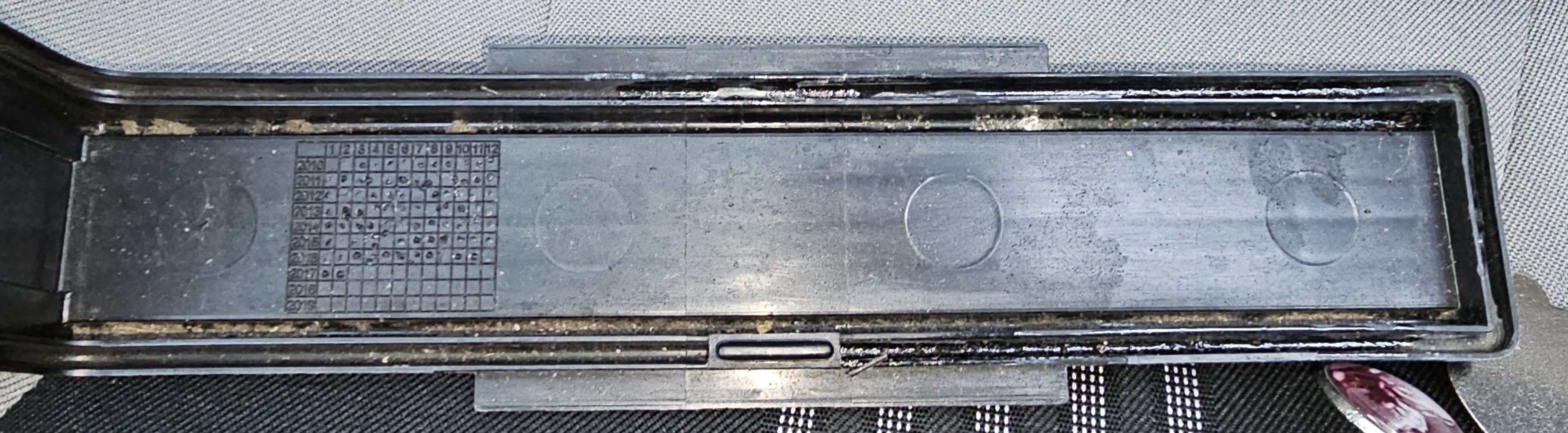

I removed the cover although weirdly it felt like it might of been glued on as it wasn't easy to pull off, the other thing that seems unusual is there is.... felt or isolation next to it. It doesn't feel like it should be there, although I don't know as it could be something that is supposed to be there. I've never owned this car or any skoda that is.

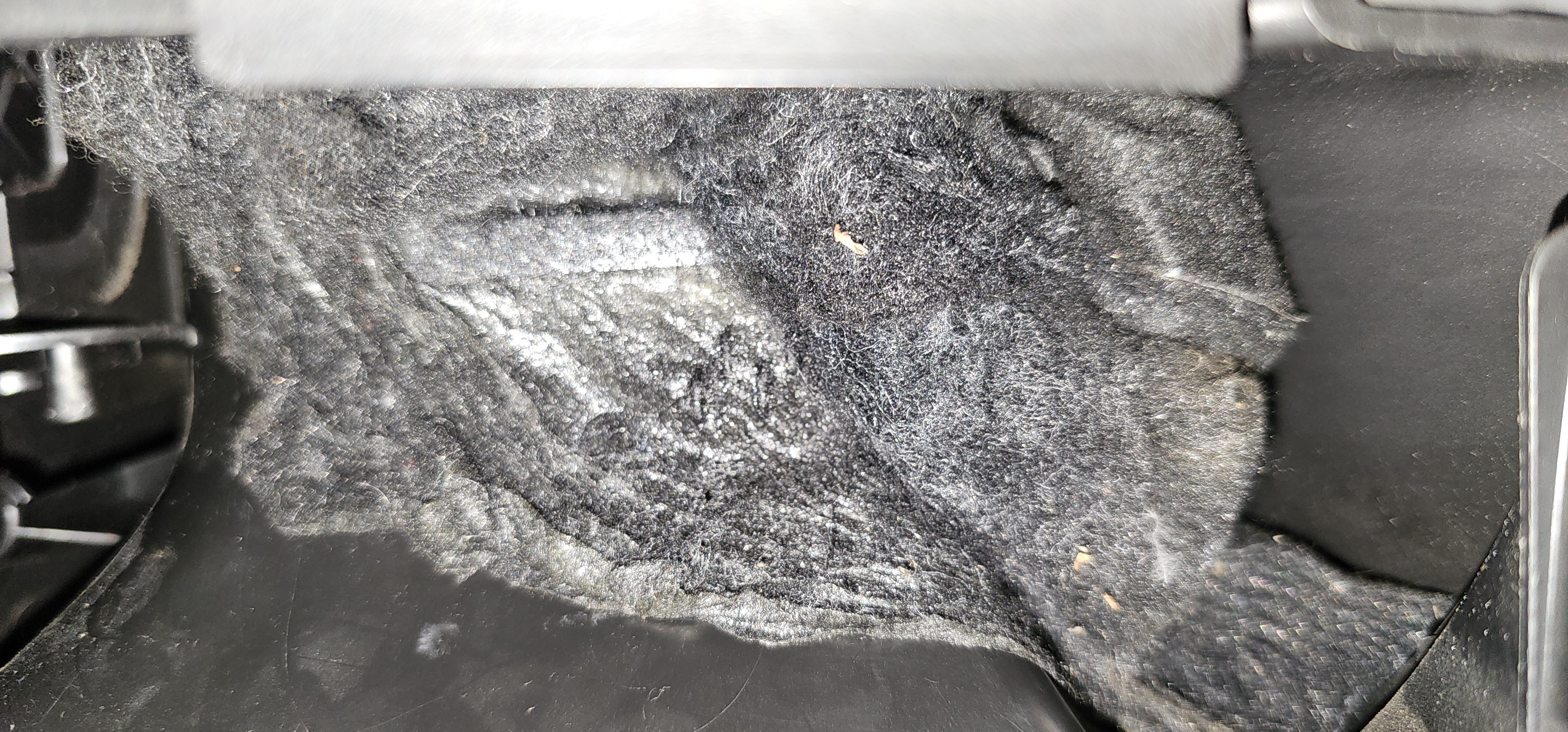

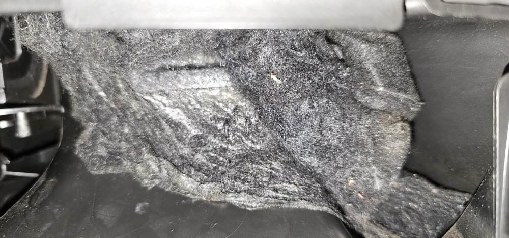

I've uploaded two photos one of the inside of the pollen filter cover, the other of the what I think is unusal insulation to the pollen filter.
First photo is a bit too close up for me but the hidden bits on the car like that can look like a little child has been given the job of making them and putting them there but I suppose if they do their job and aren't seen does it really matter.
The cabin air filter cover might just be gunked up with muck/fluff/bits I'd scrape that stuff out, perhaps the filter was never changed ("service" "maintenance" history should say if it has at least been claimed to have been done).  The box with dots in it I think will show when the cover was made, it's not unknown for cars within the English motor trade to have parts from other car stock rather than original, not that it should matter on a part like that, assuming it's a correct part, best never to assume, particularly with the English motor trade, but to check.

Sorry about the first photo being to close, I cropped it as I can only upload photos up to 10mb.
The cover fits and holds. Although it doesn't have any catches, from what I've seen there should be one either side that you can slide together to lock and unlock. This just slots in and stays but I'll see if it drops out from the weight of the pollen filter, I'll have to get back to you about if it's an official part or not
I think that you can buy the 2 “slider” locking parts as a spares kit, I’ll check later.

No problem, see if the following can help, I reduced the size of the image or perhaps you can reduce it in camera's setting before taking the photos, having hi-res images is good for close up zooming but you don't always so much detail as 10mb or a lot less.
I have also cropped the photo and added circles before rum4mo posted and said about your missing catches, good job the muck was holding it up.
Orange circle is for what I guess to be some sort of locating slot I've never noticed before.
ETA: the following is for example, I've no idea if it's correct for Fabia let alone your model and year and its quality. - https://www.ebay.co.uk/itm/305569797544
Yup, I've just checked the spares, you can only buy the cover + 2 clips, a spares item common across the VW Group marques for this size/age of car.
Part shows 2 /2017 in the dots, a locating raised part and the wings that keep the clamping clips with the cover, or should do.

Thanks very much for that, I'll have to get a new pollen filter and see what happens as it seems to hold weirdly. As for the tyre, it's pretty bad

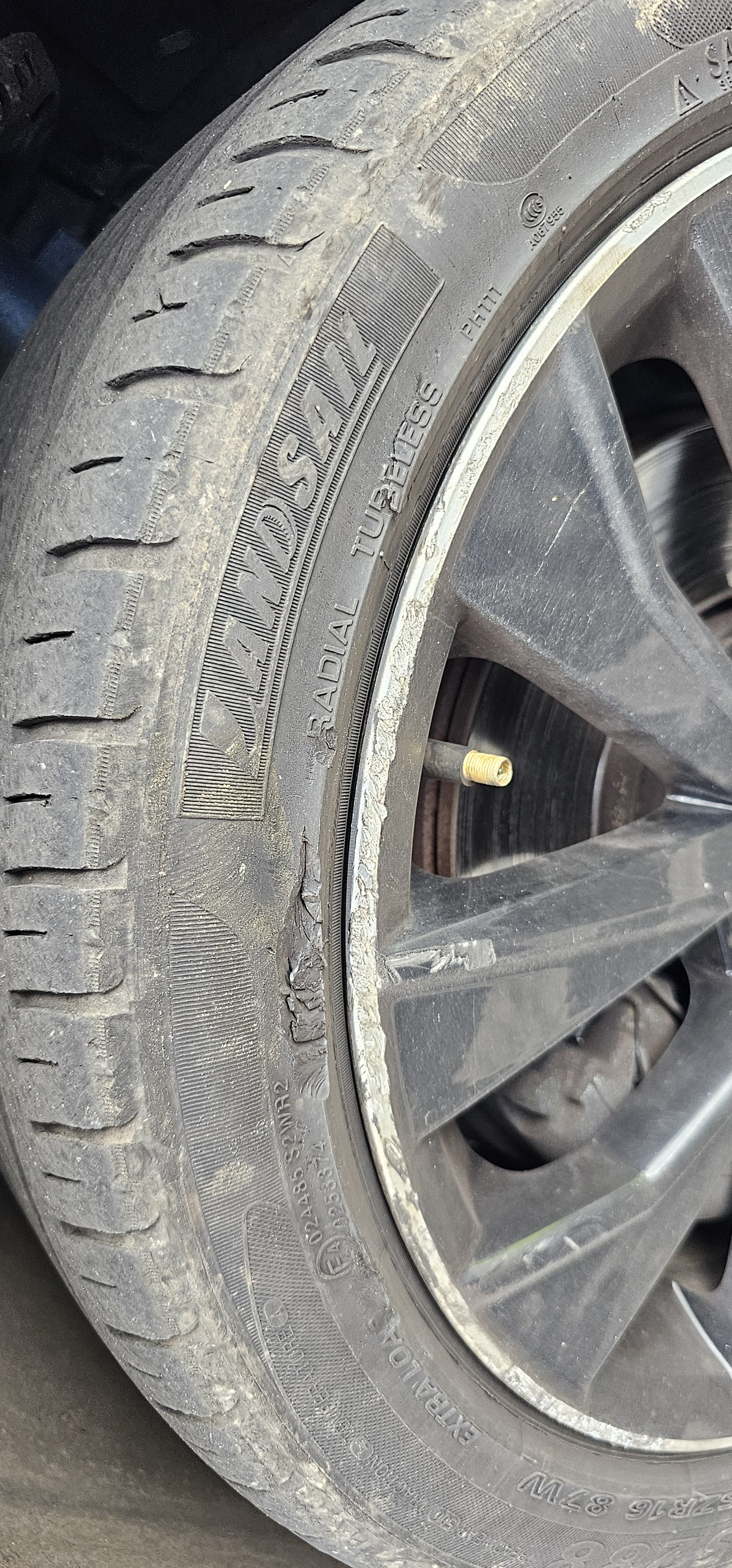

Any chords showing?
No dust cap!
Is the photo the right way up?
It has cut the rim protector!
