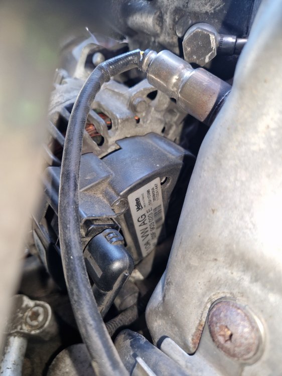

The battery/charge warning light should by governd by the BMS. Thing is, our car was severely underperforming and leave the battery at 11.4V which way too, however the car never made any notice.
When I changed the alternator, I took off the negative pole, however that sucker crept back against the negative pole without me noticing it and holding my wrench against the negative bolt of the alternator, fried the fuse box....which I found out later....i just saw nice sparks haha.
Even though I swapped out the alternator and started the car, 12.2V and dropped slowly at idle. I suppose the LIN signal is severely limited what it communicates to the BMS. I wondered the same thing. I later found out that, ofcourse, the fuse board was fried but I always wondered why the car didn't report a "no/low charge signal".

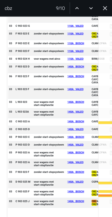

New, 140A alt (thanks for that idea @stigma ) working well, as was the A/C fortunately!

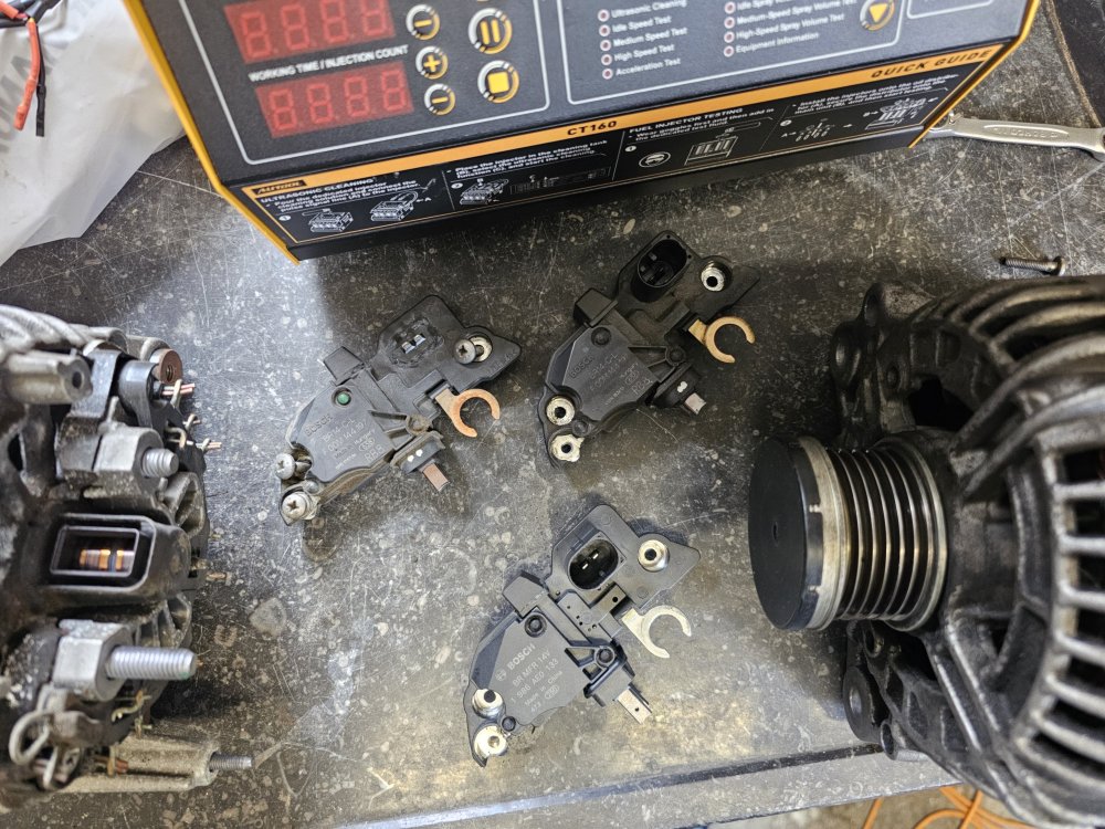

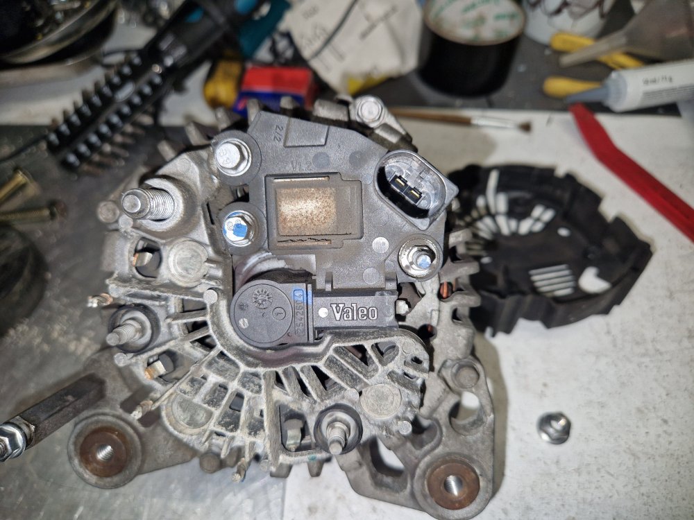

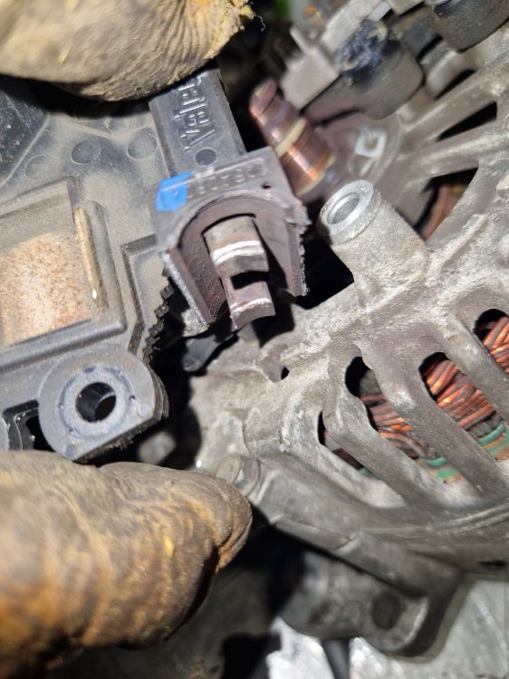

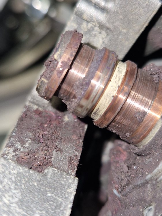

Just did a quick post mortem on the alternator that I fitted approx 16 months back.
As soon as the rear cover came off I could see that this was not a recent voltage regulator/ brushpack.
I must have misremembered that.
As the brushpack came away, big clumps of brush dust fell out.
Both carbon brushes were pretty short, but the outer slipring is the standout feature!
No wonder it was struggling.
Edited by Breezy_Pete
@Breezy_Pete Ouch, that is pretty nasty. Do you have access to a lathe at all?
  • Sponsor
No, but that's way beyond being worth trying to save.

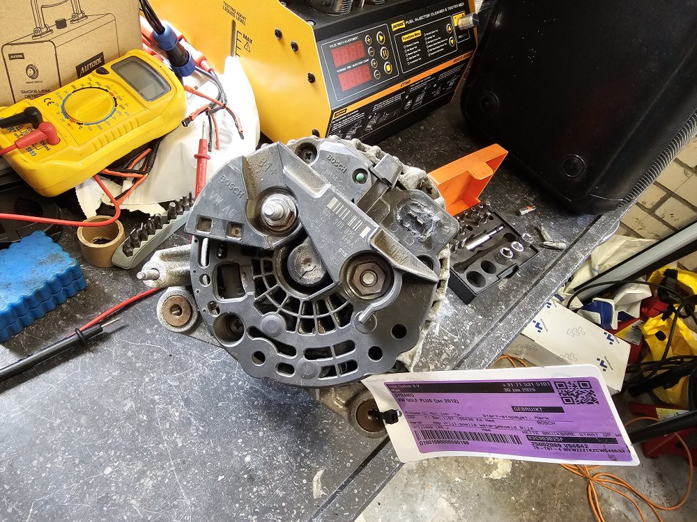

I did refurb the car's original alt, but it's a right faff on the Valeo designs, and I wasn't very happy with the result. I did fit a new slipring assembly, which was pretty cheap, but I wouldn't bother again.
Only paid £109 delivered for this aftermarket new one.
The alt that the post-mortem pictures are of was sold on ebay as being from a car with only 50-odd thousand miles on it. In 6:6 (metric of 20:20) hindsight, I call BS!

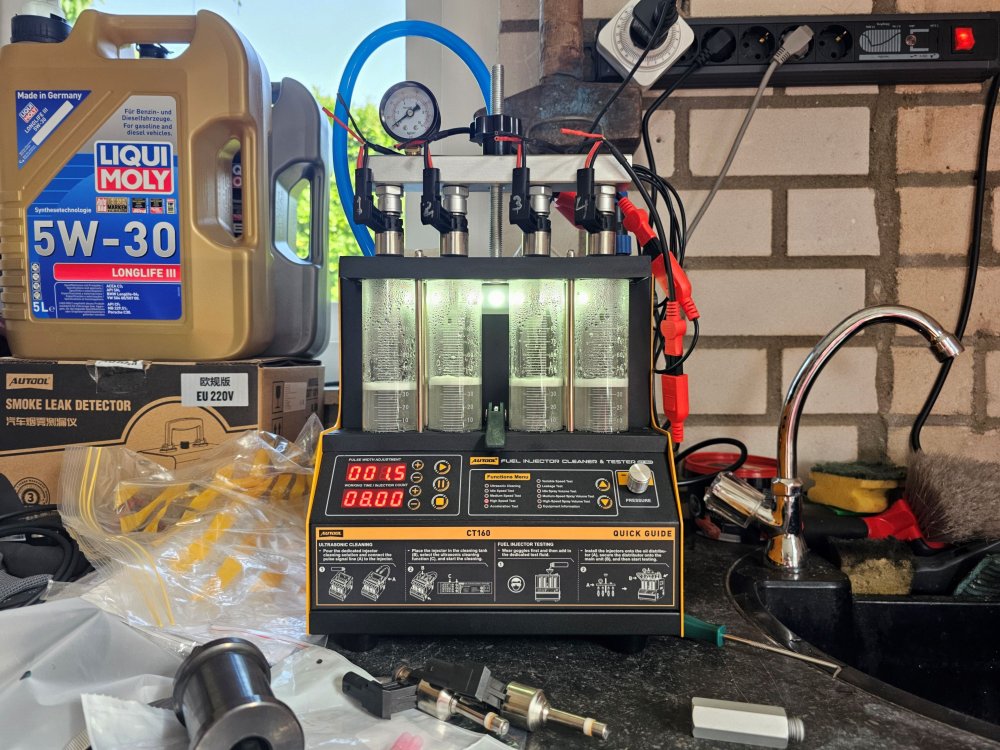

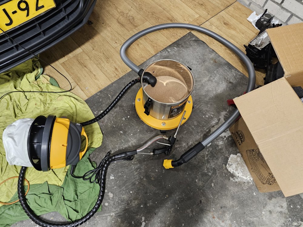

Now that that's done, time to move up to doing your own injector cleaning/balancing and intake cleaning 😅
I payed €275 for the walnutblaster and €245 injector cleaner.
Good tool for as long as we have ICE engines. Additional costs will just be consumables .
Edited by stigma

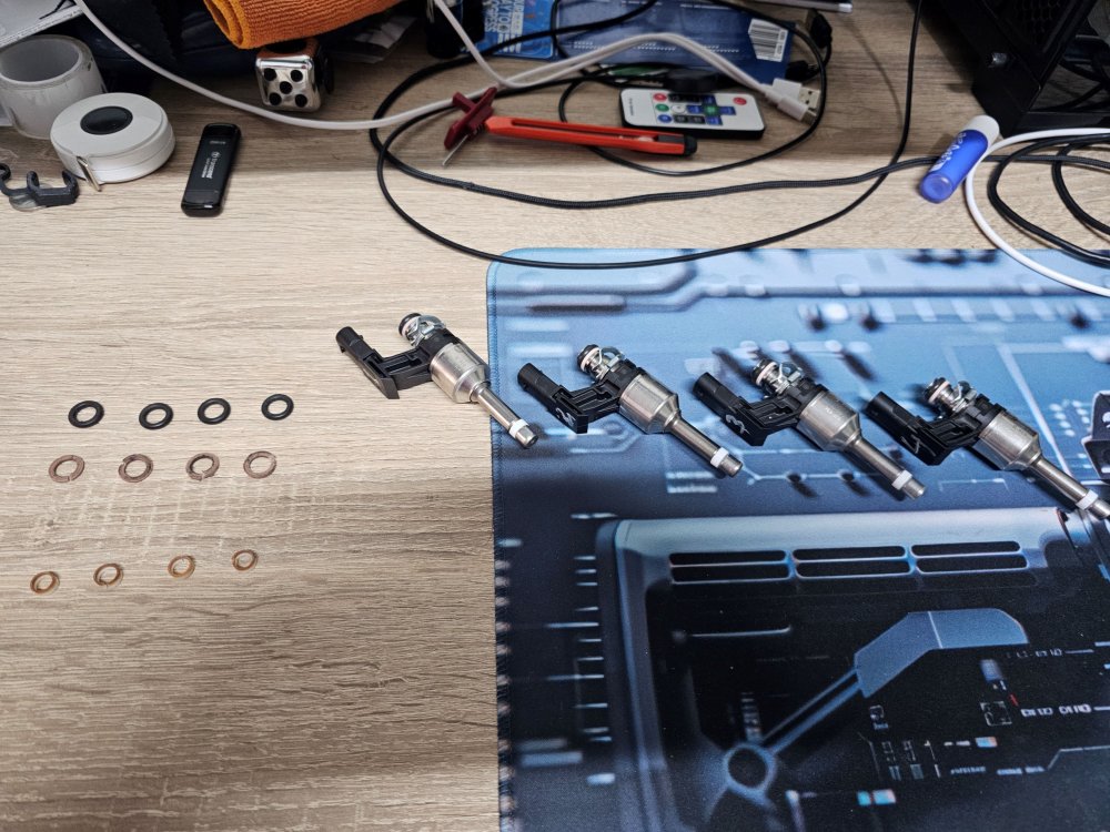

I bought a secondhand set of injectors from a low mileage car about a year ago and had them cleaned and tested at a local specialist.
Fitted them and noticed no change at all. 😆

I bought a set of injectors from a low mileage car. I think it had around 40k miles on them. The state of the injectors were so bad because they were so clogged with old fuel, i was unable to get them up to par with our own original injectors. Perhaps you suffered the same problem and this is exactly why i bought the machine. I need visual representation of the state of the injectors, not an assumption of good injectors.
I ended up returning them and managed to balance out our own.
