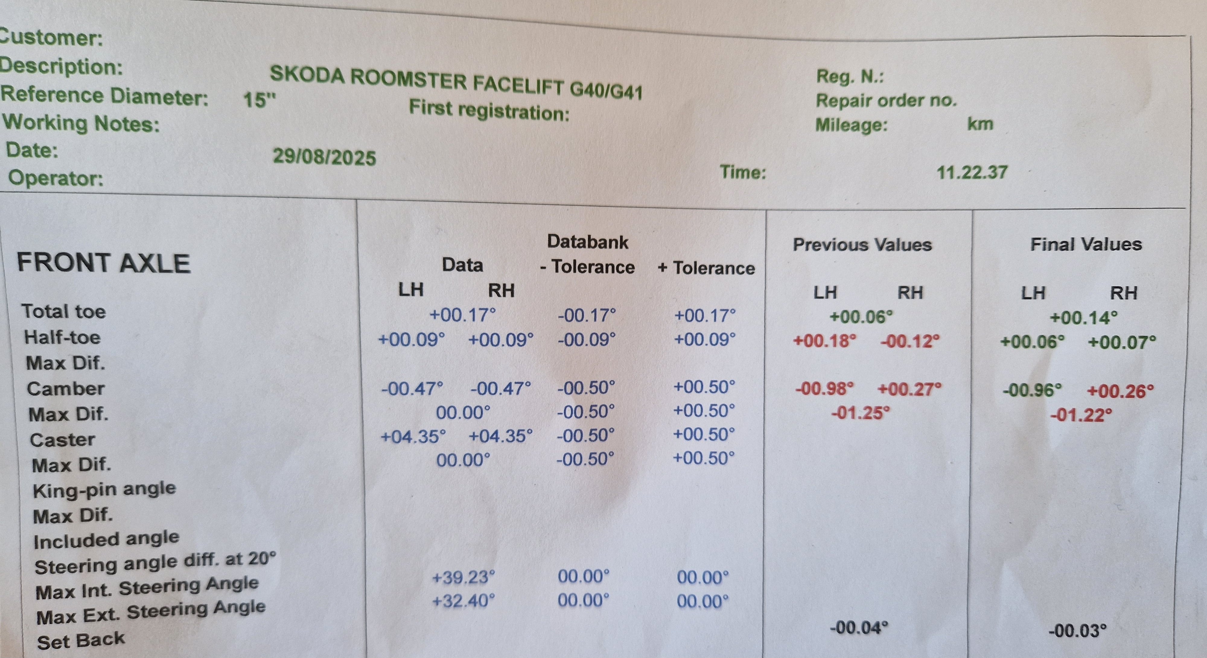

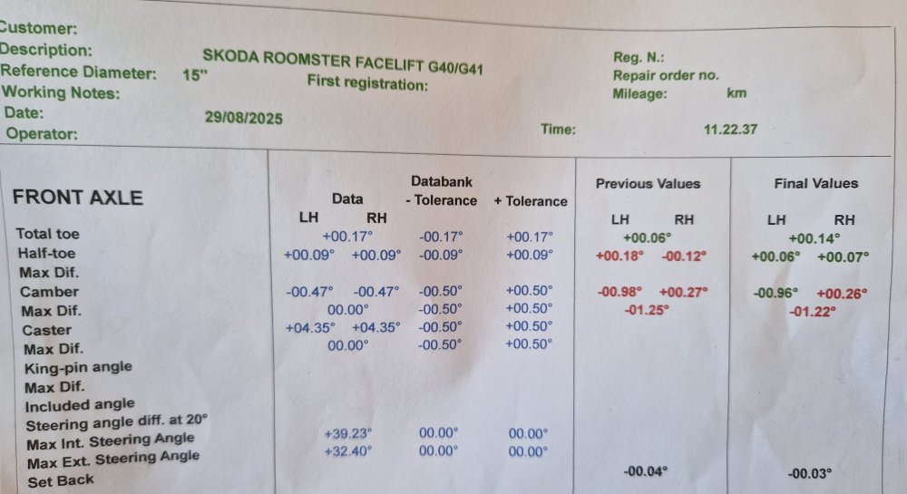

Alignment tweaked
Front toe now looking a lot better, but camber a bit asymmetrical.

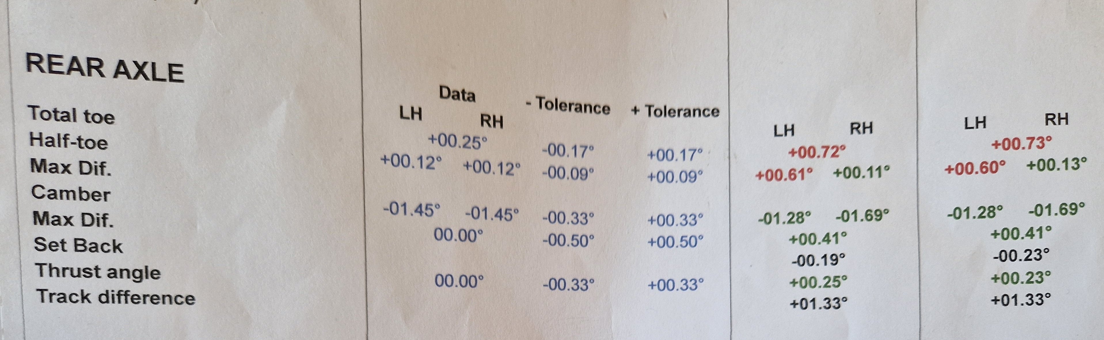

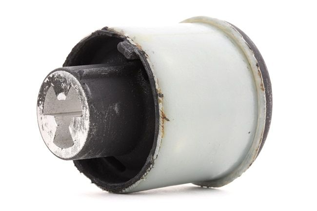

Something bad going on at rear left, wonder what I can do about that. Pretty sure there's no official adjustment there.
13 hours ago, Breezy_Pete said:
Alignment tweaked
At this age of the car, if you have rear suspension alignment problem, it's worth looking at replacement of rear suspension beam bushes. Other possibilities include bent rear suspension beam if someone jacked up the car on the beam, or if the wheel hit a pothole.
Parts needed are 2x 6R0501541A, "bonded rubber mounting", 2x N10409903 M12 bolt and 2x N10106402 M12 nut.
They are easily replaceable and about £10-£15 each from major suppliers, but need to be pressed out/in using a set of large sockets and a long screw (though plenty of bush removal kits on ebay and similar at £20 upwards).
Worth at least a thorough inspection IMHO. HTH.

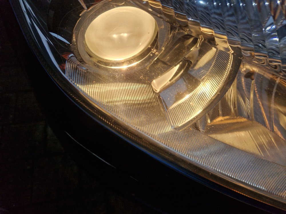

Poor forward visibility on dipped beam reported by main driver.
Changed the H7 dipped beam bulbs for Osram night breaker ones but no improvement apparently.

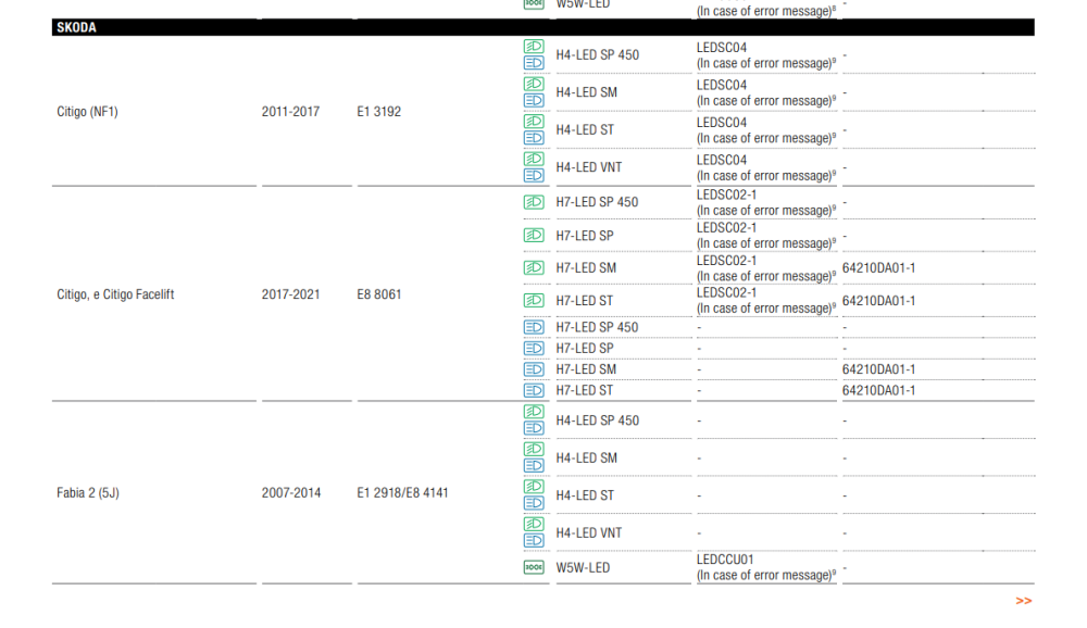

Is it normal for the round lenses behind the front polycarbonate housing to look hazy and opaque?
The outer polycarb is pristine.
Yeah Pete, same on our MkII Fabia. Worst idea ever to fit halogens in projectors. I got around it by fitting a HID kit. World of difference and literally it was a day and night difference. I don't know current legality of HID kits but the tester can't touch them IIRC. Hide the ballasts out of sight if possible. The only other option back then was getting reflector units but I think the MkII Fabia and Roomster are now able to be fitted with Osram LED's.
Gimme 5 minutes and I'll dig out the Osram bumph 👍
  • Sponsor

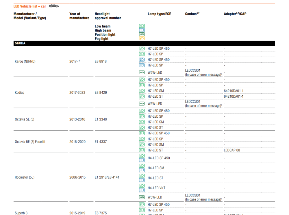

If my eyes don't deceive me, there only appear to be H4 options for Roomster.
Ours has H7 for dipped beam and separate H7s for main beam. ☹️
Damn! Pete that's a bummer. Then I'd look for some decent reflector units from a breaker/ eBay/ usual suppliers etc.
Those as they are are absolutely shocking at night and it amazes me how they were ever approved.

The hazing may just be a dust build up. Can you get a cloth in to the back of them to try a clean up? I think someone on here alsonager to clean the front using a pipe cleaner arrangement somehow too.
  • Sponsor
Missed this post, sorry for not acknowledging.
Interesting thought. What was 'alsonager' meant to say? Also managed?
Sounds worthy of investigation, ta.

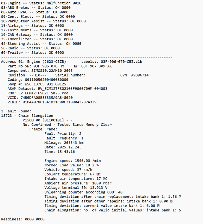

Might be another springtime project in the offing. Just scanned the car and got this, which was about 20 minutes into our return journey from Christmas visiting.
As well as the scaryish-sounding fault, the engine temperature (reported) looks rather low for the time since start-up, as does the system voltage at 13.9V.
I wonder what the deviation numbers mean? No chain replacement has occurred since (engine) factory build 165k miles ago, I'm pretty sure.
