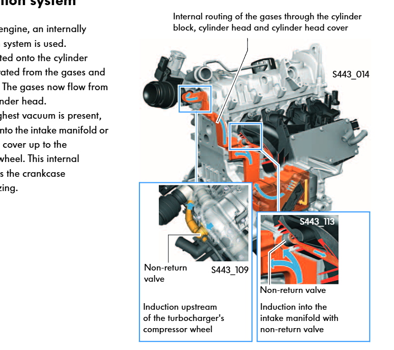

When I unscrew the oil filler cap with engine idling, it does a bit of a dance, which I think indicates that the PCV system isn't working at all brilliantly.

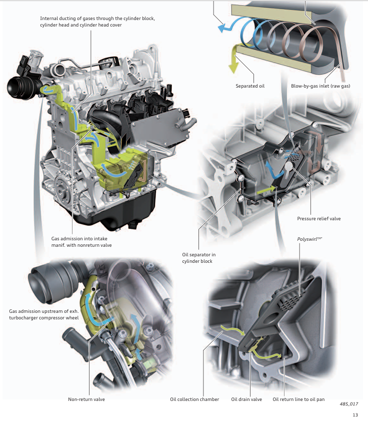

Researching this a bit via an Audi SSP on the CBZA/CBZB gave this page as the basic description of the system:

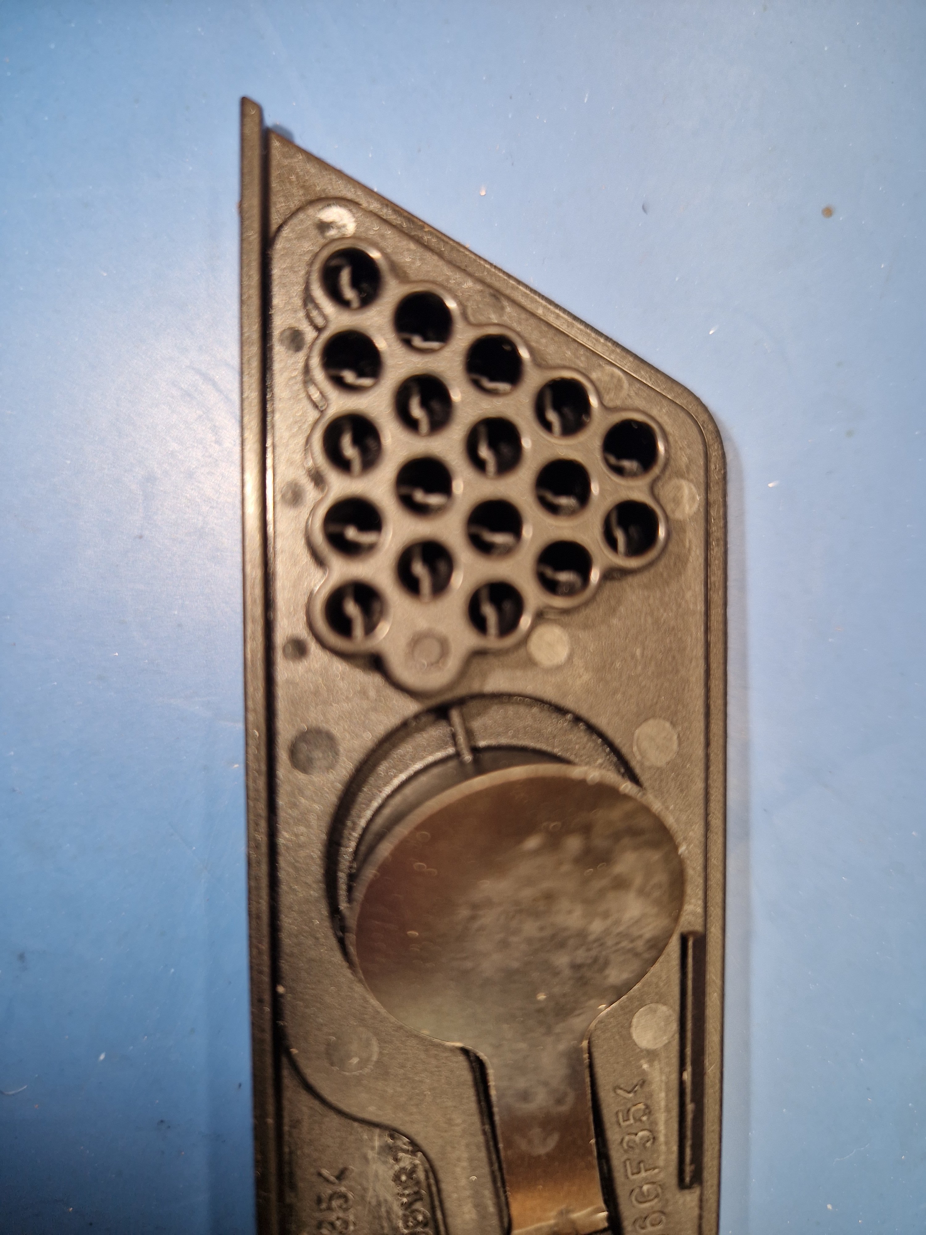

Having bought a genuine replacement oil separator, those 'Polyswirl' tubes are pretty tiny, and look to be easily blocked completely, leading to worse separation and possibly higher pressure upstream of them. You can't see through them at all, ID is maybe 3 or 4mm each; I think there's probably a spiral bit of plastic inside each, along their length, like a bit of fusilli pasta.

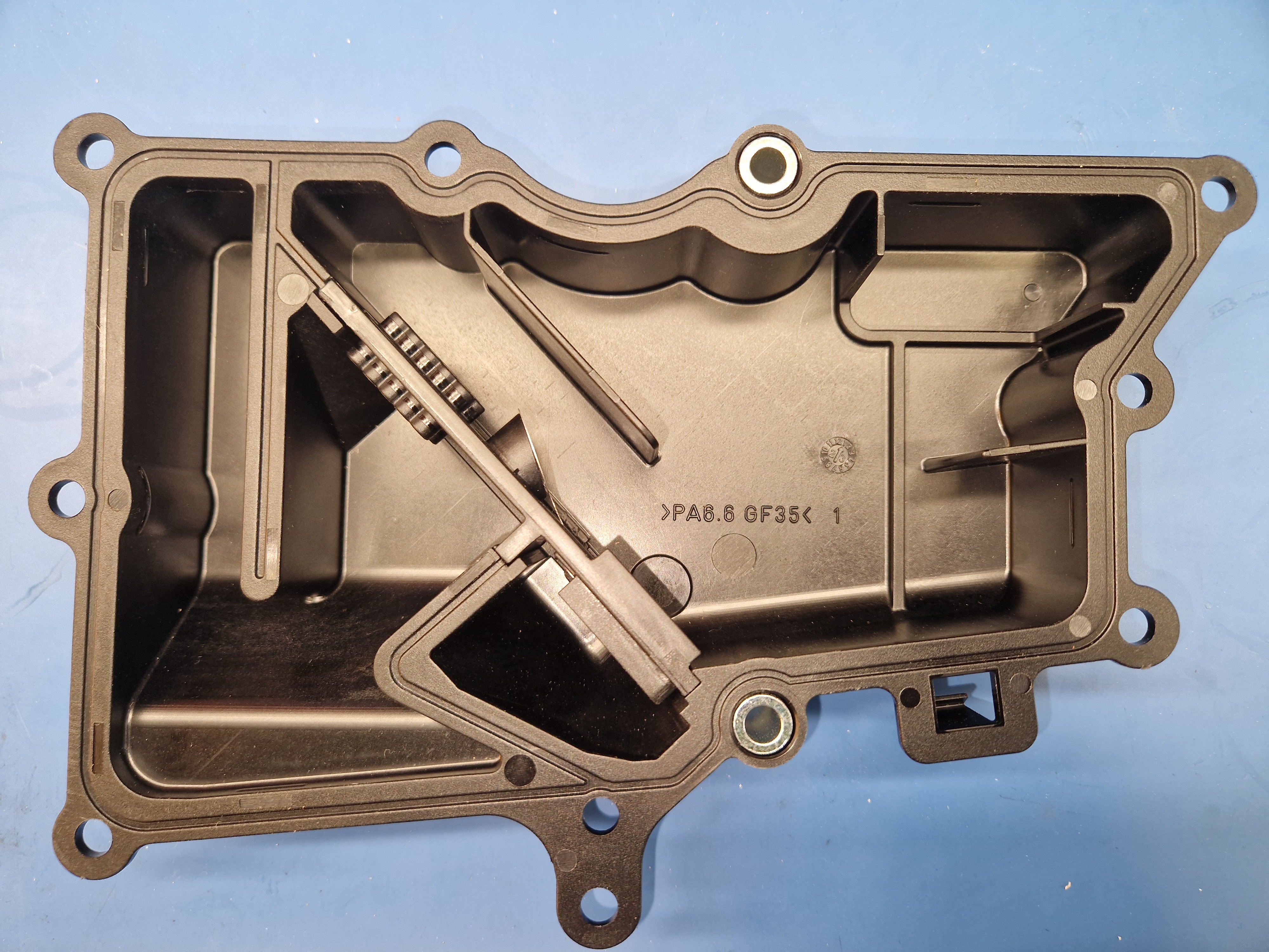

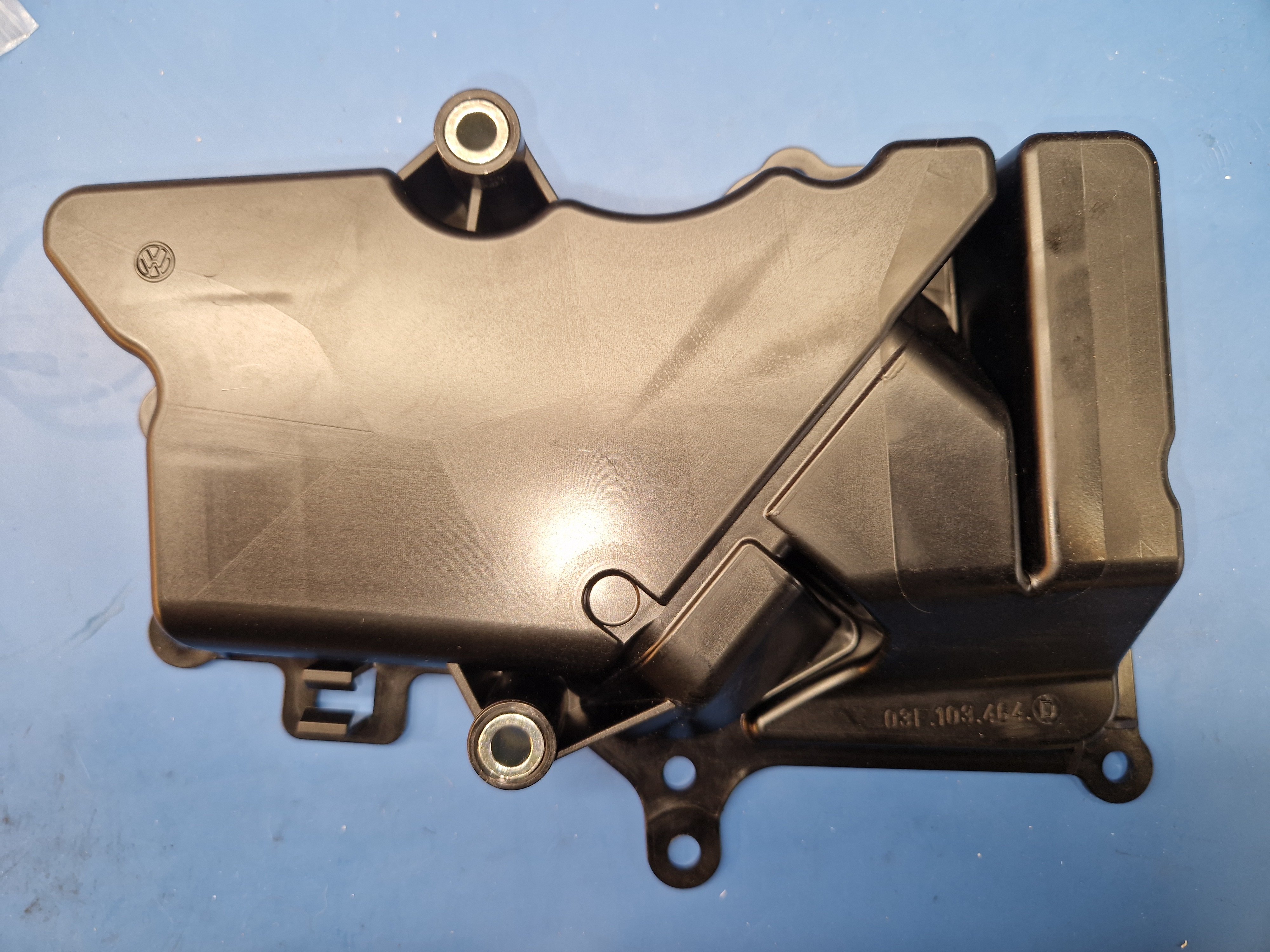

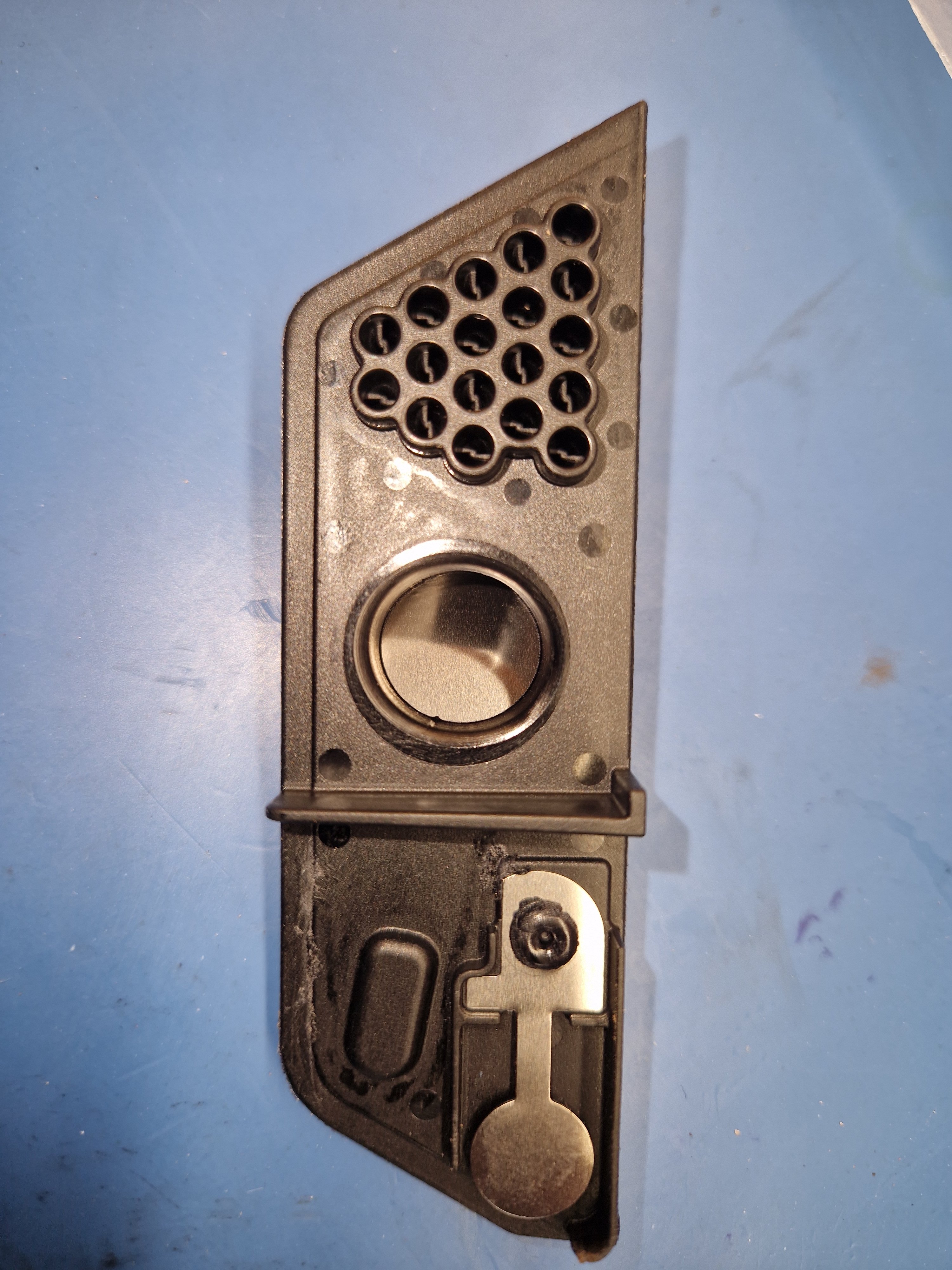

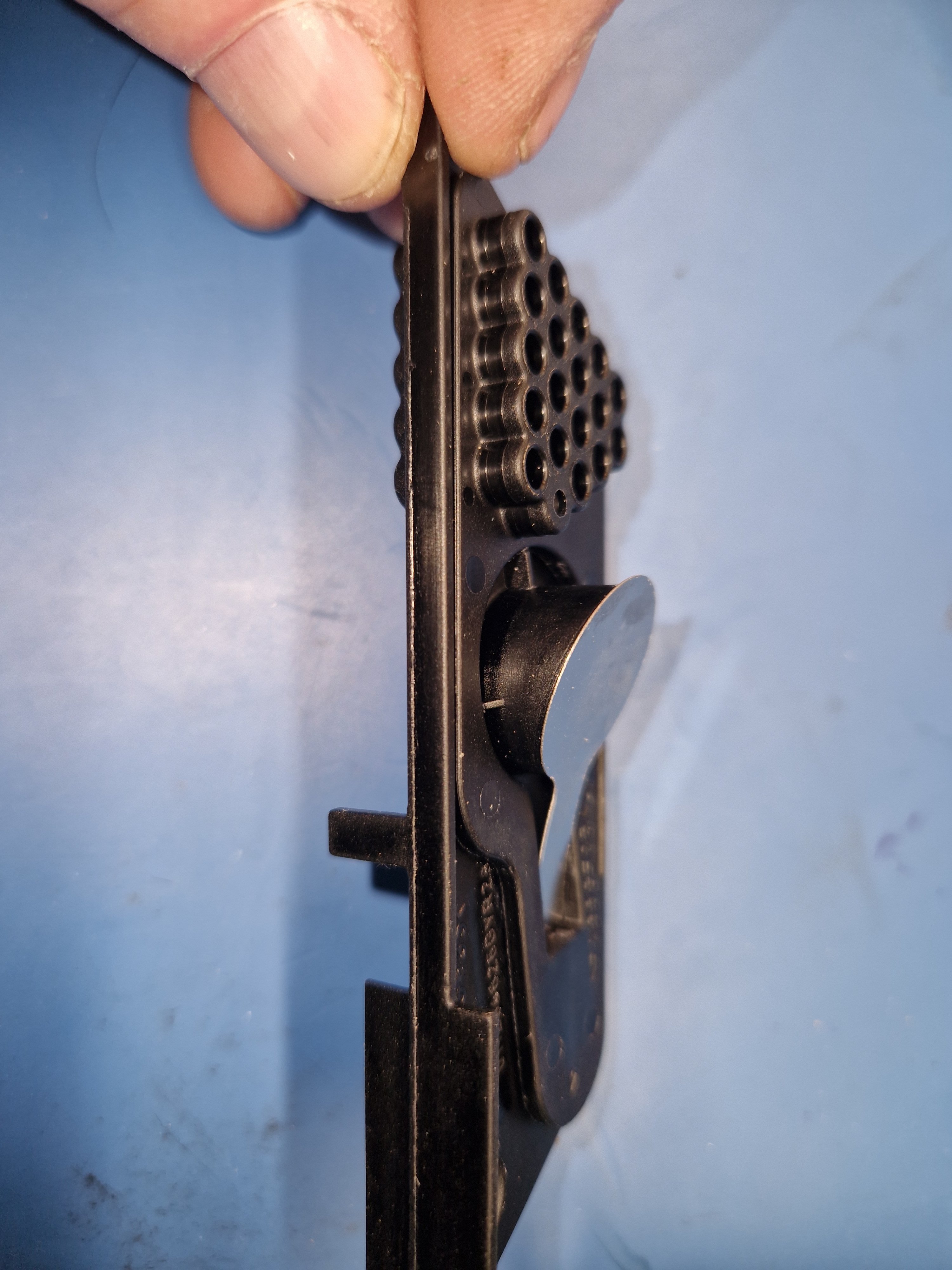

Some pics of the (new) oil separator and the detachable 'business section'.

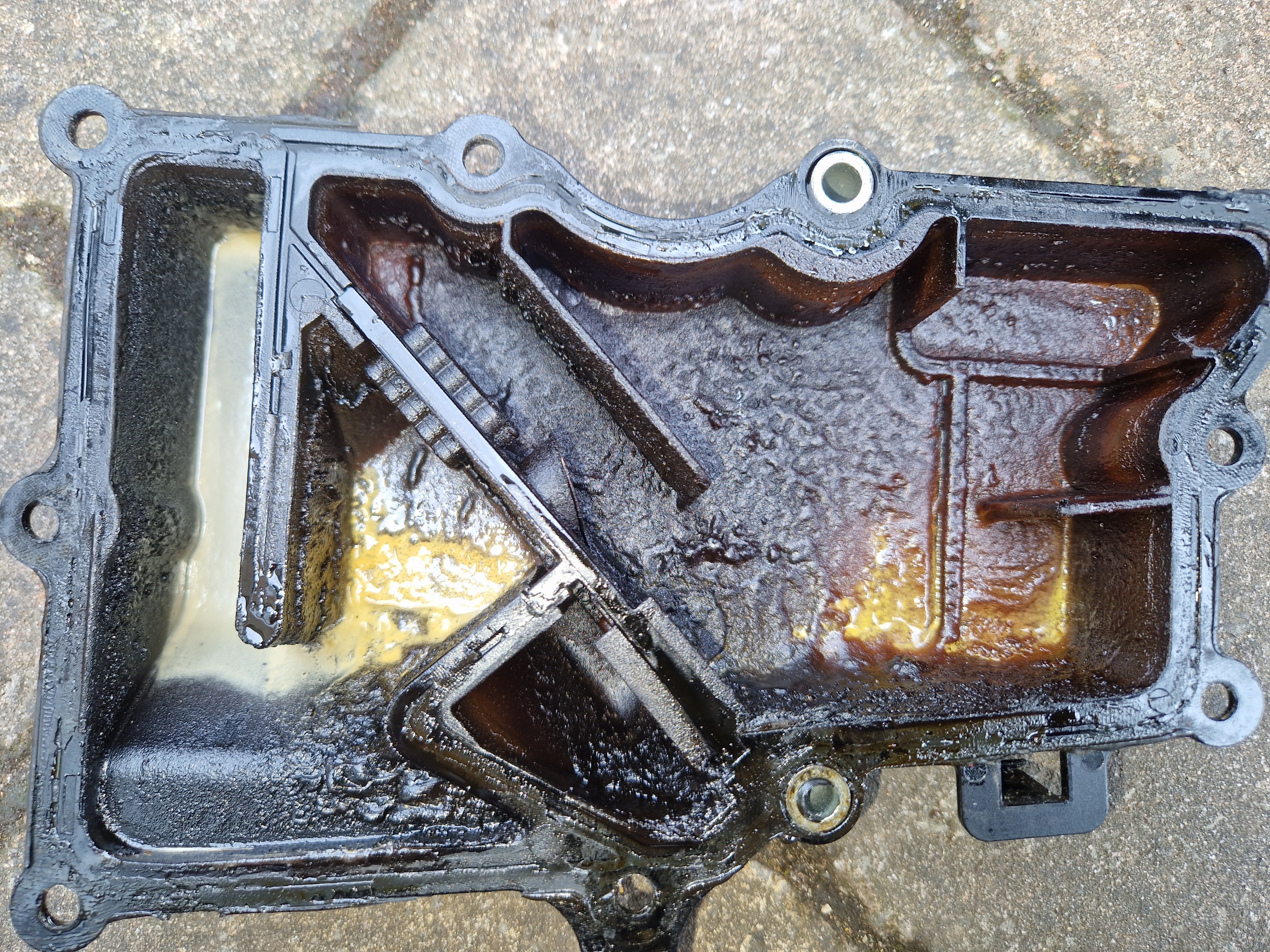

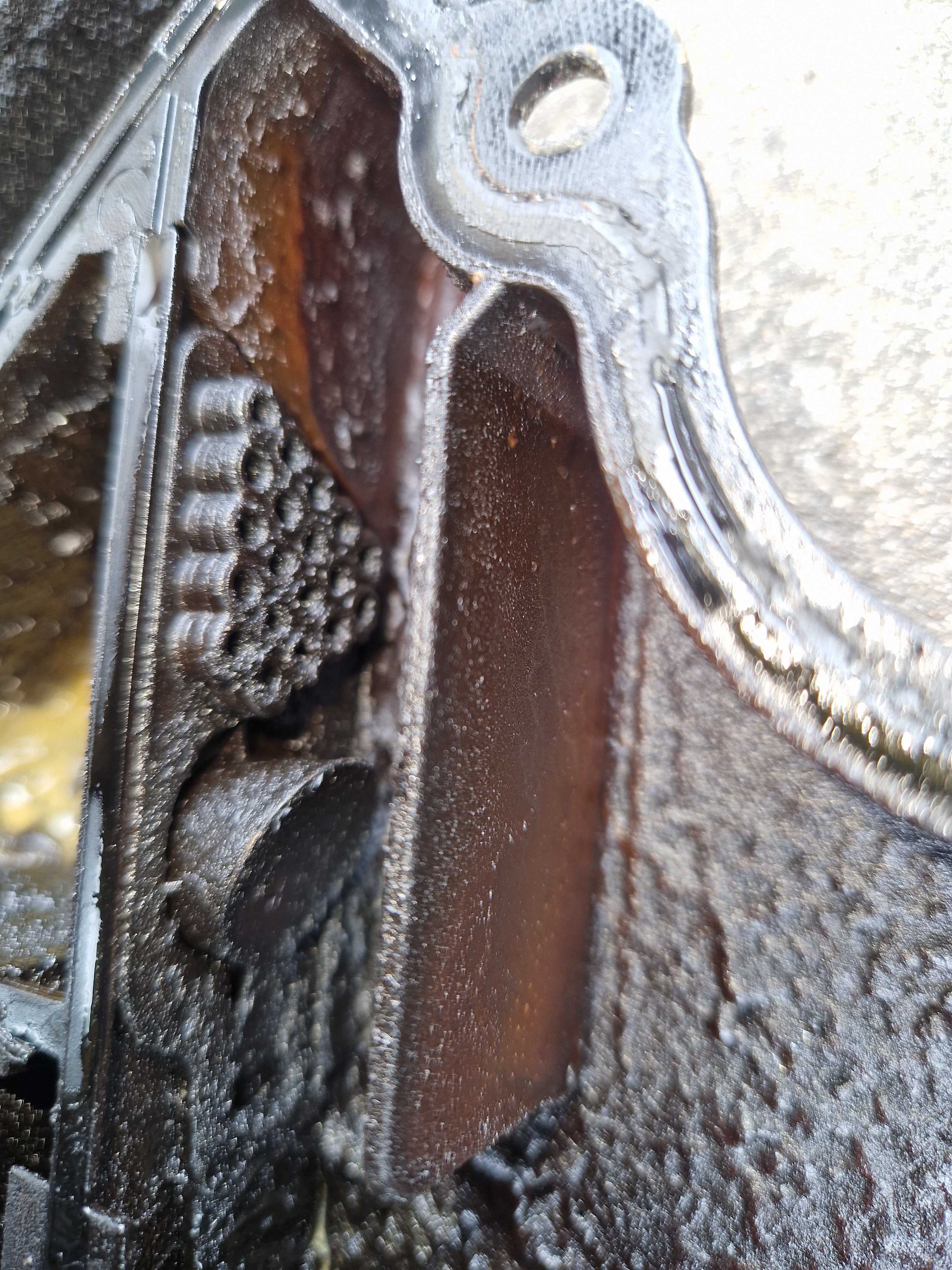

Got the old one off, with predicted struggle.
Secondary water pump shifted off it and tied up out of the way, then driveshaft off and out of the way.
Wouldn't really be do-able without driveshaft shifting, and would be another step easier with front exhaust/cat section off but that's a mission of its own, so haven't done that.
Pretty grubby, as expected.

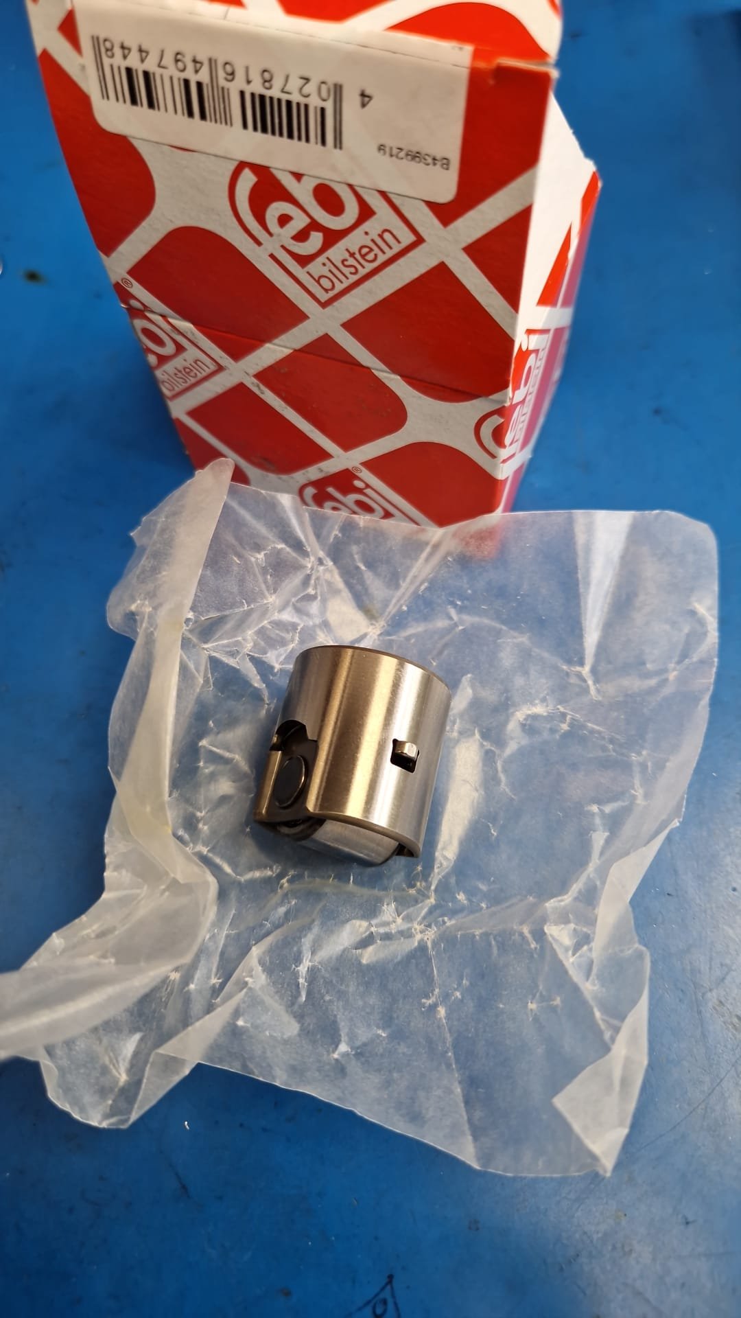

HPFP has to come off to get injector rail out, so looked into that too, and picked up a far lower mileage one from ebay, for not a lot of money. Apparently the cam follower can get worn to the point of perforating, so I picked up a Febi one of those for not much over ÂŖ20 via amazon.

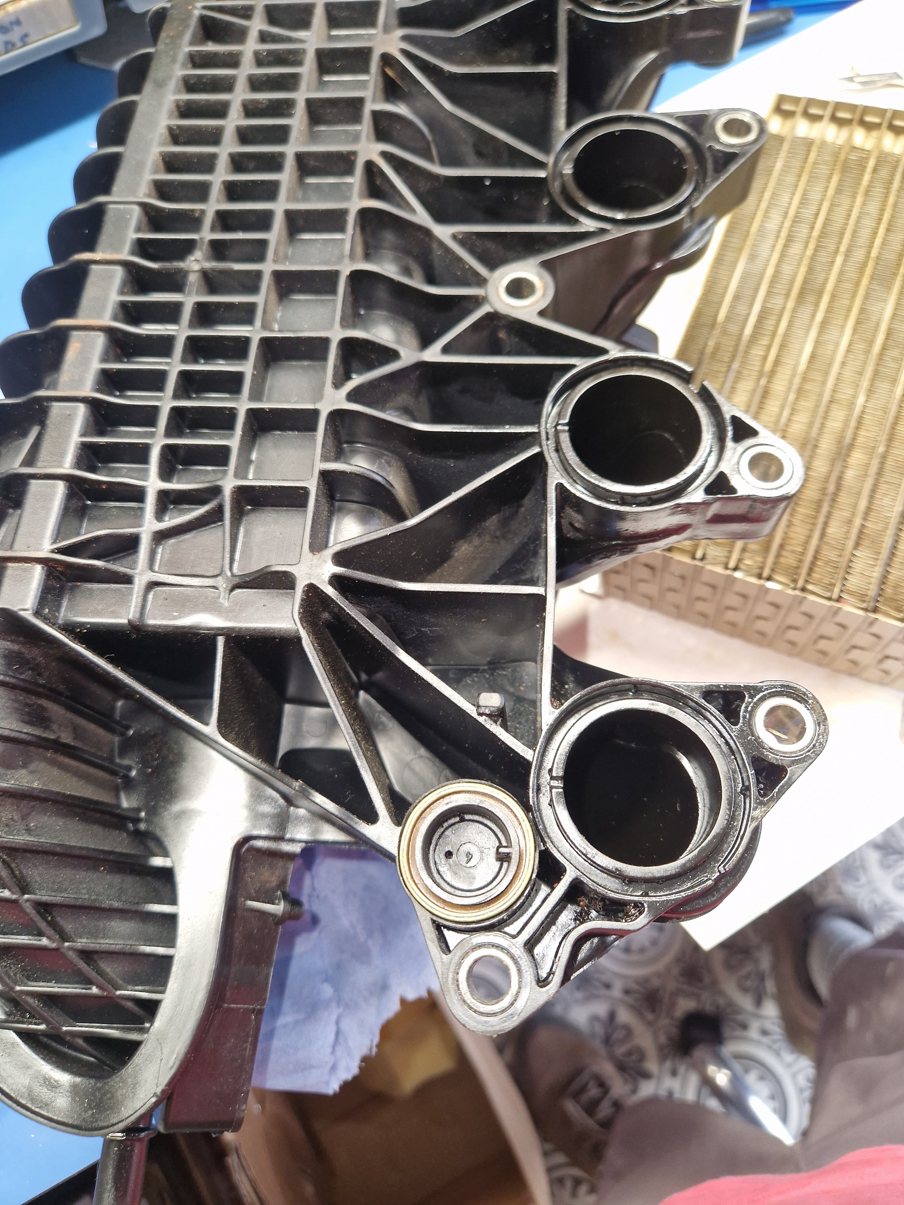

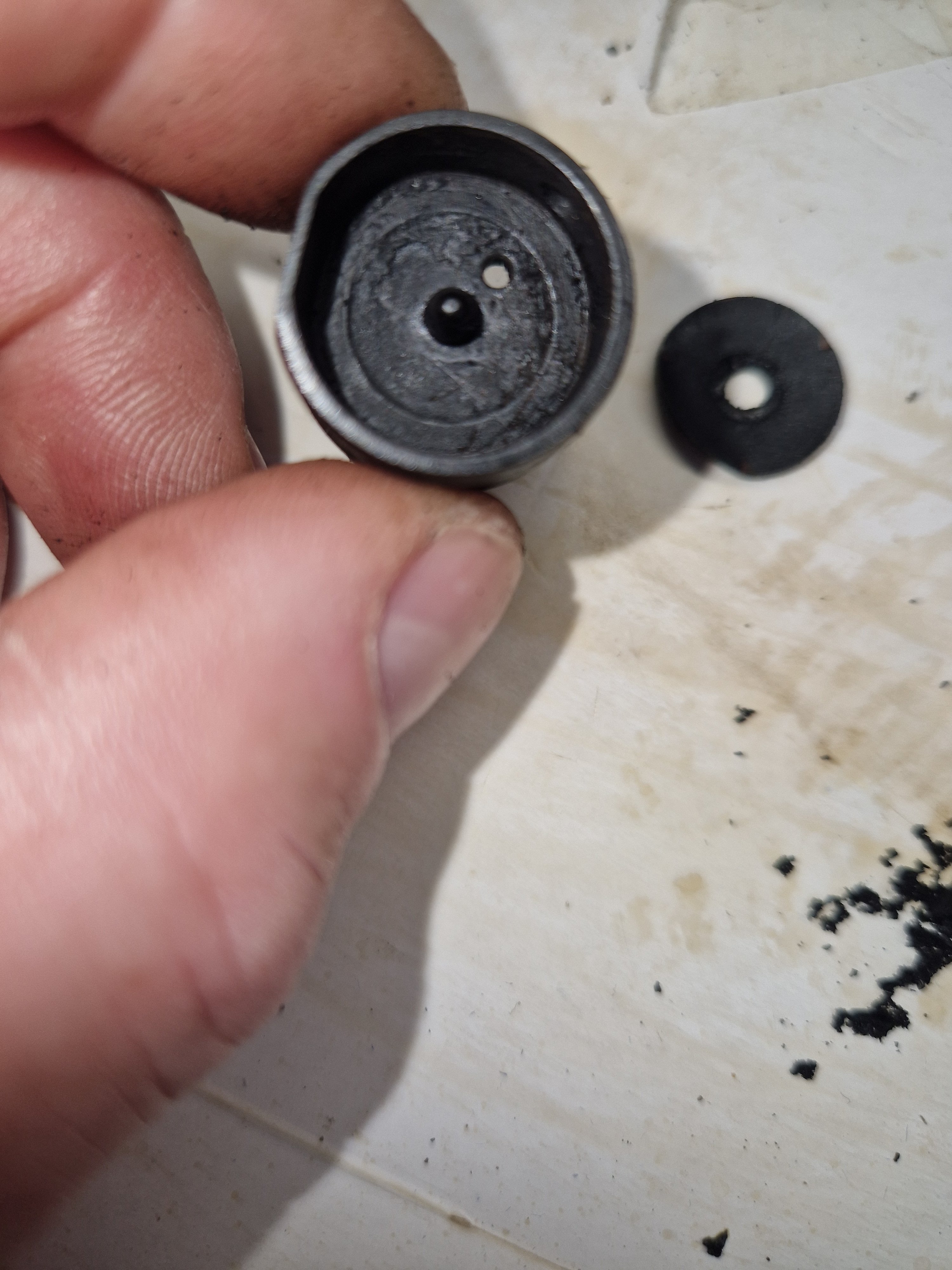

I didn't find time (or energy) yesterday to fit that replacement, refurbed manifold. Wednesday should give me the opportunity.

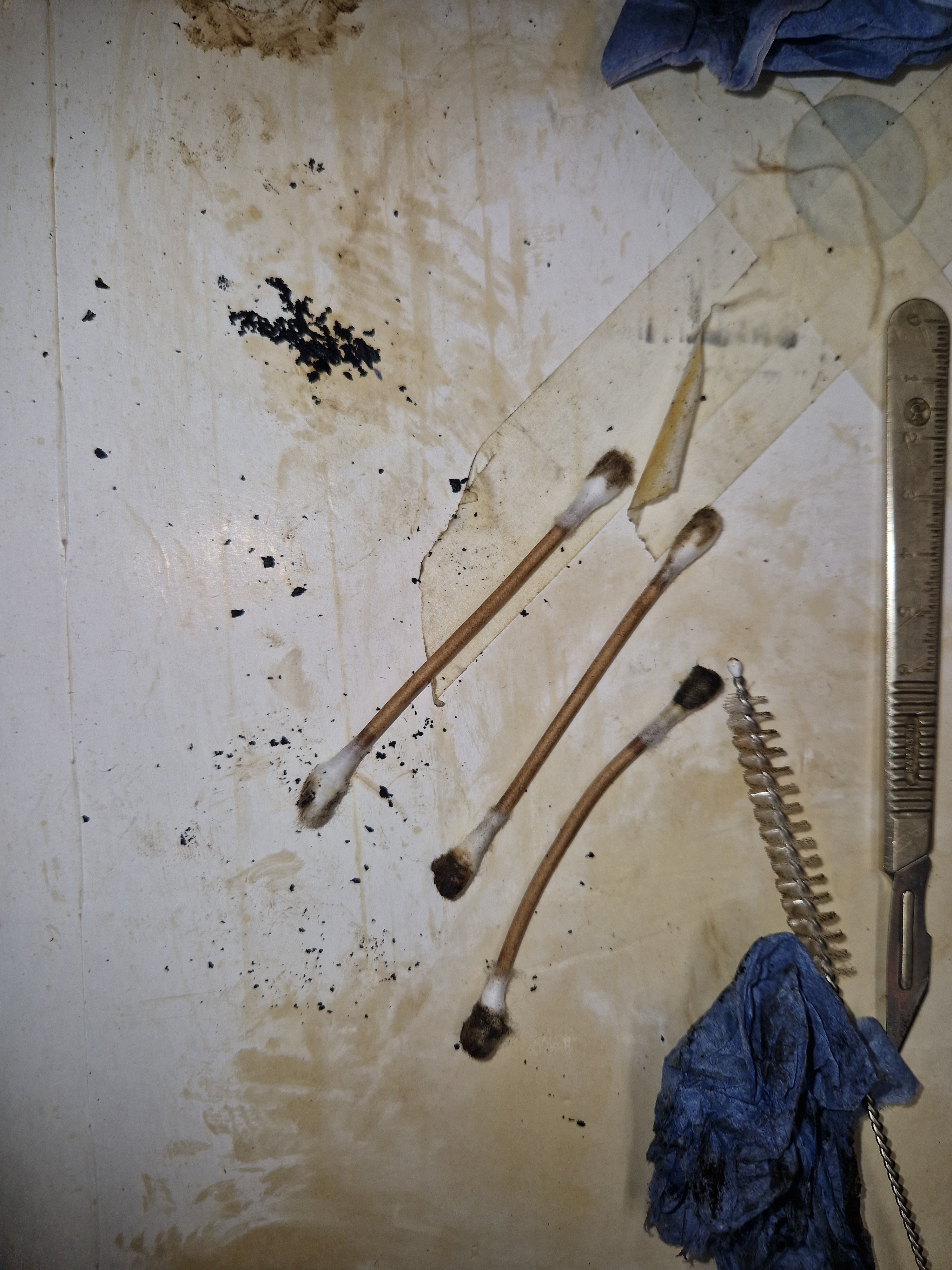

Can't wait to see if it resolves the crankcase breathing issue (see vid above of oil filler cap dancing). Confirmed there was a problem by looking for a little 'suck' on the air inlet pipe* to the cam carrier/valve cover and finding not a hint of flow into the system. I'm quite confident that the manifold is going to be very wet with oil that hasn't separated properly, and that the little jet/hole seen in Saturday's post is going to be equally occluded. The spare manifold was from a car with around 1/3 or even 1/4 of the mileage that ours has. At idle, inlet manifold vacuum should be ported/jetted through that tiny hole found on Saturday, above.
*That little air pipe has been made infamous by people breaking off the non-return valve at the engine end of it whilst changing the air filter, see here for example.
From another SSP with slightly clearer diagrams and annotations than the Audi one, bottom right exploded view shows the 'suck' that ought to be happening at/near idle.
Edited by Breezy_Pete
  • Sponsor
That tiny hole was indeed blocked on the manifold in the car, and fitting the spare manifold with it all cleaned out has rectified the 'dancing oil filler cap' problem.

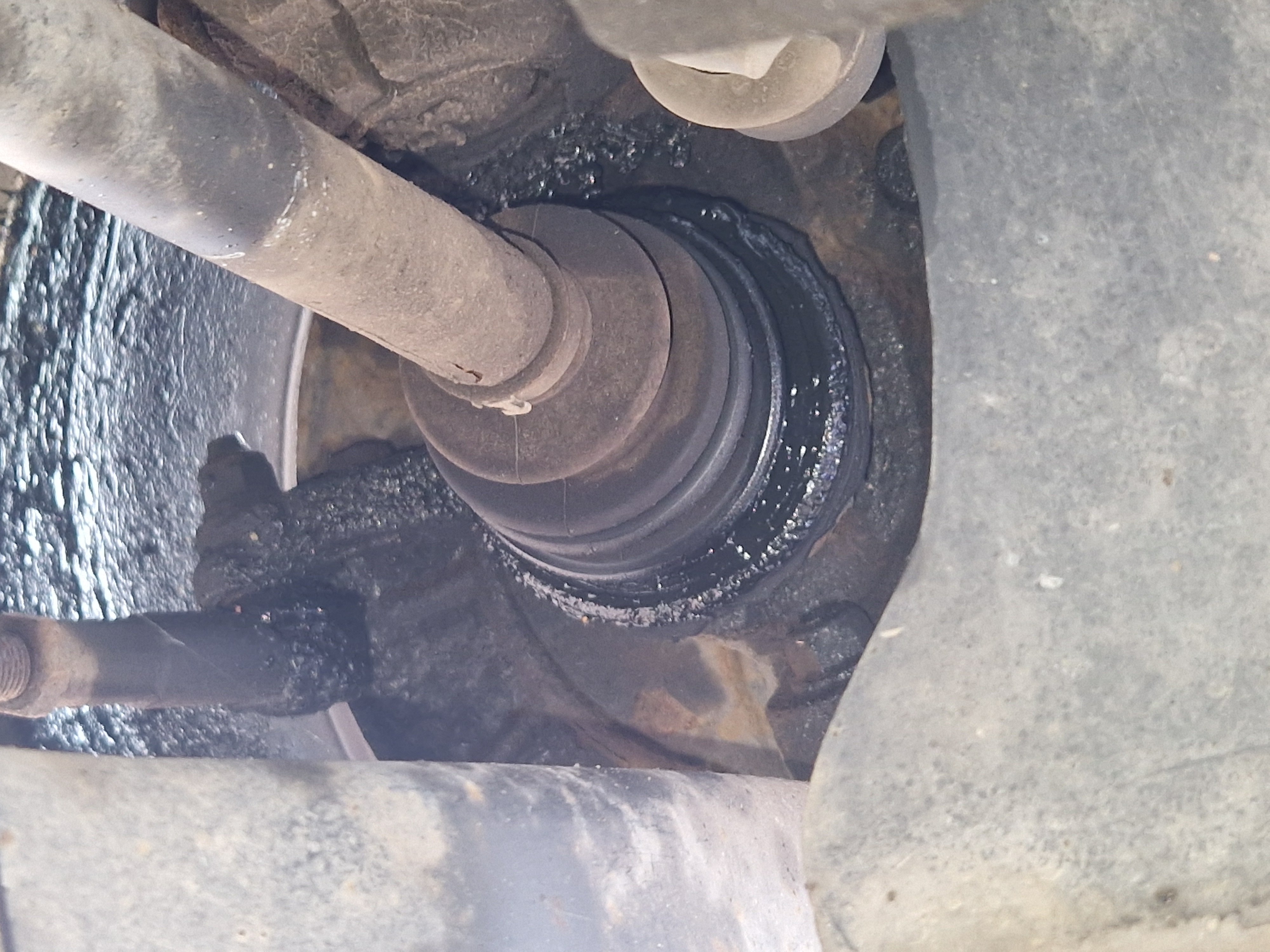

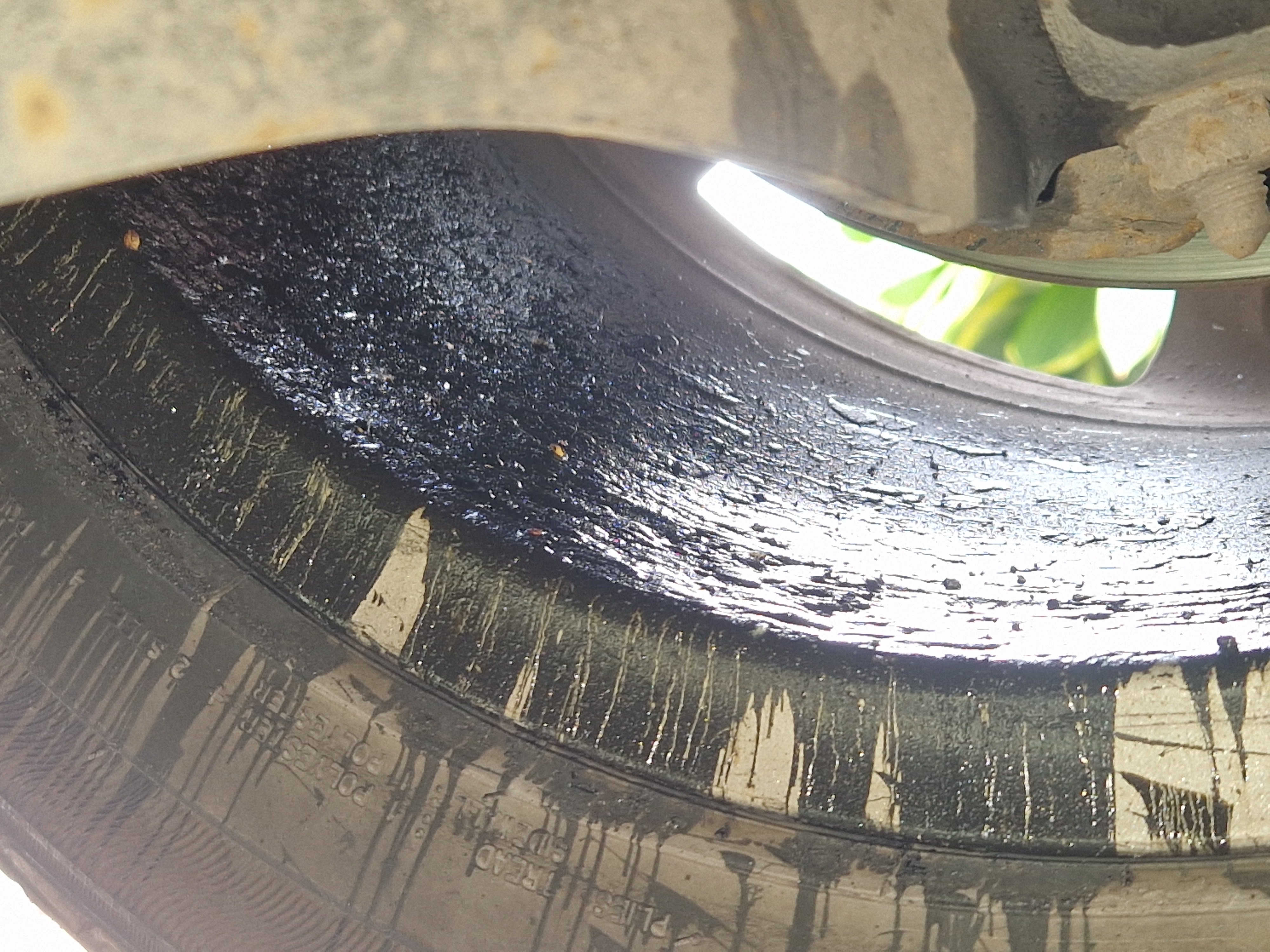

Was under it this afternoon changing the oil, not expecting to see this:

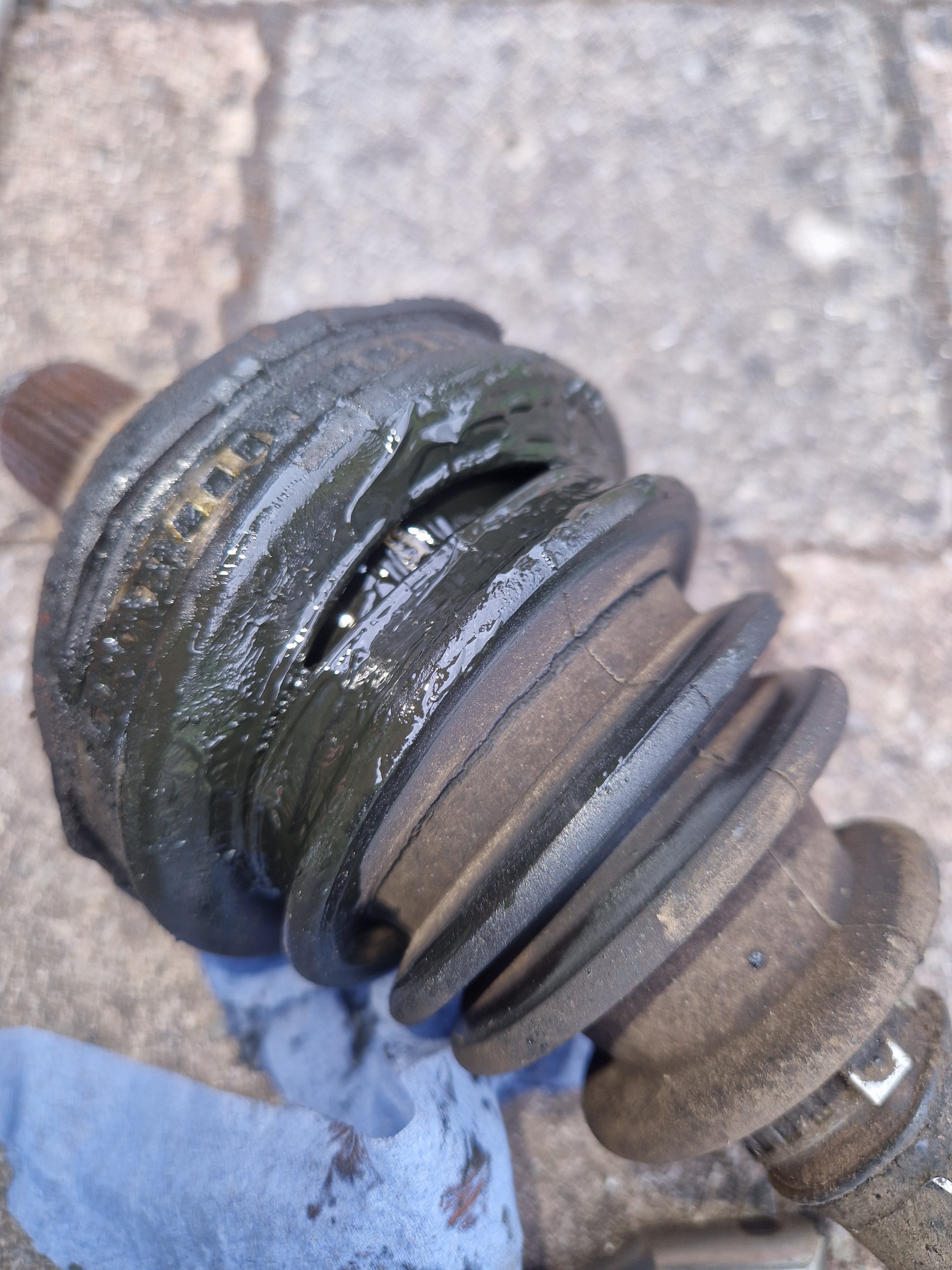

Nearside outer CV boot decided to let go, thoroughly.

Not sure if you mean both boots on that driveshaft or both outer boots? If the latter, offside one was one of the first jobs when it arrived here.
Plan is to swap in a whole nearside driveshaft. Ordered one from ASM from a Roomy with only 55k on the clock for a very good price.
And with some aplomb 🙄
With the use of my yuckygreaseometer and aspectratioviscometer, and using AI to measure the runs on your sidewall, it looks like it let go at 37.832mph. Time of death 0912am, 17 July 2025 😁

Big ole split
