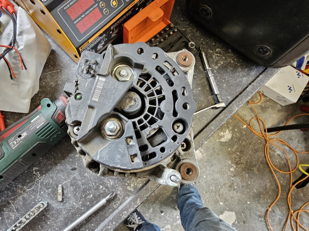

Sadly not just battery failure.
Either alt, or alt freewheel pulley freewheeling both ways (is that possible?).
Can't check the pulley for a few hours, at a family birthday in a different car.
Not finding a replacement alt showing as collectable at either GSF or ECP within at least 25 mile radius. ☹️
I'll check in bit. If I remember correctly, it is supposed to freewheel both directions.

Alternator pulley/clutch turns and slips both ways
  • Sponsor
Thanks.
Just checked and this one engages and turns rotor in the clockwise direction, as expected.
If rotor is wedged it freewheels with anticlockwise turning of pulley, again as expected.
Can't blame that I reckon.
  • Sponsor
Pretty sure I fitted a new regulator/brushpack before I fitted this (genuine, 2nd hand) alternator only 16 months ago, so I think it must be one of the diodes in the alt that has failed.
I'll try to test how much ac ripple voltage there is when it's running, tomorrow morning.
  • Sponsor
110Amp, 03F903023E is the genuine part number, to suit 2012 1.2 tsi Roomster.
Think it's a Bosch.

I was wrong about manufacturer, it's a Valeo.
The car has dealer-fitted detachable towbar and rear parking sensors, but I suspect the alternator was not changed from factory supplied one at the time. It's on the PR list as 110A.
I will try searching 03F903023D - Bosch 140A instead, thanks @stigma
  • Sponsor
Have now ordered an aftermarket new 140A one from Ebay/ Schmitz Rotary in Birmingham, should be with me at home on Mon/Tues.
We'll borrow Dad's car to get home and me back here again in a few days.
Thanks for the support folks. 🙂

You should be able to swap the alternator out in situ. Disconnect negative battery terminal. Remove the 02 sensor and remove the heat shield fasteners and move aside the heat shielding. Remove the fan shroud, remove the pulley that covers the bolt for the alternator. After that, remove the top bolt and lower the alternator with the bottom bolt still captive somewhat. Disconnect the communication plug, remove the negative clamp and the cable holder.
After that, disconnect and lower away and hang the AC compressor aside, pull out the last fastener and then lower away the alternator. Reverse install the new alternator.
Make sure you have part 6R0937629B with the 175A fuse for the alternator path.You don't want a lower amperage fuse board or you will end up with a no charge condition pretty quick.
GL.
Edited by stigma
  • Sponsor
Thanks.
Alternator change was the first ever job I did on this car, before I'd even bought it, so I know tge method.
Don't think O2 sensor needs to come off on Roomster, nor fan shroud. I didn't last time anyhow.
Sometimes it's quicker and easier to make more space though, so I'll consider your suggestions.
Thanks again.
