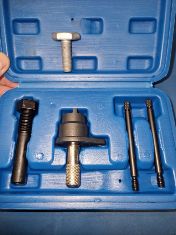

Eventually found the locking tools that I knew I had bought, after a battle with my oh-so-tidy (not!) garage. Also a spare cam sprocket screw, so I can keep the chain kit complete.
Realised that a first step logically involves attempting to correlate the error code with a measured incorrect cam angle, by just using the crank and cam locking tools, no disassembly other than removing the bits to fit those.
With crank lock tool fitted and crank held turned tight up against it, I should be able to see how much of an angle the cam locking tool isn't aligned by.
Only thing I wonder is whether it's best done with engine cold or at working temperature; probably the latter, I guess, but I may try both.
Anyone know what the two pins are for, on the right in the box?

Are they not locking pins, Pete?
  • Sponsor
Possibly. What would they lock though?
Not entirely sure. I had a thought that that's what they are but I was watching Flipping Bangers earlier and as luck would have it, they were doing a cam belt on a CitroÃĢn XM (a cheap future classic IMO) and Gus used a pin to lock a lower pulley (crank pulley I believe it was) directly into the engine block. Makes sense to lock the crank and the cam.
It was on U and Yesterday channel at 20:00 GMT
Edited by Lee01
  • Sponsor
I'll see if they get mentioned in the workshop manual.
Cheers.
  • Sponsor

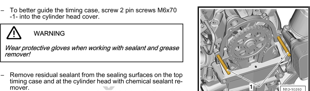

Thanks Lee, I soon discovered that they are in fact pins to help locate the upper (plastic) timing cover whilst refitting with sealant gasket on two surfaces:
I guess they guide the cover into just the right spot at the first attempt, preventing squidging of sealant into places it shouldn't be. Insert all the other screws, then remove these pins to fit last two screws.
I've used similar, but homemade things when refitting sumps with liquid gaskets.
Will be helpful now that I know what they are. 🙂
