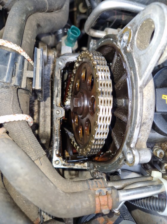

I managed to do the whole top chain cover off/on without draining coolant, by tying those hoses out towards expansion tank and removing the plastic clip from around them. That gave just enough space to move the sealant coated cover back into position without knocking it on anything and disturbing my neat lines of sealant. Must pop out and check if the oil leak seems to be gone after this morning's drive.
It would have been easier to clean off the old sealant if I had drained coolant and moved that lot all completely clear, and I could have used the locating pins from the timing pin kit if I had.
I'm writing most of this for the information and interest of anyone else reading who might contemplate doing the same, if they get the same fault code.
Other crucial thing is to remember that the crank locking pin, only locks it in one direction; you have to force the crank clockwise against it to be sure the crank is in the correct position. This can conveniently be done with a 12-point 18mm socket-plus ratchet handle, or ring spanner, on the crank bolt, ratchet strapped back to the wishbone, preventing reverse crank rotation while making adjustments up top.
  • Sponsor
This pic was taken before my partner made me realise that plastic hose bracket could be removed.
(It needs to slide towards the firewall 10mm to come off, there's a sneaky locating pin on it at the bottom which goes into the rubber 'hose grouper' thing).
Edited by Breezy_Pete
