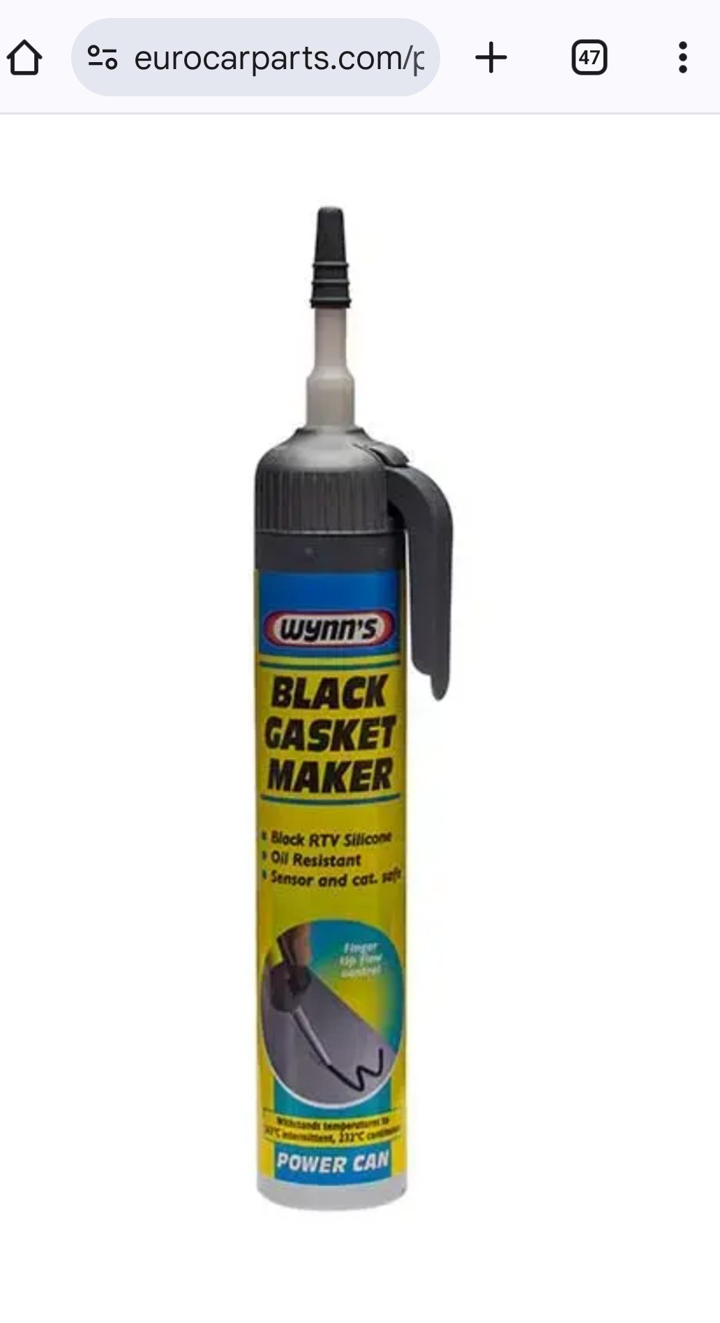

The leak is from the oil filter housing for which a replacement is proving to be quite difficult to source
Are gasket makers any good ?
Sorry I'm lost as to what you mean. If the leak is just from an oil filter housing can't that part be repaired or is it new gaskets/seals aren't available, depends on what the material of the gasket/seal is but a replacement might be able to be fashioned (I don't know but someone who rebuilds engines would). Liquid style gaskets/seals and/or sealants have been used by themselves and in addition to the gasket/seal. The stuff you use has to be suitable for application and be done so that there's no excess to block or break away.
ETA: the area or parts that need a gasket/seal and/or sealant have to be apart to make or apply a gasket/seal and/or sealant applied. (seems a bit odd to me you can't get or have made a gasket/seal but I don't know the situation)
Easiest way might be to look at a parts diagram to see what oil filter housing is and how it's fixed to the engine and where and what gaskets/seals are used.
Unless the filter housing part you're referring to is an integral part of the engine casting?
You really need those that know about your particular engine, or research if this is a particular problem that for some reason is difficult to resolve.

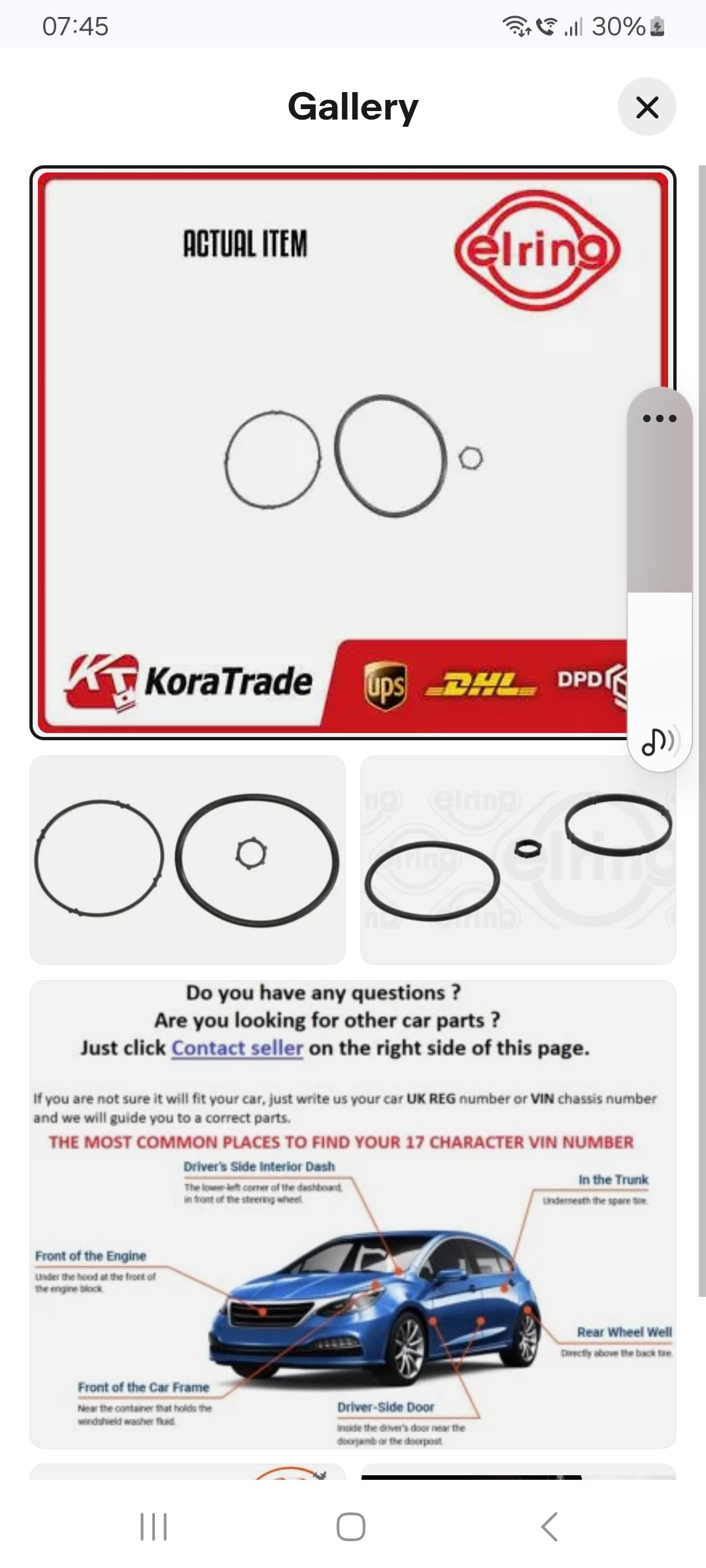

Ordered these off Ebay, it's due an oil change so may as well get it all done in one go
Yes you might find with the oil change that some previous guy's work wasn't as good or careful as it should have been, or a mistake made, and/or perhaps a faulty or damaged part.
Good luck, let us know how you get on.

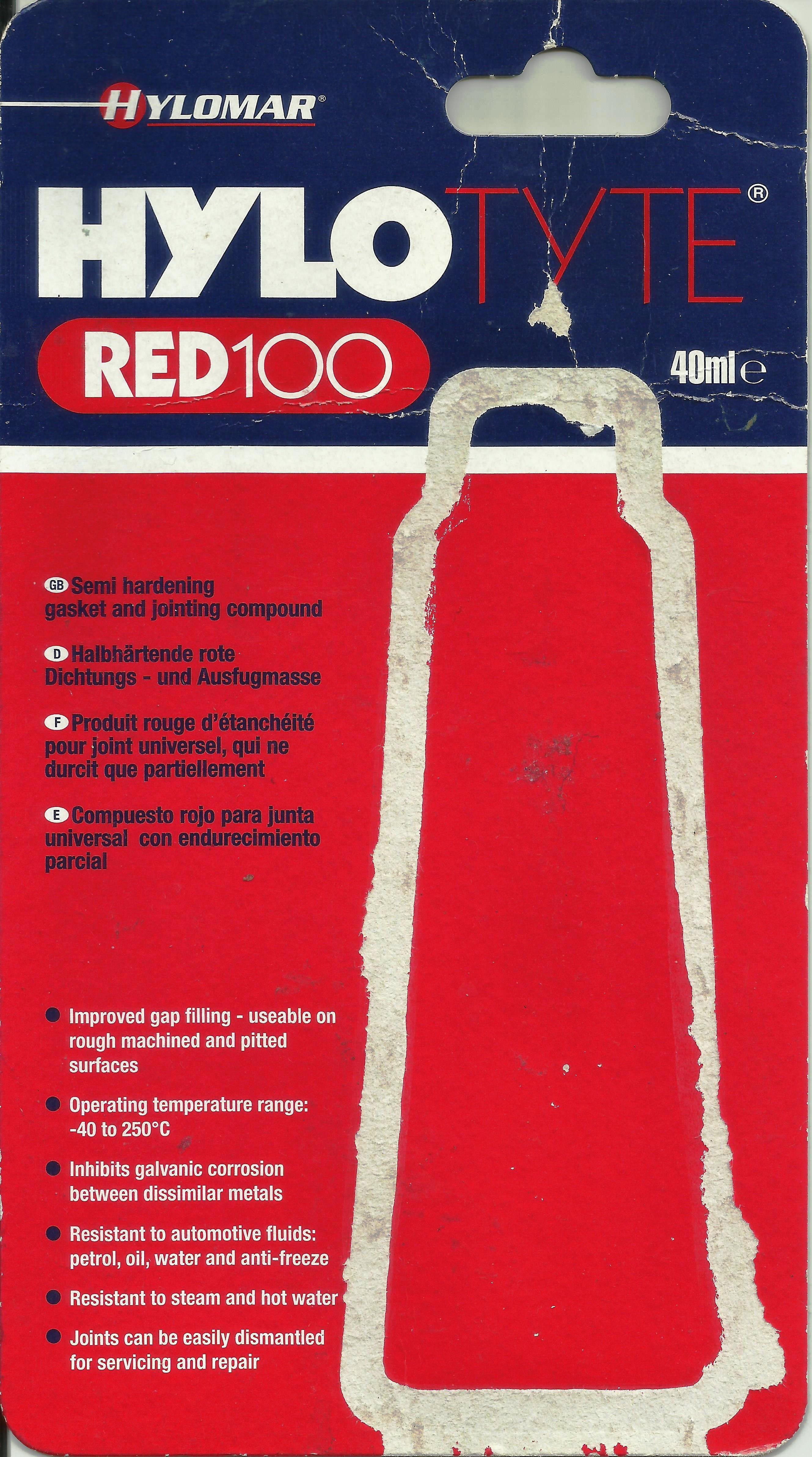

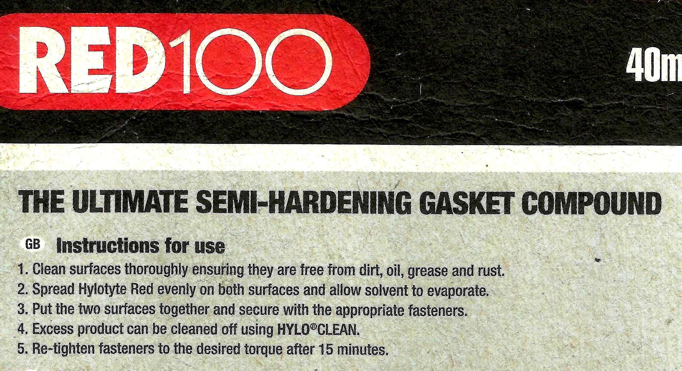

ETA: Or perhaps it's a known problem with the engine, component or part, possible age related. When I had my old cars (British from 1960s and 70s) I had to use a gasket sealant a couple of times as I also used a coolant that was very good at finding or making areas of weeps and leaks and some other owners told me that only the (paper) gaskets were required, in my experience they were wrong sometimes. Just in case you should ever need it this is what I used for the coolant system (metal, Red 100 if required, gasket, Red 100 if required, metal), I found it better in that application than the Hylomar Universal Blue.

New filters tend to come with a new O ring.
If the housing itself is leaking it's likely to be cracked somewhere.
It is possible it's the gasket between the housing assembly and the block that is leaking, in which case either a new gasket, new O ring or an appropriate sealing compound should fix it.
