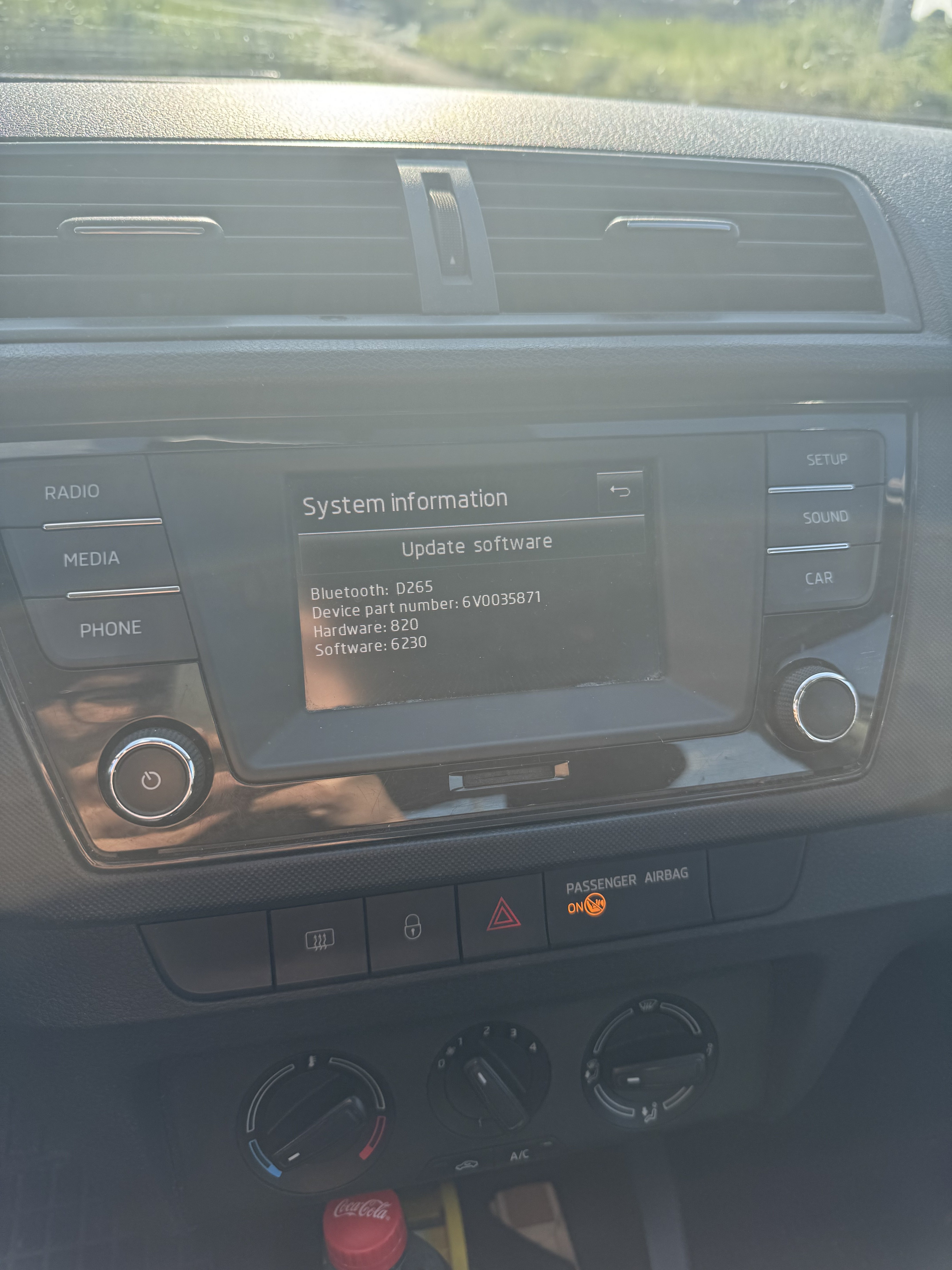

Currently i have the old small screen,
Part number:
6V0035871
What are all the parts i need to change, I understand its the display, the glovebox computer. Anything else?

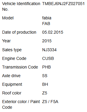

The VIN of my Skoda Fabia is
TMBEJ6NJ2FZ02705
On 09/05/2025 at 18:05, flacky said:
TMBEJ6NJ2FZ02705
Too short number - should have 17 characters.
@pab567
Sorry, didnt copy the full number:
TMBEJ6NJ2FZ027051
Much better :)
You have SWING MY15, with Bluetooth, without DAB. You need display unit, glove box unit, new USB and harness to connect it all. I can deliver isuch set, pls contact me on PM if you are interested.
