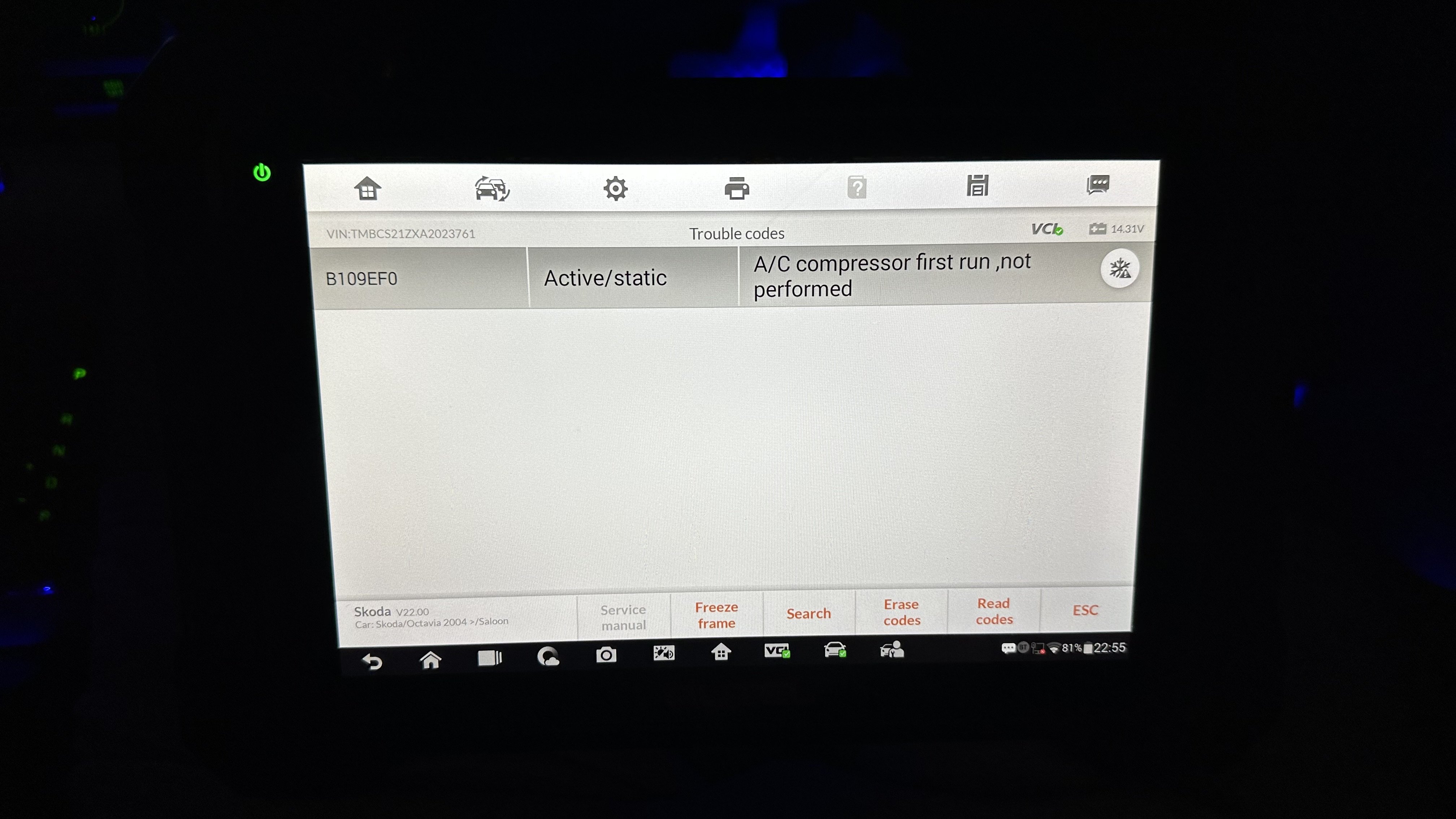

I honestly run out of options as I don’t know what’s wrong with it, It keeps showing the error code B109EFO but every time I do the basic procedure of ‘AC Compressor First Run’ the procedure fails at the end!
Please let me know if you have any suggestions as it’s very frustrating to have no Ac!!IMG_5260.jpeg

Yes I have tried, the system has no leaks, but it’s also worth mentioning that my AC Button is always constantly flashing when starting the car, without pressing any buttons or doing anything.
