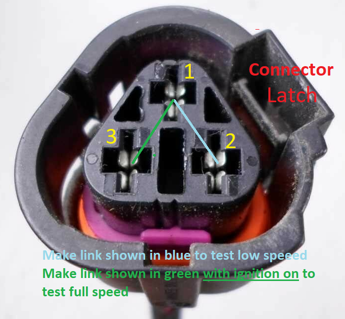

With A/C it's easy to check rad fan(s). Switch it on and demand coldest air with bonnet open and expect to see fan action almost immediately (ambient temp dependent) with fan at low speed.
If it/they come on and sound fast and furious that's probably full speed, indicating that low speed has failed. If no fan action at all check fuses.

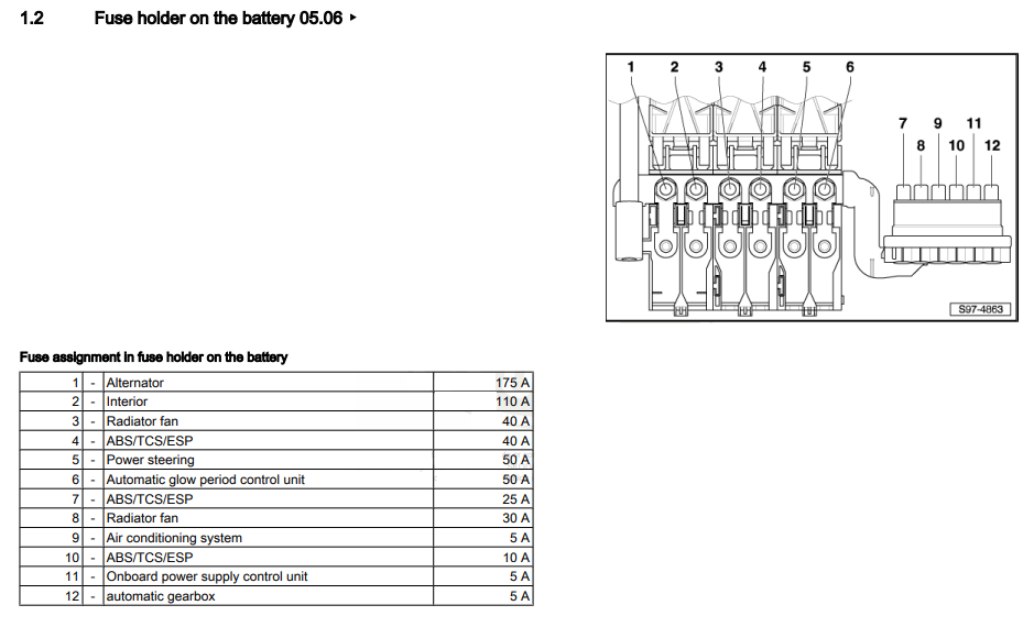

I know so far from having the car run for over an HR that no fans came on. Temp was measured at 103 from diagnostic.
I haven't come across any blown fuses yet while I was searching for the issue with the stereo.
All the fan-related fuses are above the battery, three in total. Like this, but you won't have 6 and 12, at least:
At 103°C measured with coolant temp sensor you're probably not quite hot enough to trigger full speed fan action based on coolant temperature, as the (dual) thermoswitch is at radiator outlet, so ought to be a fair bit cooler than cylinder head even if fan isn't working.
A/C-mediated fan action is independent of coolant temperature, being controlled by refrigerant pressure instead.
One or two rad fans?

It is a 1 fan radiator. The radiator which is attached to the fan is fairly new looking. Nice and shiney.
Ok I have my injector back in and she is running now.
I've switched on the AC and set to full cold. Although it could do with a recharge but works still. NO Fan whatsoever comes on regardless of it running for 20 mins.
I checked the expansion bottle and water is recirculating in it .
The top radiator hose is hot but the bottom is cold. I would say either air or a blockage of sludge. Especially with the amount of sludge in the expansion bottle . The water pump is quite noisy also . I have bought all that anyways so waiting to get from Germany. I will then try to flush the system and then fit new parts. I will buy a rad temp sensor also and try to eliminate all I can.
I am going to get under the car later and try test the fan as I'm not sure it is working as the fuses all seem fine.
I've just checked that fuses.
No 6 has a fuse but nothing connected to it.
I then have no 7 to eleven all fine . I will have to check the ratings of the fuses as I'm not quite sure they are whats in the picture.

The radiator thermoswitches almost never fail on A/C cars, cos they're only carrying relay coil current of the fan control module's relays, not fan current, so I think that would be wasted cash.
Check for broken wires near to its connector though, and test fan itself via this linking of loom connector:

I think there maybe some issues further up the wiring loom or a faulty fan. I can't see anything that's broken . I will get the multimeter out later this week and test the loom
I bridged 2 +1 then 3+1 and got nothing with ignition off and on. The fan does spin freely manually tho.
