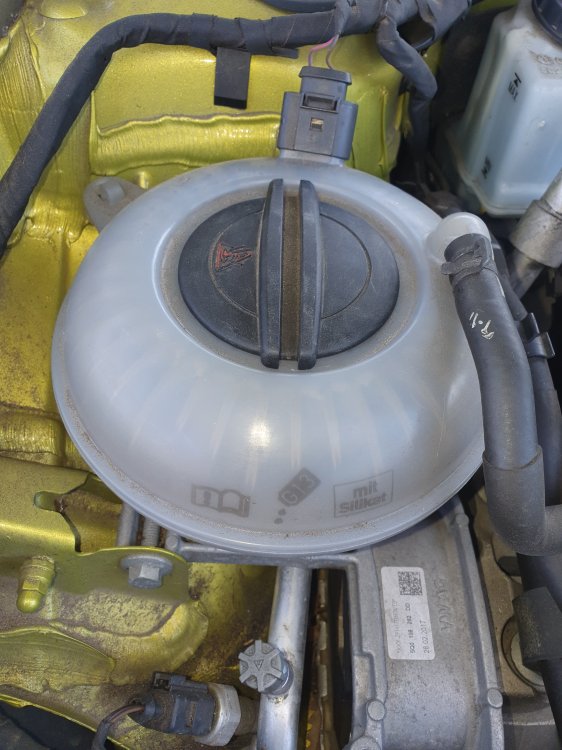

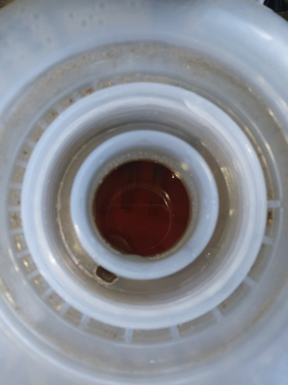

Hi don't know if this has been asked before so here goes my coolant expansion tank looks a little crappy inside although there's no bits or sediment inside i don't know the cars history the coolant still pink but I've noticed when engine is cold and when i top up the coolant lid is a pig to unscrew and a pig to tighten until it clicks I'm wondering if it's worth changing the tank for a new one i haven't used much coolant maybe 400ml over 11 months I know they're not the best pics
Get a new one.

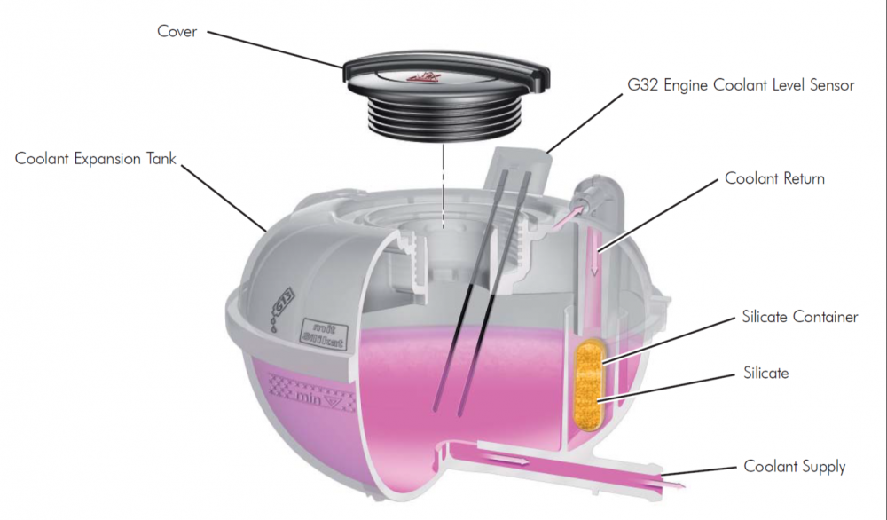

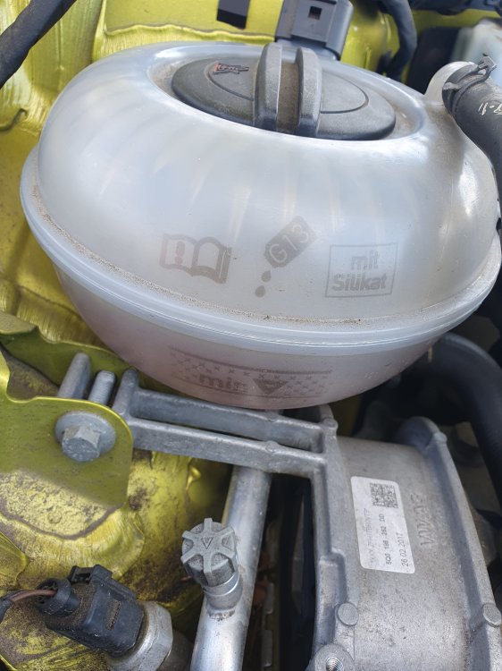

This says Mit Silikat on the side and so it has a silica bag inside, which is designed to aid the life of the coolant, but eventually breaks down and blocks the cooling system.
Whilst you don’t want it to be urgent, if the header tank looks like it’s had a fair innings and your cooling system is working ok (I think you notice a lack of hot air when things go wrong) then I’d say you’re possibly getting towards being on borrowed time on this.
Thanks and what's the part number for this i've seen so many but don't want cheap nasty or second hand tanks i want original new parts and probably get the system flushed

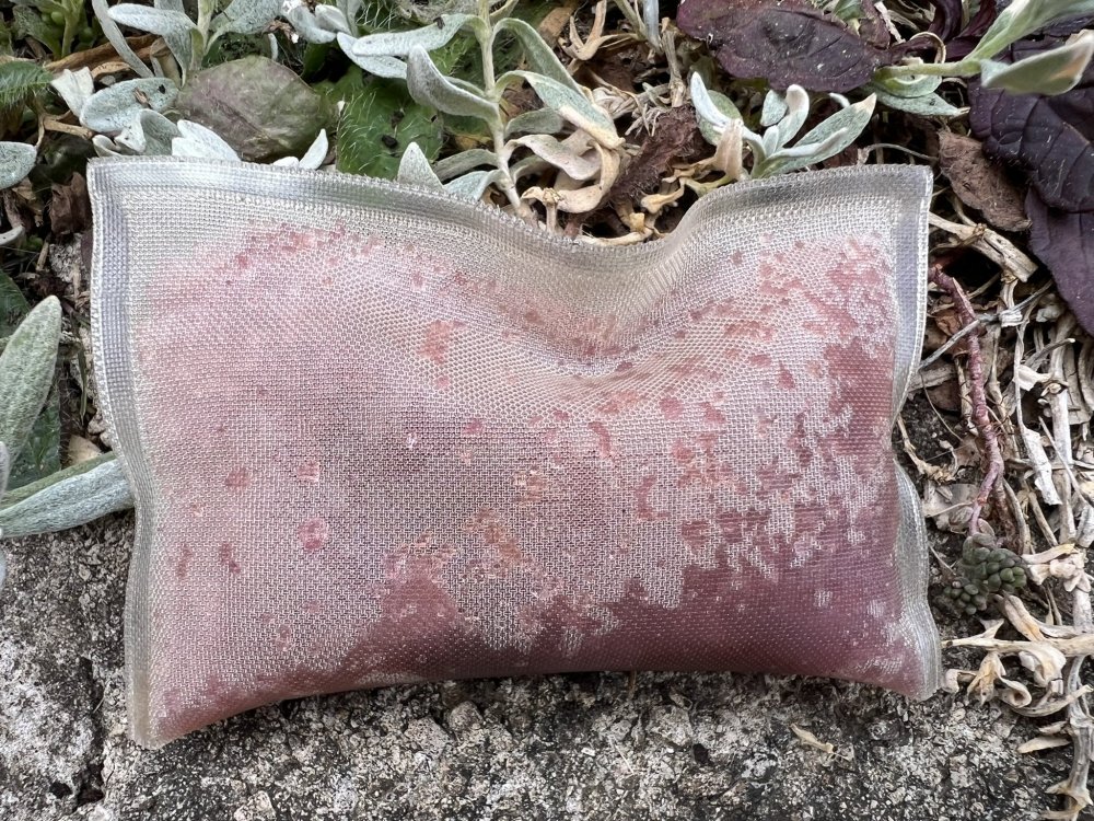

Result 30 seconds and a couple of smelly coolant fingers later ! 😄
I used long tweezers, the end result was the same but without the smelly digits.😁
