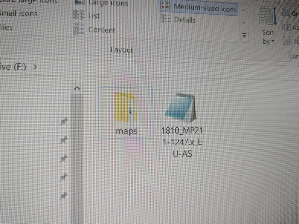

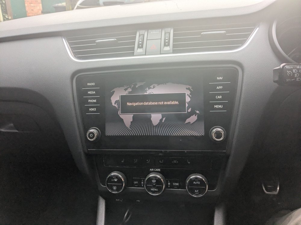

Iam having a similar issue, I downloaded latest maps on a zip file from skoda website and put them on a new SD card to keep the original. But that did not work as read on here that need to use the original skoda sd card.
So i deleted and then replaced the maps folder on the skoda sd card with the downloaded one leaving the other file in place. See first pic but still does not work as unit does not recognise SD card 1.
Any ideas

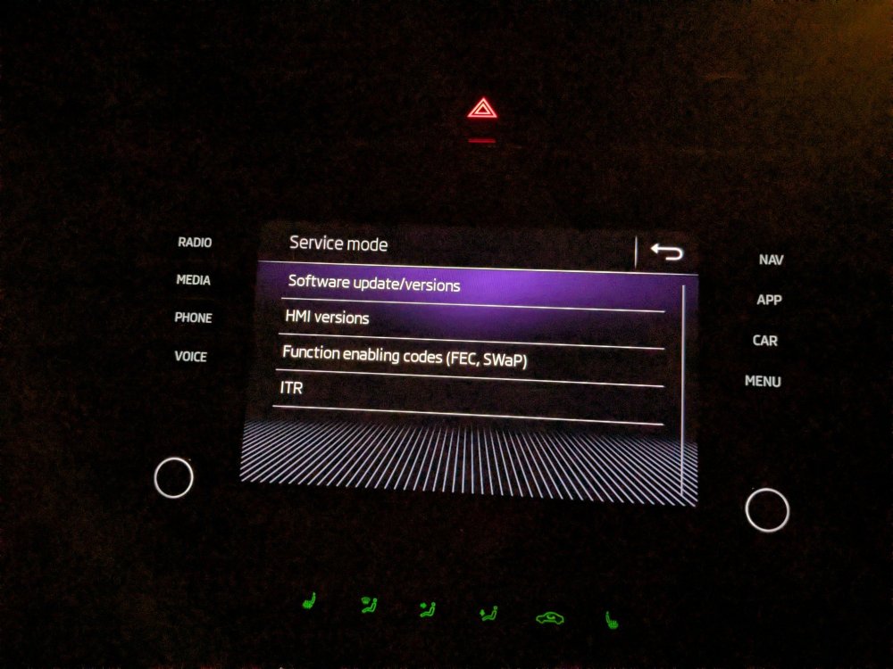

Start mib in Green Mode, then ToolBox, then Navigation, then Patch SD config
Not a clue what green mode is so had to google it. Held menu button for 10 secs and got this menu but no toolbox option.
You have Tool Box installed? Engineer Mode Activ?
