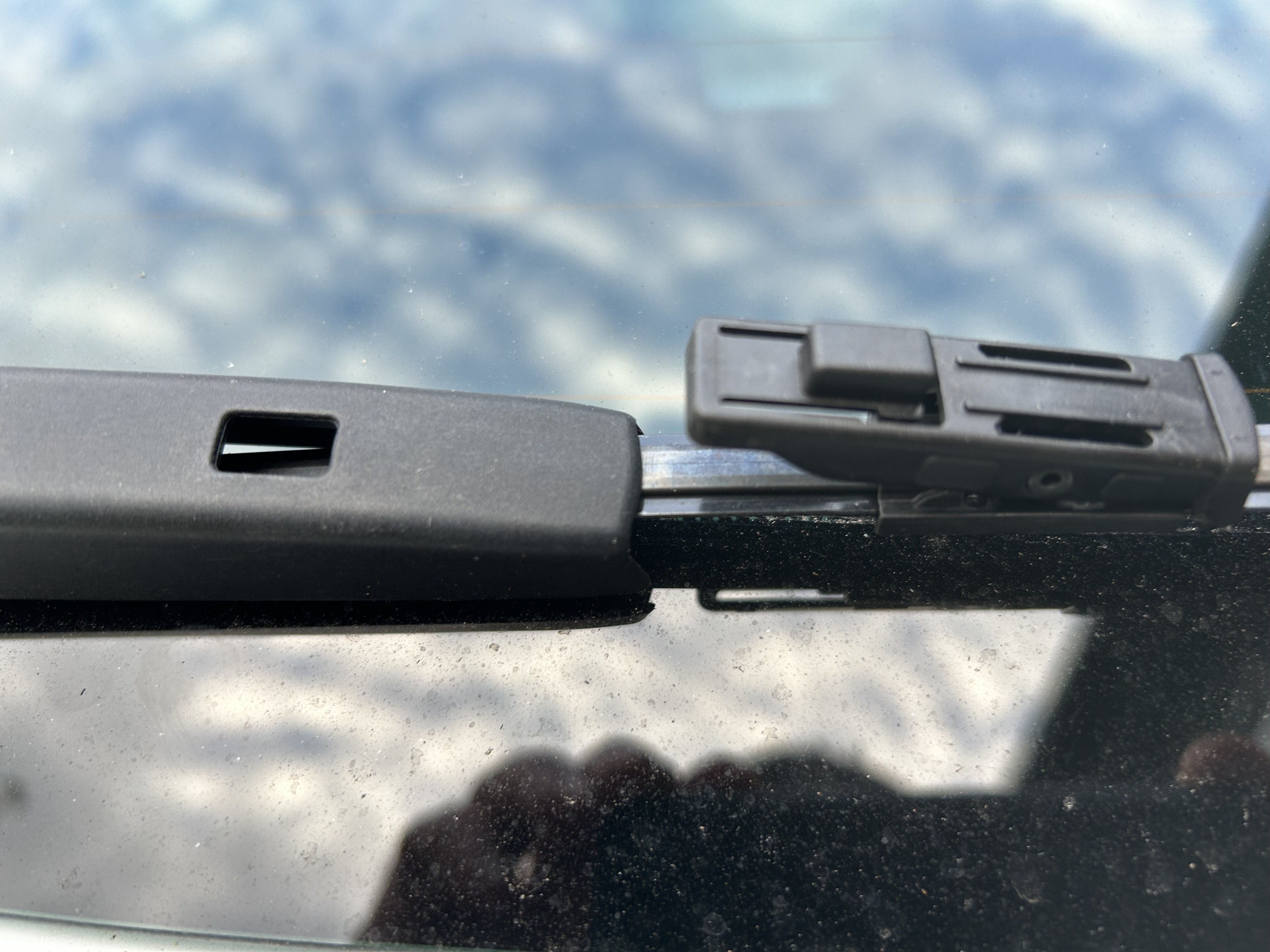

IMG_6768.jpegThis what the rear blade looks like
Yes thats what is on mine thanks for this very helpful

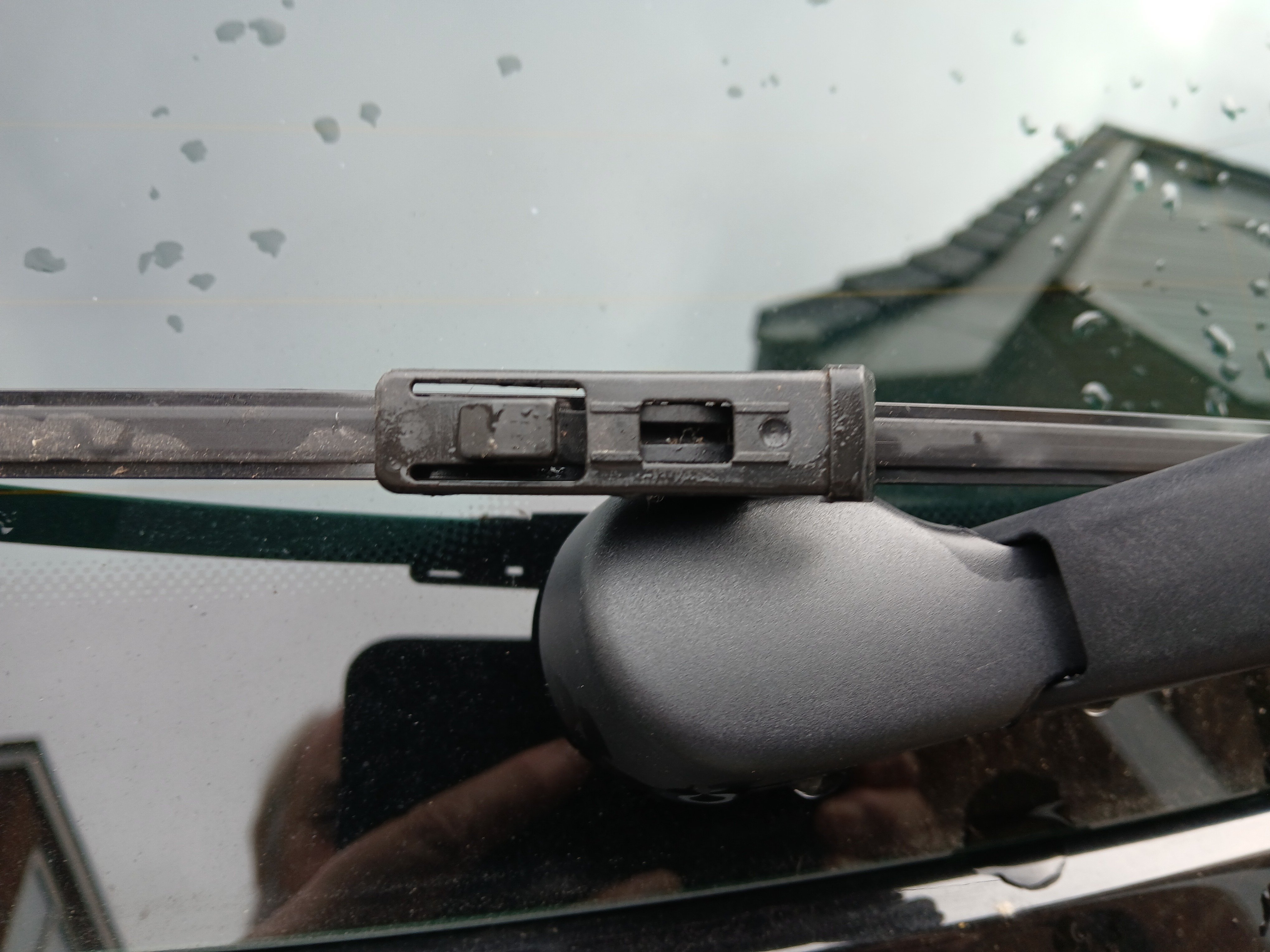

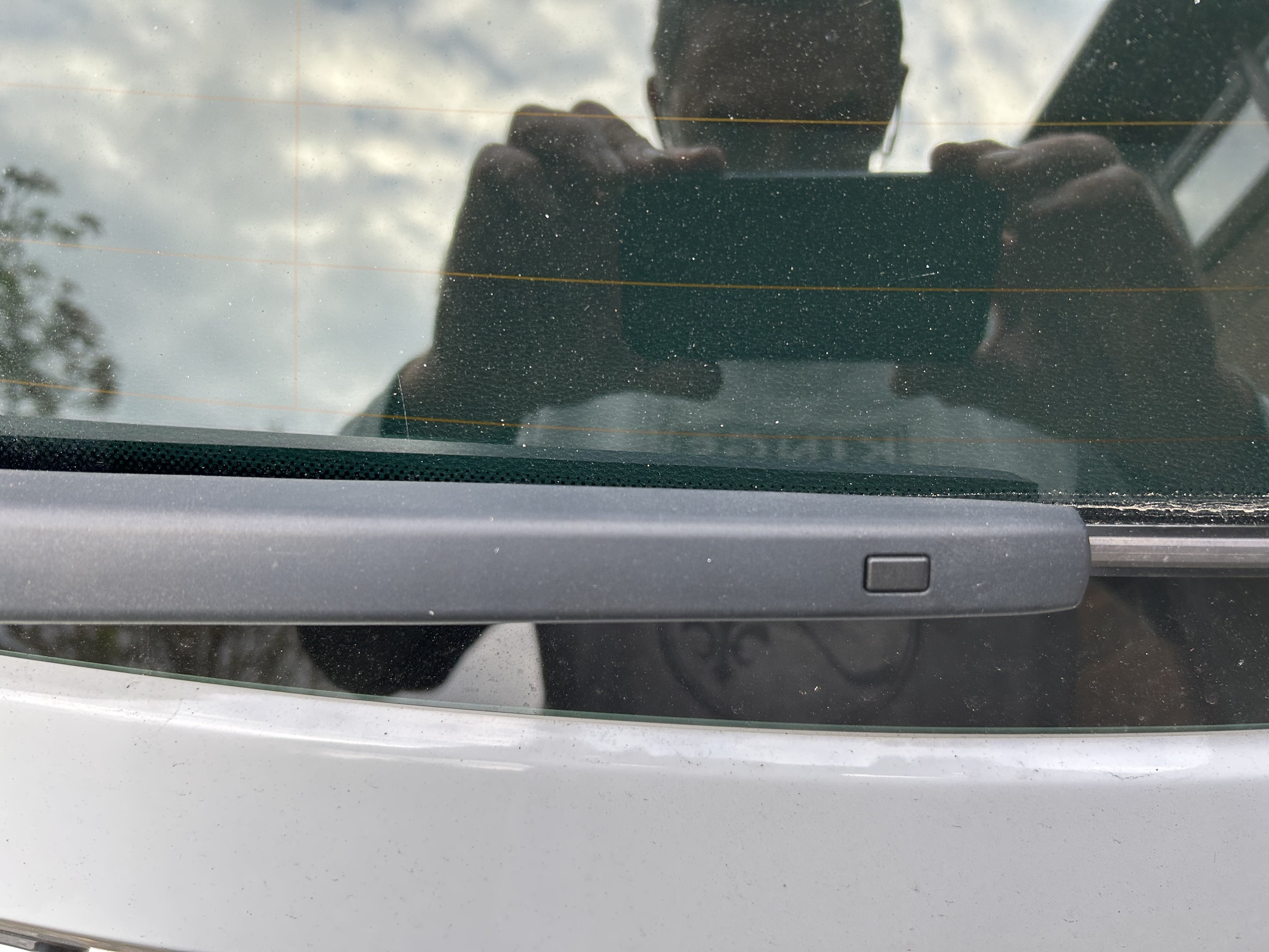

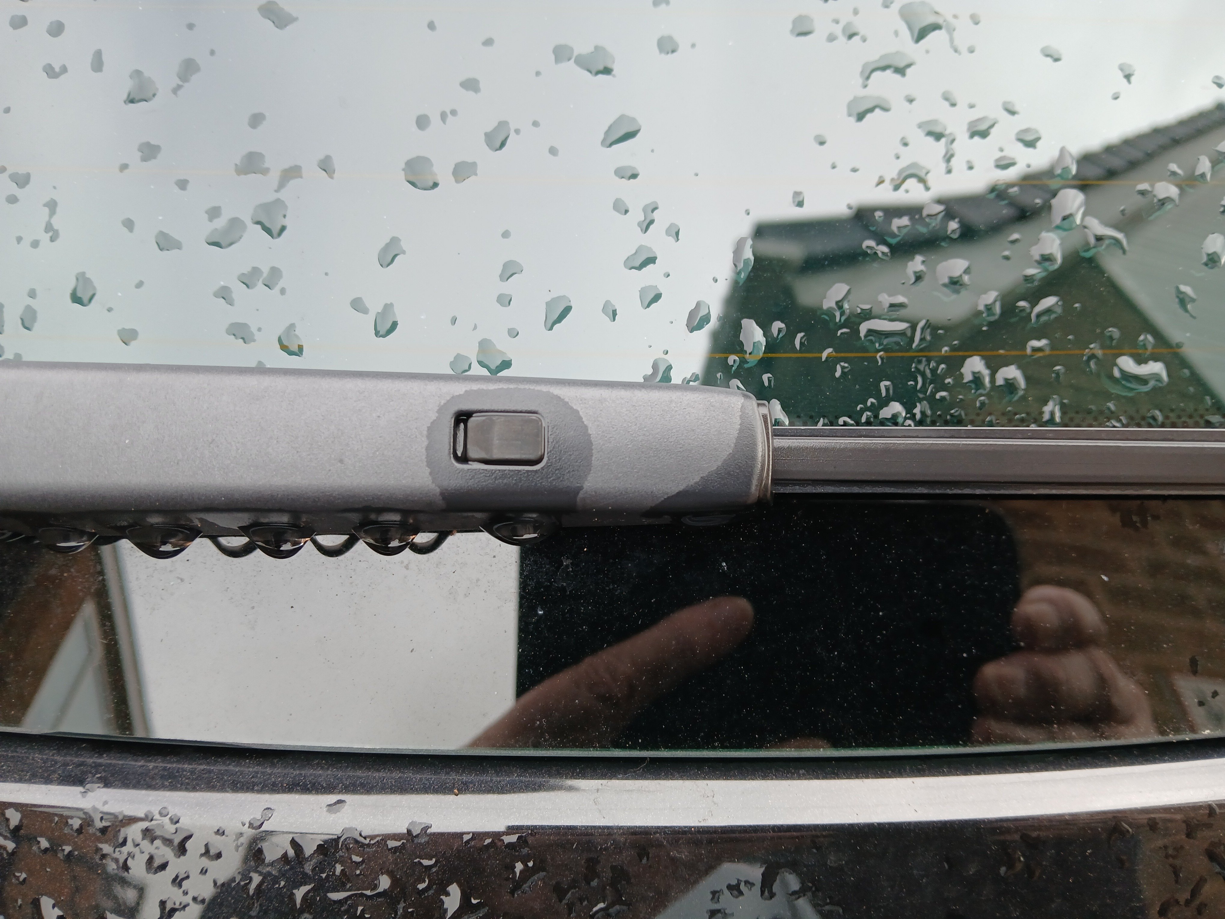

@Piescoffer attached photos of my wiper arm and blade. You might want to read through this thread https://www.briskoda.net/forums/topic/517703-correct-rear-wiper-for-karoq-sportline-2023/
Although most supplier reference data seems to think the change happened in 2023 it seems it actually happened earlier ( maybe 2021 ? )

edit: just looking at this other thread https://www.briskoda.net/forums/topic/523328-wiper-blades/#comment-5857130
There's a photo of the two blades together , the A335H above and the A331H below
Hope that helps
