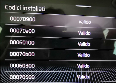

As far as I know, FECs/SWAPs are enabled only with packages purchased during the car's construction or enabled at the dealership in the case of 0071C during an official Skoda recall. Illegal activations are now available. In fact, updates are only activated if the FECs are in "legal" local mode.

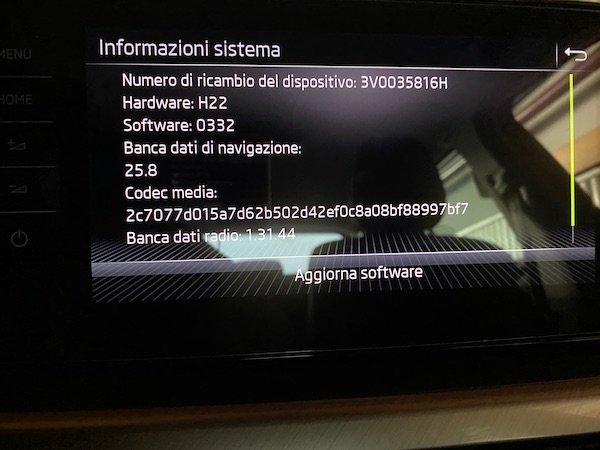

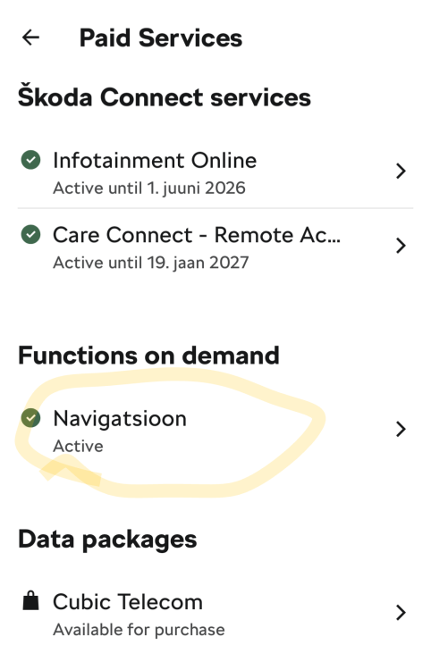

I purchased navigation rights from Škoda Connect Online web shop. I have heard that in dealership, after the software is updated, they synconize all the software FAC/SWAP codes with škoda server.
I am afraid that in self upgrade process, this additional purchase will be lost. And if I then want to purchase/update the subscription, online shop will say that you allready have purchased it....

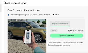

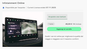

THIS???
Edited by GiscoYeti
OR This

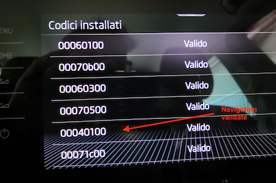

You need to check in the engineer menu whether FEC is active. I know that in Audi MY24 models you can purchase the navigation license online, but I don't think this is possible in Skoda models as they come with navigation as standard. I'm sorry I can't be of more help. You'll need to contact your dealer.
