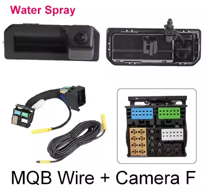

I sent you PM with VIN request so I can check part number of your current traunk handle and let you know which camera to order.
You car was manufactured in 2016 but it's MY17. Your trunk handle part number is 6V0827566. OEM part number of trunk handle with reverse camera is 6V0827566G so from the link you sent you need model F:

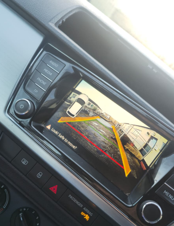

i been using this device a bit. water spalsh and fog seems to be a problem somehow. but i wipe it off and everything is fine. 7/10 i would say. dont know how to fix this only issue. picture quality is also 7/10 and the Dynamic Trajectory works well with space the the one site when u parking

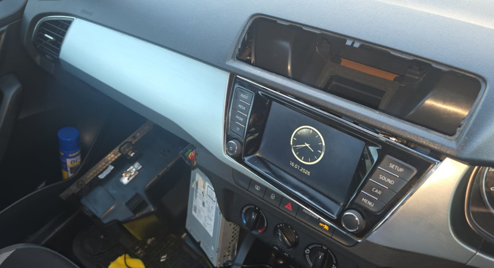

UPDATE: the reversing camera installed without a hitch, and the only issue was threading the cable up the rear metal channel next to the rear screen. Sorted with a coat hanger and electrical tape on the tip.
Shims cut from a plastic card to poke in the palstic clips to release the rear handle. Plectrums would work too but strips better.
Cable threaded underneath the side airbags, properly so that safety not compromised.
MIB2 unit was a tricky sod to remove until I realised the DIN removal keys were used for the DIN unit too. THey were fiddly to get out once locked in but with a squeeze it all worked.
Anyway, THUMBS UP for the SinoSmart reversing camera kit, 560GBP saved!
