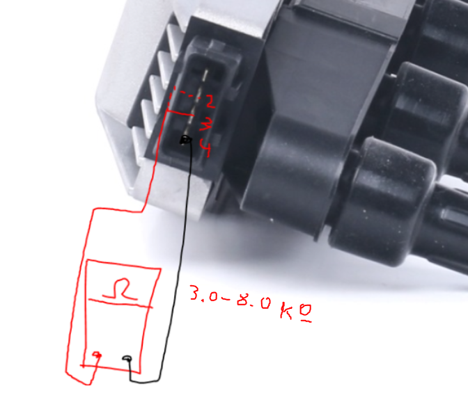

Check the coilpack please. Easy enough to do, there is the possibility of a loose solder joint or the planned obsolescence flyback diodes failing, shorting one pair of cylinders and not being able to fire
2x5mm allen and 10 minutes
You can perform an electrical check in situ by measuring with a multimeter as such

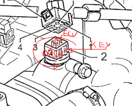

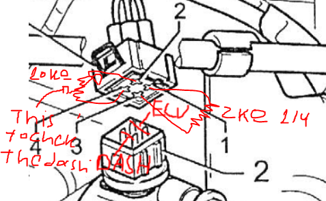

yep we can, but its not a guarantee someone will have not installed the sensor rotated, the ref should be with the plug key
Sorry, the sensor itself can only go in one way, so I assume you refer to when you connect the female cap to the sensor body? If so, how to know the right way round, when connecting the cap?
Will do
No, @D.FYLAKTOS said we should orinent ourselves in reference to the firewall, which is subject to the clocking of the sensor itself, since its held by a D clip and an oring it can be rotated 360deg meaning that pins 1-3 and 2-4 will not always be on the same side, infact the can be in any direction, that is why we have to reference ourselves from the key that is used for aliging the plug to the sensor.
So there is an alignment channel on the cap, that aligns with an alignment key on the sensor body connection? Then how could it be fitted incorrectly?
Its just wires, they can be rotated and the next guy will just twist the plug to align it with the socket I aint saying that it is connected incorrectly as you are right this cannot happen I am saying you have to pay attention to which set of actuall pins you are measuring
