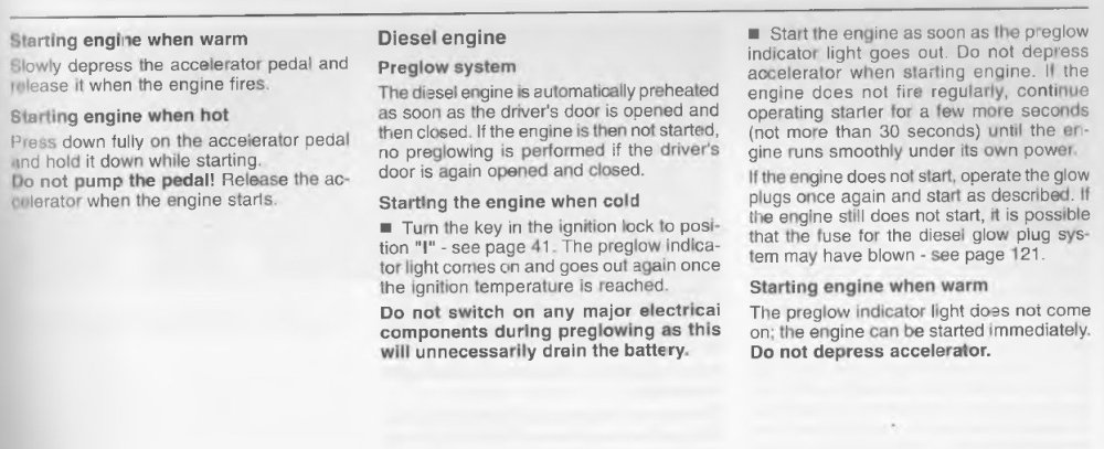

    I do this for 20+ years, the gear stick in N and the pedal pressed, reduces the initial ''load'' for the engine to start in cold. @TonyW1967 When you turn the key to the 1st as i saw twice that you
  • It sounds like it's running on two, or even one cylinder. It may be the ignition module, mine was more sensitive to moisture, probably because of cracked insulation. But it can also be just flooded, I
  • D.FYLAKTOS
    D.FYLAKTOS
    Update: I just remembered another 2 times that i was in a hurry and didn't follow the proper procedure. After 5-6 hours that my Felicia was parked (low level, underground parking) i want to move it cl

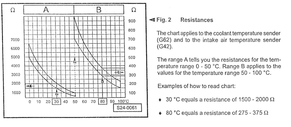

A coolant sensor with debris on it or with damaged cables (both have happened to me) does not make the light bulb to turn on.
A faulty sensor can make the cluster gauge to show''fake'' results for the coolant temperature and make the needle to go up-down unpredictably (also happened to me) .
Not to mention that it feeds the ECU with OL where being an NTC thermistor makes the ECU think it's -50C and it causes it to run super rich and flood.

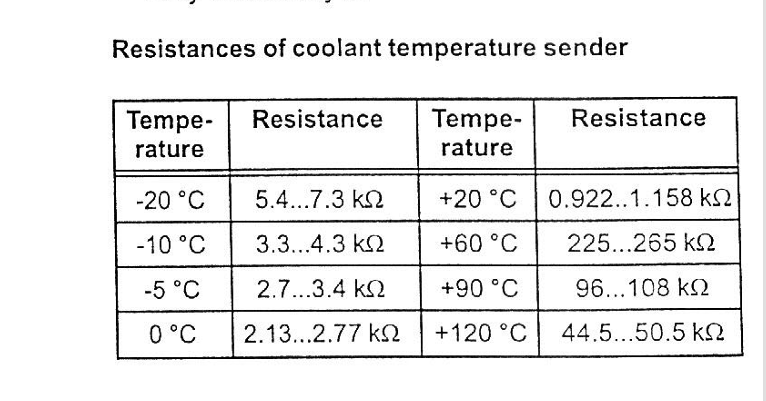

This is for you to test. There are two lines cause this is the tolerance zone, so as you can imagine, if it OL, it aint that good
And this is the NTC element responsible for the dashboard. Note they made a mistake, and in cells 60C 90C 120C it should be Ω and not kΩ
Edited by Thefeliciahacker
For GR the O 'C measurement can be achieved.

I wonder, what the indications could be in a Summer day with 18 'C for example?

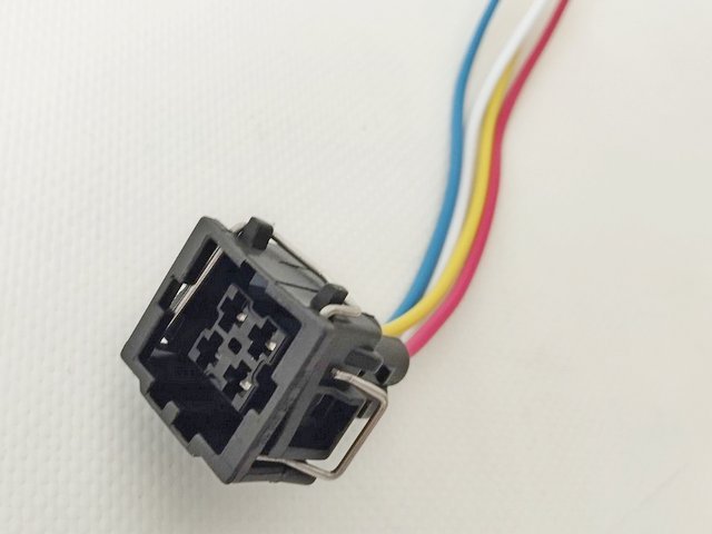

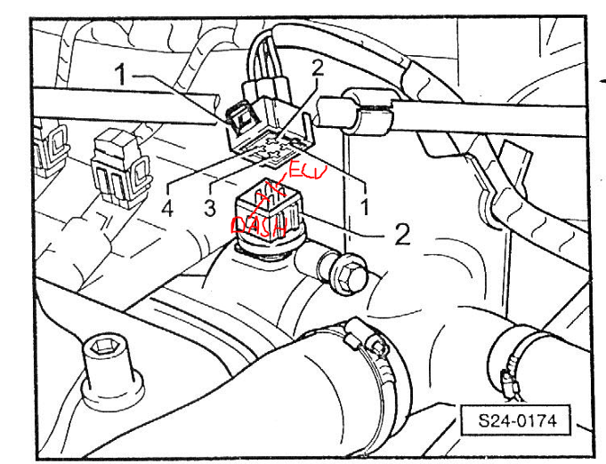

The part code is 357919754 but we measure in the pins (male) or in the other side (female, on the coolant switch) ?
On 04/01/2026 at 21:43, Thefeliciahacker said:
we measure the ECTS so the thermistor (the sensor)
It should be around 1.8kΩ for the dash and 2.8kΩ for the ecu
