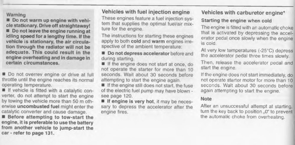

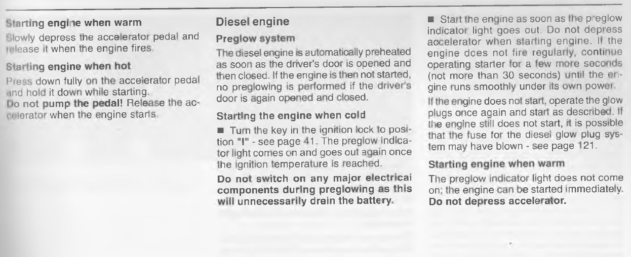

On 08/01/2026 at 12:12, Thefeliciahacker said:
If I don't let it prime it will just crank for longer, but keep in mind my fuel pump is dying
I found this in the owner's manual
Edited by TonyW1967
