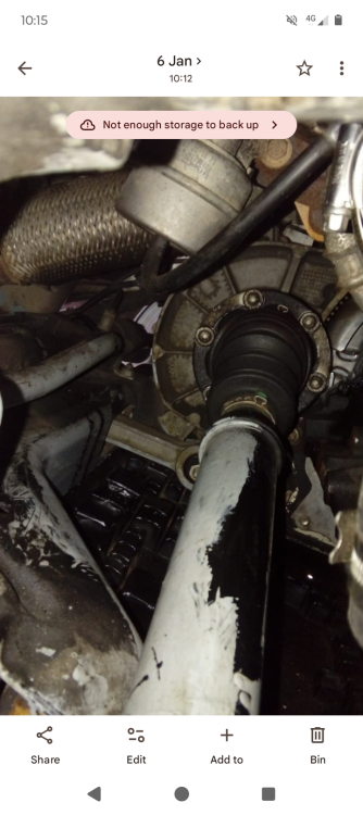

Garage replaced flywheel , clutch some years ago and left two of the bolts on inner driveshaft loose, leaking only cv joint grease, so I'm guessing it is a not, but I thought I'd be prepared.

The driveshaft flange bolts are there like on other side. I count x6 spline bolts.
Looks like my sons. From memory the drive shaft comes out complete once the hub and the 6 bolts are removed. On his there was no seal as the flange/seal remains in Gbox so no oil leakage. You are supposed to renew the 6 bolts and hub nut. I reused the 6 bolts but put some thread lock on them. Hub nut is use once and throw away. The bolts are vw triple square spline. Not sure if you will get away without removing track rod end but if its just the ball joint bolt I reckon it will go back in the same position.
