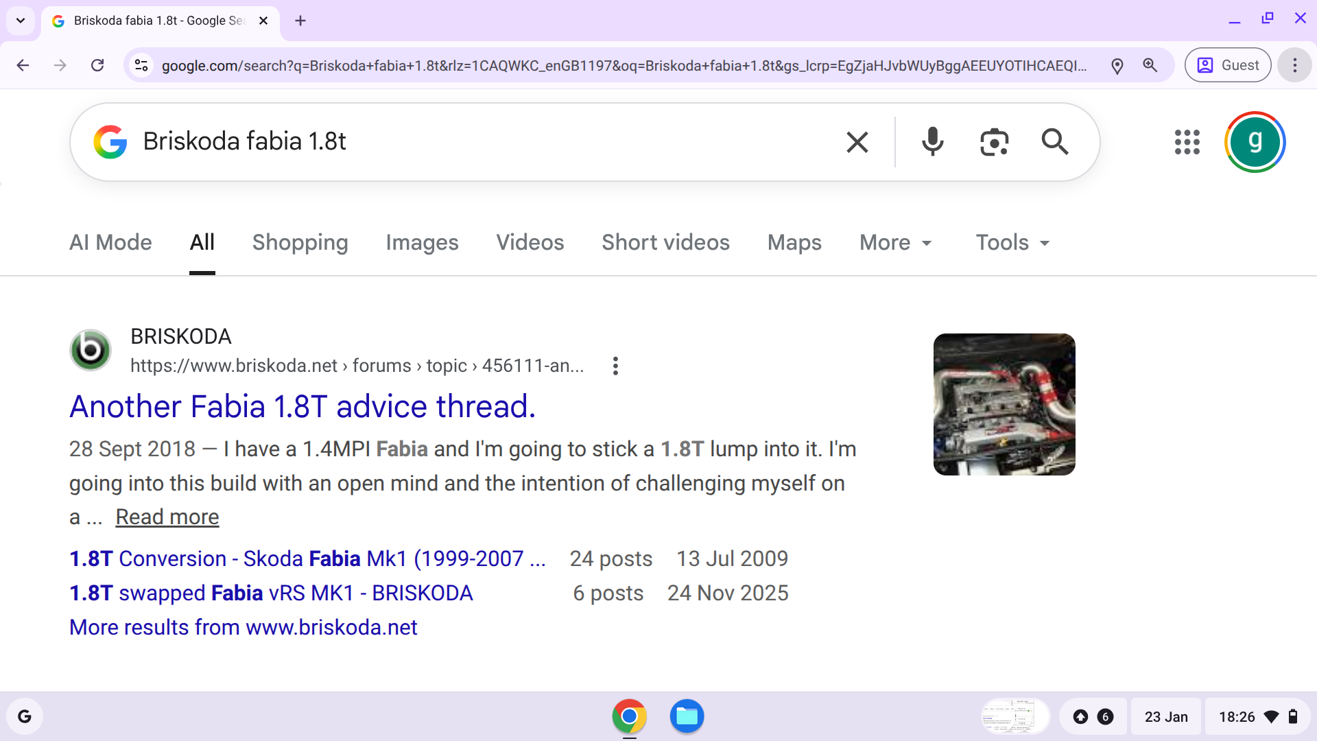

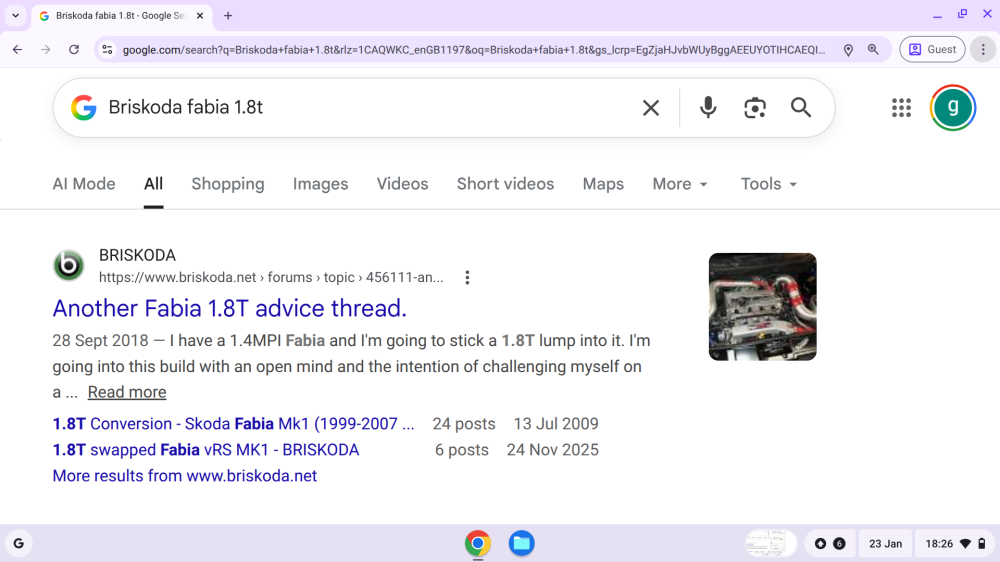

Try looking at these threads if not already done so.
