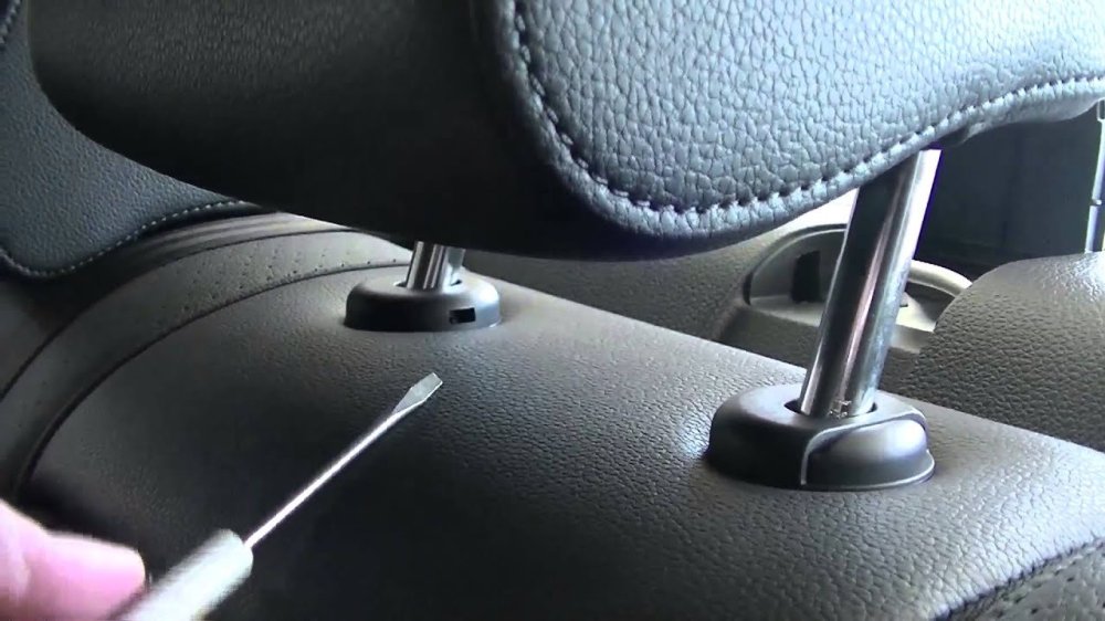

Evening, I need to fit some screen holders on the front headrests, they basically sit on the 2 rods. I can't see how to remove the headrests to do this. There is a button which lets me raise and lower them, is there some sort of catch I need to press to let me remove them?
Thanks in advance.
Skoda Superb, 2018, L&K trim.
There’s another catch on each of the stalks accessible by pressing the seat upholstery down around the retaining clips……..
