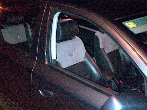

Finally I've fit Combi RS seats on my Trend Hatch.
Front fits perfect.
Rear fits perfect (both are "folding" ones)
Fixed part on rear wheel arch fits ok, but not 100%, because there's a small space between cushion and wheel arch on the top. You can see some wires through this. Not a big headache for me. Maybe clips should be adjusted a bit more.
