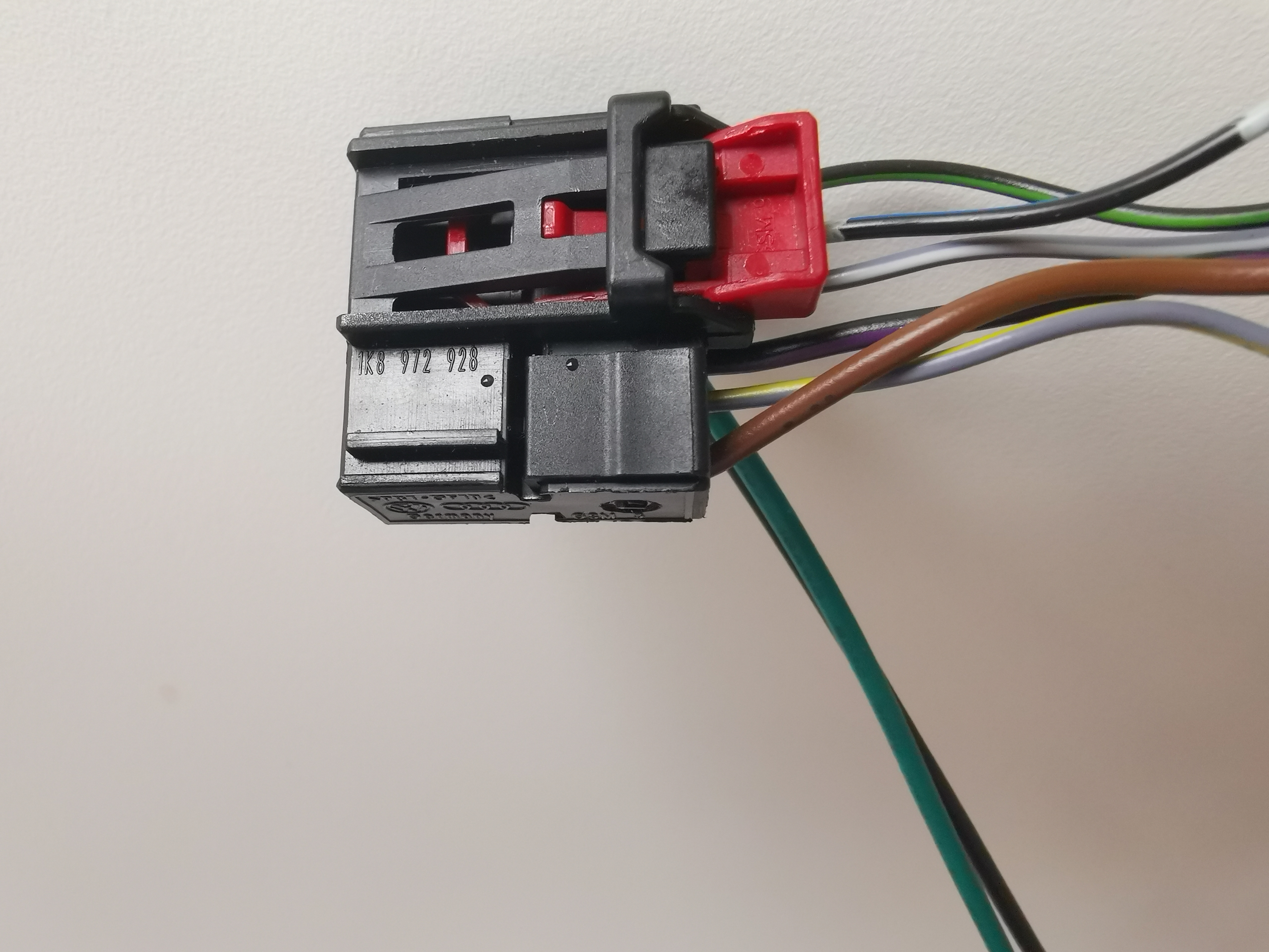

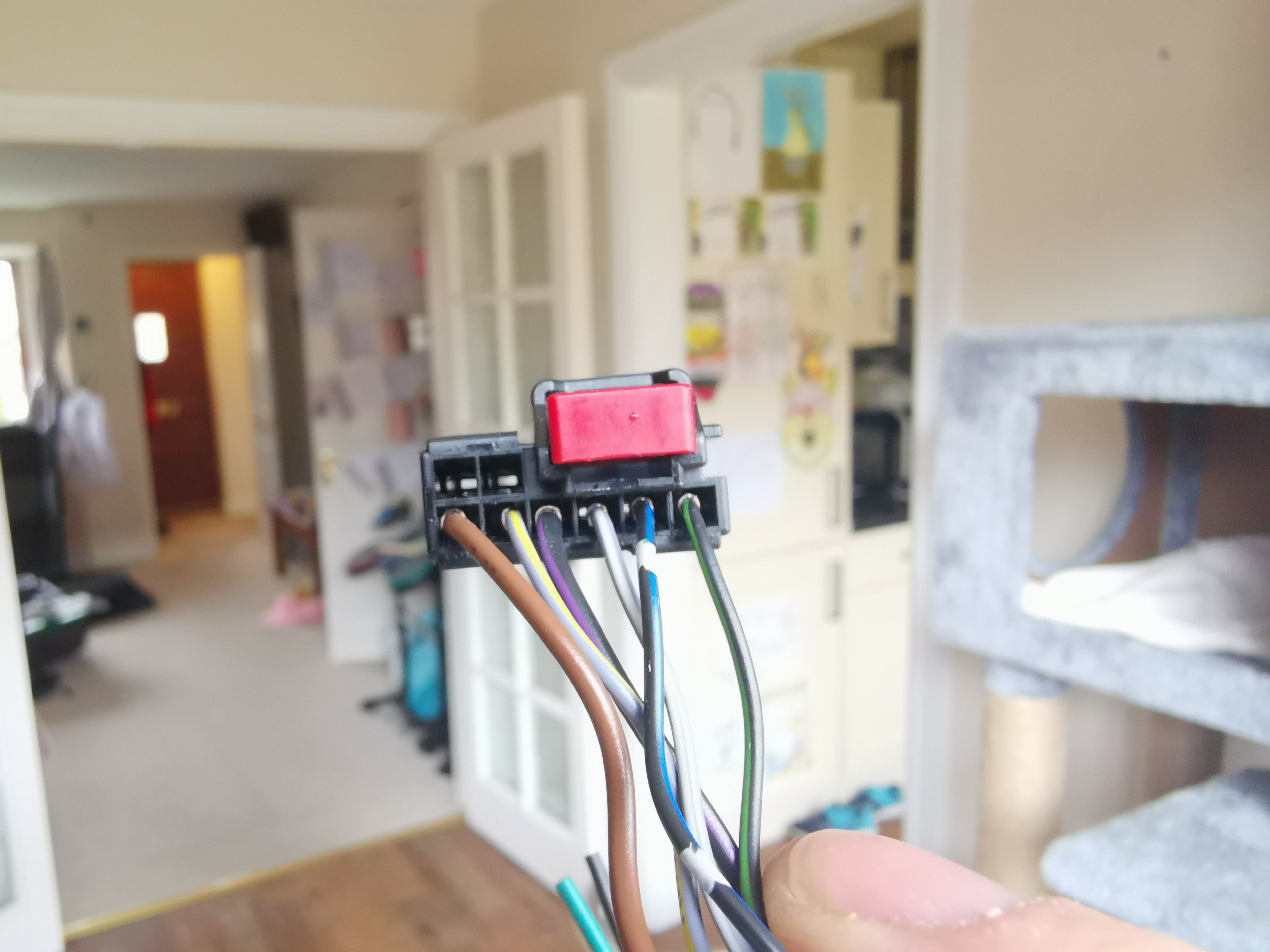

Will have it finished tomorrow, as you can see the original car's harness is left untouched with my homemade wiring harness adapters- Picture needed of wires that go into back of facelift outer rear light
never mind, I got the connector from a volkswagen scirocco, so I paid for Volkswagen ETKA access for an hour and was able to 'reverse engineer' the pin assignments.- Picture needed of wires that go into back of facelift outer rear light

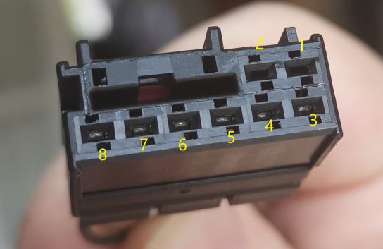

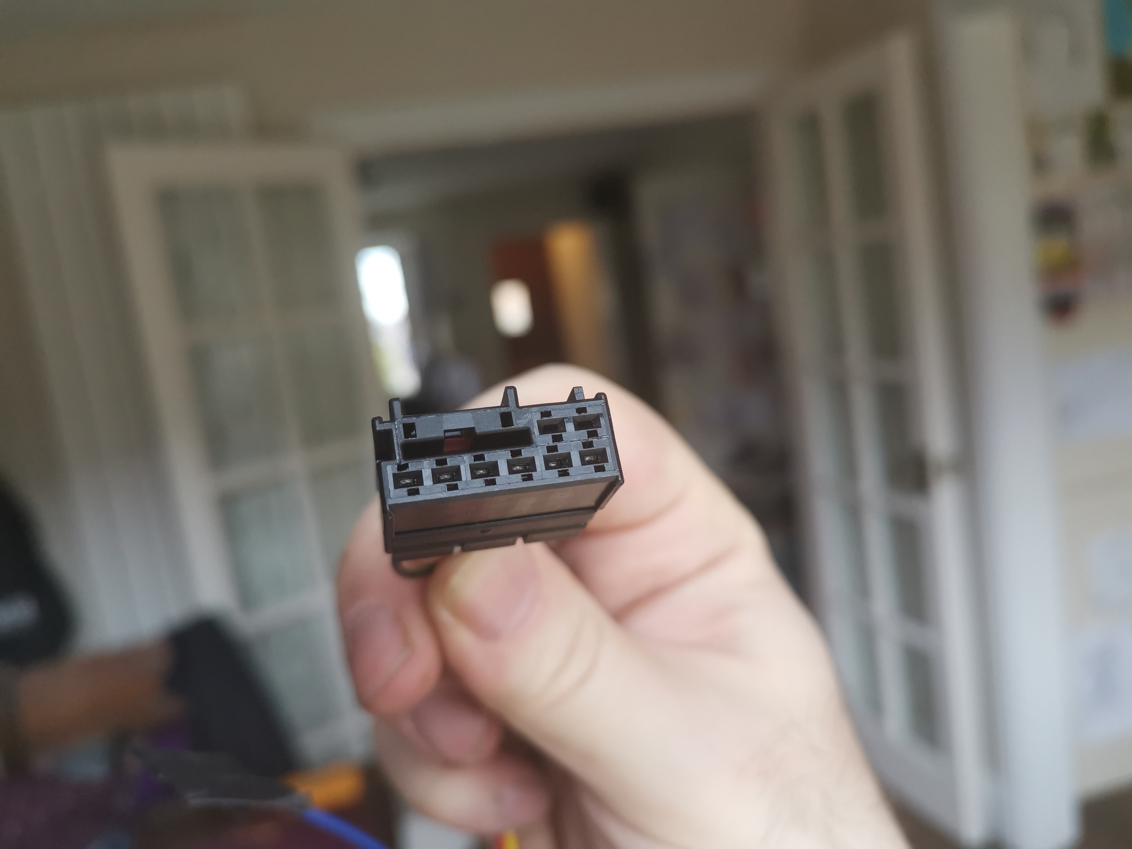

Long shot but I'll ask anyway.. big favour needed if you happen to have a facelift, and are comfortable removing a rear outercluster - would you mind providing a picture of the wires that go into one of your outer cluster lights? I'm doing a wiring job, but the connectors have no numbers on the pins, and I can't find any published diagram showing which pin is which on this connector. I'd just need to know If the car is left hand drive or right hand drive, and whether your photo is on drivers side or passenger side. Would be a huge huge help. The connector will look like this- TV Tuner in Superb Mk3 Retrofit?
A - TV tuner -R78- B - 12-pin connector, at wiring harness - T12b C - 2-pin connector, at wiring harness - T2k- TV Tuner in Superb Mk3 Retrofit?
