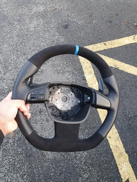

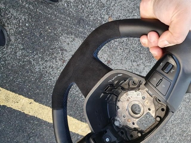

or 4 grand Porsche wheels on a clapped out stance'd golf. In terms of upgrades, There's many across the skoda range available.....Its who you know that could do the coding and the cost.
