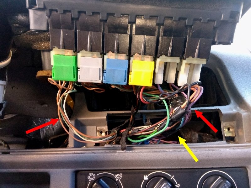

Lot of electrical issues. Have you run an error test with VSDS or a similar tool? Have you check the connections in the right lever on steering wheel column? The bulbs for the reverse are OK?

Mine was much-much worst not only in the MAP but also in the 2 plugs of the ECU. A thoroughly cleaning and a contact cleaner spray or electrical grease is a ''must''.

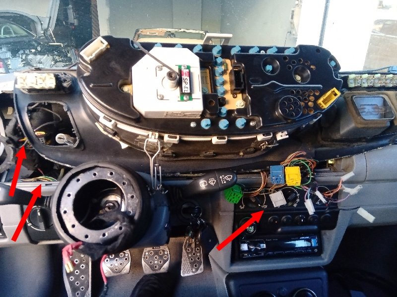

- felicia facia panel removal
D.FYLAKTOS replied to jonnycilia's topic in Skoda Favorit, Skoda Felicia, Skoda Fun and Skoda FormanFor the one who will make the attempt to remopve the whole dashboard here are some ''sneaky'' screws. Here is something that i have done many years ago, i removed the glove box cover, fill it in inside with noise insulation layer (was hollow) and replaced some screws.- coolant temperature sensor

Neither the majority of every day drivers, that's for a mechanic. He also use a gauge tester like this https://www.apexinds.com/mm5/graphics/00000001/atcltu32-20_640x640.jpg to check if you have fuel pressure and your injections status. Engine start spray. - felicia facia panel removal
