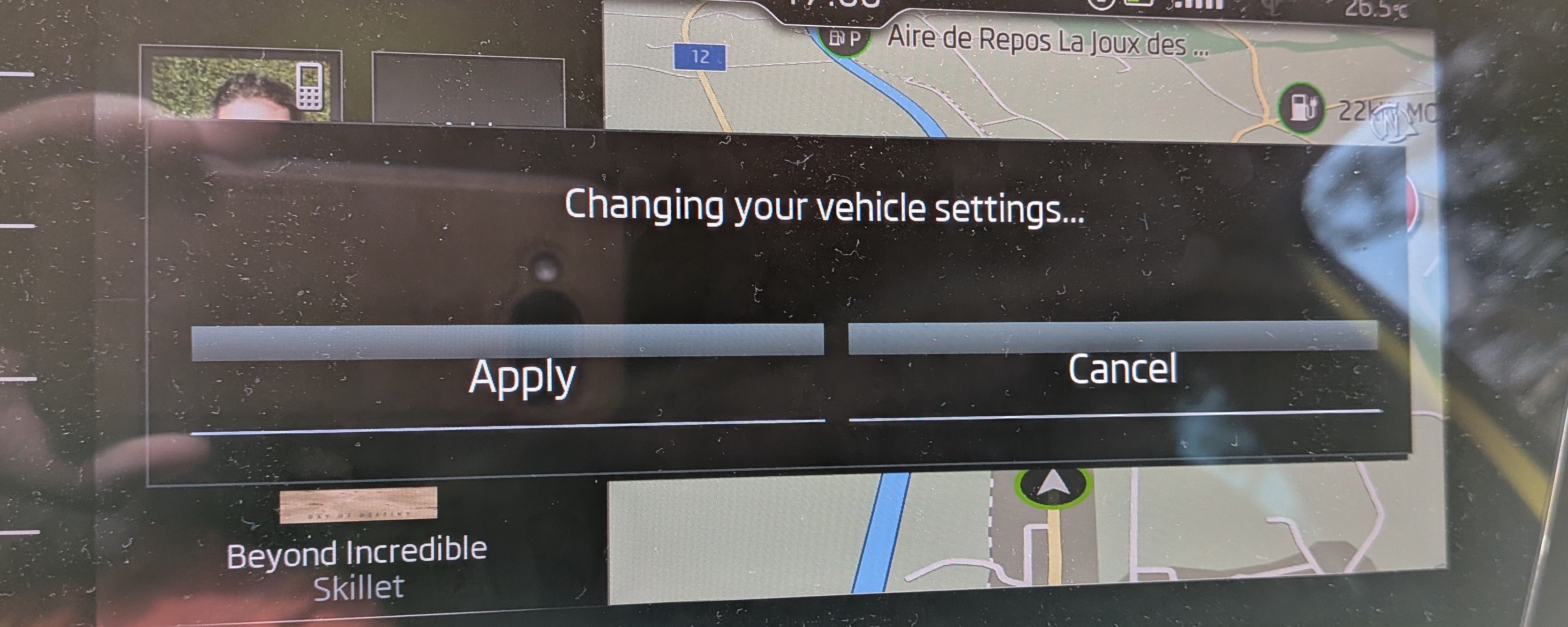

  7. Basically the same for me. Originally I kept saying cancel but until you accept you get the same popup every morning and evening you get it the car.
  8. My car is the last of the mk3s so less than 2 years old with 1+ year for the OTA updates so I assume it's the latest version... I'm the only person using the car so the profile doesn't change. Edit.... I checked and it is: Hardware H25 Software 0330 Nav DB 25.8 It's showing no updates available
  9. This is an image of the message:
  10. Infrequently, I get this popup on my infotainment display saying "Update Vehicle Settings" Apply/Cancel... I've not changed anything in the My Skoda app and not seen any SW updates. If I say cancel, I'll get the same request the next day and the next. Does anyone know what "settings" are being changed? Gabbo

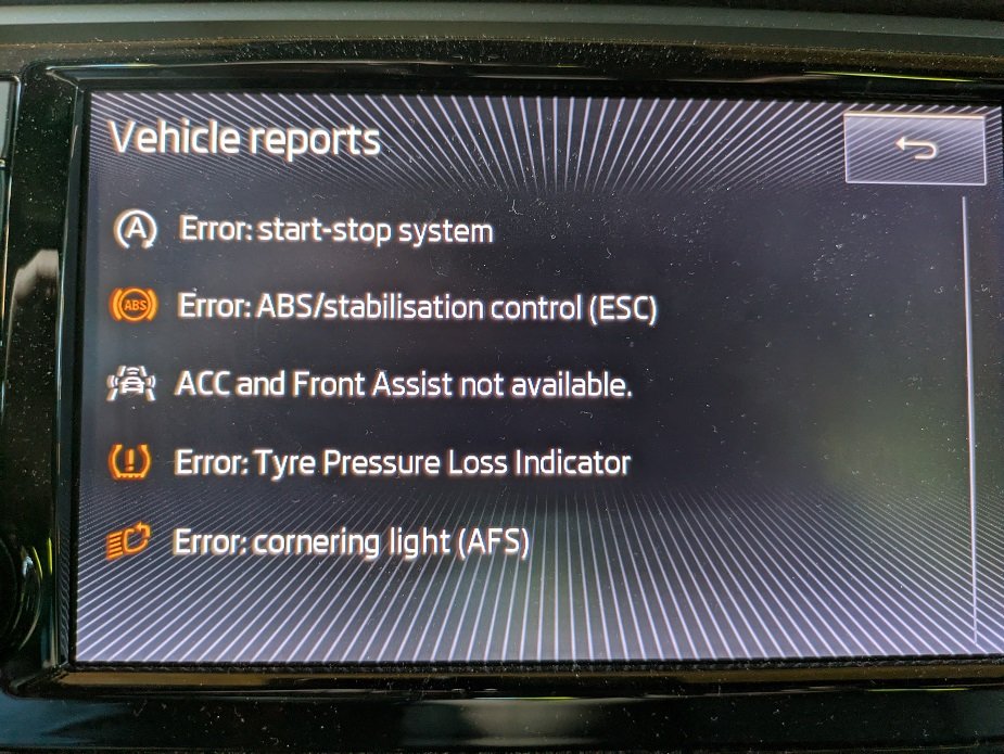

  23. If you have that warnings there should be several DTCs in lots of different control modules. I had a similar problem on my Octavia recently which turned out to be 1 ABS sensor fault. I have a Bluetooth OBD dongle ans the free version of car scanner for Android. This tool did not report any DTCs from the ABS module despite 7 other errors in different modules. To determine which ABS sensor might be at fault you can monitor the wheel speed. The one that stays at 0 or is different to the others is not good. There's more info here: https://www.briskoda.net/forums/topic/533111-rear-wheel-speed-sensors-are-they-the-same/
  24. I've just had the same issue in my Octavia & the issue was the left rear wheel speed sensor. A code reader is useful to help pinpoint the problem. I was lucky the the problem was just the sensor. The magnetic ring is built into the hub and can also often be the cause. I uploaded a post about it here:
  25. In case it helps others who have a similar error, I was using Car Scanner to diagnose the failure & it doesnt read DTCs from the ABS module (which is where you'll find the helpful DTC saying "Rear Left Wheel Speed Sensor Electrical Error". I had about 12 other DTCs from various modules saying "U1123 - Databus Message Missing" which is a bit misleading. The message is not missing just not plausible. The one DTC description which got me onto the cause was the "WheelPulseFail", "WheelImpulse" and "ESP_19: Fehlerwert im signal ESP_HL_Radgeschw" HL Radgeschw is german for "Rear Left WheelSpeed". I will attach the complete log of failures as it could help someone in the future: Car Scanner ELM OBD2 Version: 1.118.0/401180/GP DTC report Connection profile: Skoda MQB, PQ26: Diesel DPF var.1 [EA288]Date: 6/19/2025 12:51:45 PM VIN: xxxxxxxxxxxxxxxxxxxxxxxxxx OBD-II No DTC found. 19. CAN Gateway No DTC found. 09. Onboard supply control unit No DTC found. 02. Transmission control unit No DTC found. 03. ABS control unit No DTC found. 01. Engine control unit01. Engine control unit DTCs: 1 17158 [0x004306] U112300: Databus error value received U041600: Invalid Data Received From Vehicle Dynamics Control Module Status bits: 1 Priority: 6 Frequency: 1 Unlearning index: 255 Odometer: 232050 km Date, time: 2025.06.18 20:54:35 Engine RPM: 1223 rpm Calculated engine load value: 87.45 % Vehicle speed: 45 km/h Engine coolant temperature: 86 ℃ Engine oil temperature: 84 ℃ Barometric pressure: 94 kPa Klemme 30 voltage: 13 Paramteric values: 20 96 28 17 E0 00 00 17 DD 05 17 DE 00 00 11 87 00 46 Status: Pending, Test failed since last DTC clear 04. Power steering04. Power steering DTCs: 2 19716 [0x004D04] Archive (inactive) U112300: Databus error value received ESP_10 Botschaft - SNA-Check Status bits: 1 Priority: 6 Frequency: 255 Unlearning index: 137 Odometer: 232050 km Date, time: 2025.06.18 20:54:35 Paramteric values: 2C 35 72 4D 00 04 21 72 78 00 00 03 56 02 17 00 00 00 Status: Confirmed 20228 [0x004F04] Archive (inactive) U112300: Databus error value received ESP_19 Botschaft - SNA-Check Status bits: 1 Priority: 6 Frequency: 255 Unlearning index: 137 Odometer: 232050 km Date, time: 2025.06.18 20:54:35 Paramteric values: 2C 35 72 4F 00 04 21 72 78 00 00 03 4C 02 11 00 00 00 Status: Confirmed 05. Authorization system for access and starting the engine No DTC found. 06. Front passenger seat No DTC found. 07. Head unit controller (VW TP2.0) No DTC found. 08. Heater and climate No DTC found. 0D. Slide Door Left (VW TP2.0) No DTC found. 0E. Media player 1 No DTC found. 0F. Digital radio tuner (VW TP2.0) No DTC found. 10. Parking Assistant 210. Parking Assistant 2 DTCs: 1 13637426 [0xD01732] Archive (inactive) U112300: Databus error value received ESP - ESP_21.ESP_Systemstatus - Fehlerspeicher auslesen Status bits: 1 Priority: 6 Frequency: 1 Unlearning index: 137 Odometer: 232050 km Date, time: 2025.06.18 20:54:35 Status: Confirmed 11. Engine Electronics No. 2 No DTC found. 13. Active cruise control13. Active cruise control DTCs: 7 01067 [0x00042B] Archive (inactive) U112100: Databus missing message FAULT_TIMEOUT_MOTOR_20 C10DF00: Brake temperature FAULT_CIS_BRKOVHT_FAIL Status bits: 1 Priority: 6 Frequency: 1 Unlearning index: 137 Odometer: 232050 km Date, time: 2025.06.18 20:54:31 Paramteric values: 02 8D 00 26 02 85 83 10 16 0C 02 10 0F 00 00 Status: Confirmed 01058 [0x000422] Archive (inactive) U112100: Databus missing message FAULT_TIMEOUT_ESP_05 U112300: Databus error value received FAULT_CIS_ECD_NOTAVAILABLE Status bits: 1 Priority: 6 Frequency: 1 Unlearning index: 137 Odometer: 232050 km Date, time: 2025.06.18 20:54:35 Paramteric values: 02 8D 00 26 02 85 83 10 16 0C 08 10 0F 01 1F Status: Confirmed 01059 [0x000423] Archive (inactive) U112300: Databus error value received FAULT_CIS_ESP_FAIL Status bits: 1 Priority: 6 Frequency: 1 Unlearning index: 137 Odometer: 232050 km Date, time: 2025.06.18 20:54:35 Paramteric values: 02 8D 00 26 02 85 83 10 16 0C 33 10 0F 0B C4 Status: Confirmed 01043 [0x000413] Archive (inactive) B10E7F0: Cruise Control Front Distance Range Sensor, separated FAULT_CIS_TSK_IRREV_FAIL Status bits: 1 Priority: 6 Frequency: 1 Unlearning index: 137 Odometer: 232050 km Date, time: 2025.06.18 20:54:35 Paramteric values: 02 8D 00 26 02 85 83 10 16 0C 6B 10 0F 10 C1 Status: Confirmed 01117 [0x00045D] Archive (inactive) C10C200: Function restriction FAULT_DEACTIVATION_VIA_TSK_PLAUS_FAIL B10E7F0: Cruise Control Front Distance Range Sensor, separated FAULT_CIS_TSK_REV_FAIL Status bits: 1 Priority: 6 Frequency: 2 Unlearning index: 136 Odometer: 232048 km Date, time: 2025.06.18 20:48:11 Paramteric values: 02 8D 00 1D 02 85 78 10 16 00 00 10 0F 00 00 Status: Confirmed 01118 [0x00045E] Archive (inactive) U112300: Databus error value received FAULT_CIS_WHEEL_PULSE_FAIL U112100: Databus missing message FAULT_TIMEOUT_VZE_03 Status bits: 1 Priority: 6 Frequency: 1 Unlearning index: 137 Odometer: 232050 km Date, time: 2025.06.18 20:54:35 Paramteric values: 02 8D 00 25 02 85 82 10 16 0C 13 10 0F 03 A6 Status: Confirmed 01081 [0x000439] Archive (inactive) U112300: Databus error value received FAULT_CIS_WHEEL_RPM_FAIL Status bits: 1 Priority: 6 Frequency: 1 Unlearning index: 137 Odometer: 232050 km Date, time: 2025.06.18 20:54:35 Paramteric values: 02 8D 00 26 02 85 83 10 16 0C 08 10 0F 01 1F Status: Confirmed 14. Electronic system Damping controls No DTC found. 15. SRS No DTC found. 16. Steering column No DTC found. 17. Dashboard No DTC found. 18. Additional heater No DTC found. 1C. Car location (VW TP2.0) No DTC found. 1B. Active steering No DTC found. 1D. Driver identification (VW TP2.0) No DTC found. 1E. Mediaplayer 2 (VW TP2.0) No DTC found. 1F. Satelight radio tuner (VW TP2.0) No DTC found. 20. FLA No DTC found. 21. Energy Management 2 No DTC found. 22. Four-wheel drive No DTC found. 23. Increased braking force No DTC found. 25. Immobilizer No DTC found. 26. Electric folding roof No DTC found. 27. Rear head unit controller (VW TP2.0) No DTC found. 28. Climate Control Panel No DTC found. 29. Left side lights control (VW TP2.0) No DTC found. 2B. Steering column lock (UDS)2B. Steering column lock (UDS) DTCs: 1 13637378 [0xD01702] Archive (inactive) U112300: Databus error value received Errorvalue ESP_Wegimpulse Status bits: 1 Priority: 6 Frequency: 1 Unlearning index: 137 Odometer: 232050 km Date, time: 2025.06.18 20:54:35 Engine RPM: 285 rpm Calculated engine load value: 37.65 % Vehicle speed: 224 km/h Engine coolant temperature: -39 ℃ Engine oil temperature: -9 ℃ Barometric pressure: 6 kPa Klemme 30 voltage: 4 Status: Confirmed 2D. Voice amplifier (VW TP2.0) No DTC found. 2E. Mediaplayer 3 (VW TP2.0) No DTC found. 2F. Digital TV-tuner (VW TP2.0) No DTC found. 32. Differential lock electronics No DTC found. 34. Ride height control system No DTC found. 36. Driver seat adjustment No DTC found. 37. Navigation system No DTC found. 38. Roof electronics No DTC found. 39. Right side lights control (VW TP2.0) No DTC found. 3C. Lane change assistant No DTC found. 3D. Special function No DTC found. 3E. Mediaplayer 4 (VW TP2.0) No DTC found. 42. Driver door electronic equipment No DTC found. 44. Power steering44. Power steering DTCs: 2 19716 [0x004D04] Archive (inactive) U112300: Databus error value received ESP_10 Botschaft - SNA-Check Status bits: 1 Priority: 6 Frequency: 255 Unlearning index: 137 Odometer: 232050 km Date, time: 2025.06.18 20:54:35 Paramteric values: 2C 35 72 4D 00 04 21 72 78 00 00 03 56 02 17 00 00 00 Status: Confirmed 20228 [0x004F04] Archive (inactive) U112300: Databus error value received ESP_19 Botschaft - SNA-Check Status bits: 1 Priority: 6 Frequency: 255 Unlearning index: 137 Odometer: 232050 km Date, time: 2025.06.18 20:54:35 Paramteric values: 2C 35 72 4F 00 04 21 72 78 00 00 03 4C 02 11 00 00 00 Status: Confirmed 46. Central comfort systems module (VW TP2.0) No DTC found. 47. Acoustic system No DTC found. 48. Rear seat behind driver (VW TP2.0) No DTC found. 4E. Rear right control and indication unit (VW TP2.0) No DTC found. 4C. TPMS #2 (VW TP2.0) No DTC found. 4F. Body control unit #2 (VW TP2.0) No DTC found. 51. Electric drive (UDS) No DTC found. 52. Front passenger door electronics No DTC found. 53. Parking brake No DTC found. 55. Headlights corrector55. Headlights corrector DTCs: 1 13705985 [0xD12301] Archive (inactive) U112300: Databus error value received ESP_19: Fehlerwert im Signal ESP_HL_Radgeschw Status bits: 1 Priority: 6 Frequency: 1 Unlearning index: 137 Odometer: 232050 km Date, time: 2025.06.18 20:54:35 Status: Confirmed 56. Head unit (MMI) (VW TP2.0) No DTC found. 57. Tv tuner No DTC found. 59. Tow protection (VW TP2.0) No DTC found. 5C. Lane assist (VW TP2.0) No DTC found. 5D. Control (VW TP2.0) No DTC found. 5E. Rear left control and indication unit (VW TP2.0) No DTC found. 5F. Electronic Information System 1 No DTC found. 61. Battery Regulation using CAN (VW TP2.0) No DTC found. 62. Rear left door electoronics (VW TP2.0) No DTC found. 63. Easy entry driver side (VW TP2.0) No DTC found. 65. TPMS No DTC found. 66. Rear seats adjustment (VW TP2.0) No DTC found. 67. Voice control (VW TP2.0) No DTC found. 68. Wipers electronics (VW TP2.0) No DTC found. 69. Trailer functions No DTC found. 6B. Aerodynamic control module (UDS) No DTC found. 6C. Rear view camera system var.1 No DTC found. 6C. Rear view camera system var.2 (UDS) No DTC found. 6E. Control Head Roof (VW TP2.0) No DTC found. 6D. Tailgate/Boot lid No DTC found. 6F. Comfort system central module 2 No DTC found. 71. Charger / 22.Four-wheel drive 2 No DTC found. 72. Rear right door electronics (VW TP2.0) No DTC found. 73. Easy entry passenger side (VW TP2.0) No DTC found. 74. Chassis Control (VW TP2.0) No DTC found. 75. Emergency Call and Communication Module No DTC found. 76. Parking assistant76. Parking assistant DTCs: 1 13637426 [0xD01732] Archive (inactive) U112300: Databus error value received ESP - ESP_21.ESP_Systemstatus - Fehlerspeicher auslesen Status bits: 1 Priority: 6 Frequency: 1 Unlearning index: 137 Odometer: 232050 km Date, time: 2025.06.18 20:54:35 Status: Confirmed 77. Telephone No DTC found. 78. Slide Door Right (VW TP2.0) No DTC found. 7D. Additional heater (VW TP2.0) No DTC found. 7E. Indication panel in the dashboard (VW TP2.0) No DTC found. 7F. Electronic Information System 2 No DTC found. 81. Selector (UDS) No DTC found. 82. HUD (UDS) No DTC found. 84. Night vision (UDS) No DTC found. 8C. Hybrid battery management (UDS) No DTC found. 94. SRS/Airbag (UDS) No DTC found. 95. ESP (UDS) No DTC found. A5. Front Assistant A5 (UDS) No DTC found. A7. Infotainment Interface (UDS) No DTC found. A9. Structure-Borne Sound Actuator / Exhaust flaps (UDS) No DTC found. AC. Reducing agent metering system (UDS) No DTC found. AD. Sensors for brake control unit (UDS) No DTC found. BA. Subframe mount (UDS) No DTC found. BB. Rear door behind driver (UDS) No DTC found. BC. Rear door behind passenger (UDS) No DTC found. BD. High-voltage battery charging management (UDS) No DTC found. C0. Actuator for exterior noise (UDS) No DTC found. C3. Electric drive 3 (UDS) No DTC found. C4. Voltage converter (UDS) No DTC found. C5. Thermal management (UDS) No DTC found. C6. High-voltage battery charger (UDS) No DTC found. CB. Rear axle steering (UDS) No DTC found. 02. Gearbox (EVO/29bit) No DTC found. 2A. Wireless charging control (29 bit) No DTC found. 43. Brake Electronics 2 (29 bit) No DTC found. 46. Comfort unit (29 bit) No DTC found. 4B. Multi-functional unit (29 bit) No DTC found. 5B. Seat adjustment, rear passenger side (29 bit) No DTC found. 74. Chassis Control (29 bit) No DTC found. 80. Battery control: additional memory 1 (29 bit) No DTC found. 0051. Electro-engine (29 bit) No DTC found. 008C. Battery management system (29 bit) No DTC found. CA. Sunroof control module (29 bit) No DTC found. CC. Starter generator (29 bit) No DTC found. CD. Adaptive cruise control laser (29 bit) No DTC found. CE. Electric drive 2 (29 bit) No DTC found. CF. Lane change assist 2 (29 bit) No DTC found. D4. Sway stabilization 1 (29 bit) No DTC found. D5. Sway stabilization 2 (29 bit) No DTC found. D6. Headlight control left 2 (29 bit) No DTC found. D7. Headlight control right 2 (29 bit) No DTC found. D8. Projection module in left matrix headlamp (29 bit) No DTC found. D9. Projection module in left matrix headlamp (29 bit) No DTC found. DB. Front corner radar #1 (29 bit) No DTC found. DC. Front corner radar #2 (29 bit) No DTC found. DE. Wireless charging (29 bit) No DTC found. DD. Roof control #2 (29 bit) No DTC found. E0. Auxiliary display/control head 1 (29 bit) No DTC found. 0601. Wiper module control (29 bit) No DTC found. 0604. Garage door opener (29 bit) No DTC found. 060A. Left LED headlight control 1 (29 bit) No DTC found. 060B. Right LED headlight control 1 (29 bit) No DTC found. 061B. Fresh air blower control - front (29 bit) No DTC found. 061E. Interior light module (29 bit) No DTC found. 0625. Left tail lamp 1 (29 bit) No DTC found. 0637. Battery monitoring (29 bit) No DTC found. 0649. Adjustable steering column (29 bit) No DTC found. 0651. Rear spoiler control (29 bit) No DTC found. 065D. A/C compressor stub (29 bit) No DTC found. 068B. Bend angle sensor for trailer (29 bit) No DTC found. 0697. Active accelerator pedal (29 bit) No DTC found. 06C0. Coolant heating (29 bit) No DTC found. 06D0. Battery interrupt switch (29 bit) No DTC found. 06D1. Battery cell control module 1 (29 bit) No DTC found. 06D2. Battery cell control module 2 (29 bit) No DTC found. 06D3. Battery cell control module 3 (29 bit) No DTC found. 06D4. Battery cell control module 4 (29 bit) No DTC found. 06D5. Battery cell control module 5 (29 bit) No DTC found. 06D6. Battery cell control module 6 (29 bit) No DTC found. 06D7. Battery cell control module 7 (29 bit) No DTC found. 06D8. Battery cell control module 8 (29 bit) No DTC found. 06D9. Battery cell control module 9 (29 bit) No DTC found. 06D9. Battery cell control module 9 (29 bit) No DTC found. 06DA. Battery cell control module 10 (29 bit) No DTC found. 06DB. Battery cell control module 11 (29 bit) No DTC found. 06DC. Battery cell control module 12 (29 bit) No DTC found. 06EB. Short-range communication antenna (29 bit) No DTC found. 06F7. ATF pump (29 bit) No DTC found. 06F8. MTF pump (29 bit) No DTC found. 0701. Rear A/C control head (29 bit) No DTC found. 070B. Short-range communication antenna #2 (29 bit) No DTC found. 070C. Clutch position electronics (29 bit) No DTC found. 070D. Electric compressor (29 bit) No DTC found. 070E. Left tail lamp 2 (29 bit) No DTC found. 070F. Right rear tail lamp 1 (29 bit) No DTC found. 0710. Right rear tail lamp 2 (29 bit) No DTC found. 0722. Wireless control panel 1 (29 bit) No DTC found. 0722. Wireless control panel 1 (29 bit) No DTC found. 0724. Front windshield washer pump (29 bit) No DTC found. 0726. Fragarance system (29 bit) No DTC found. 0738. Electrical gear actuator (29 bit) No DTC found. 073E. Steering wheel touch recognition (29 bit) No DTC found. 0742. Parking lock (29 bit) No DTC found. 0767. Dynamic front left turn signal (29 bit) No DTC found. 0768. Dynamic front right turn signal (29 bit) No DTC found. 07AB. Gearshift cover (29 bit) No DTC found. 8104. High voltage converter (29 bit) No DTC found. 8105. DC Charger (29 bit) No DTC found. 8107. Antenna module (29 bit) No DTC found. 8111. Right exterior rear view mirror (29 bit) No DTC found. 8112. Left exterior rear view mirror (29 bit) No DTC found. 8113. HV Battery charging unit 2 (29 bit) No DTC found. 8114. HV converter 2 (29 bit) No DTC found. 81D0. Central control for digital matrix light (29 bit) No DTC found. BE01. HV Charging cable 1 (29 bit) No DTC found.
