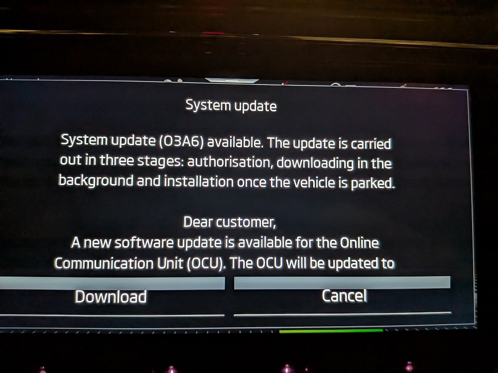

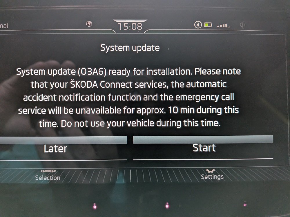

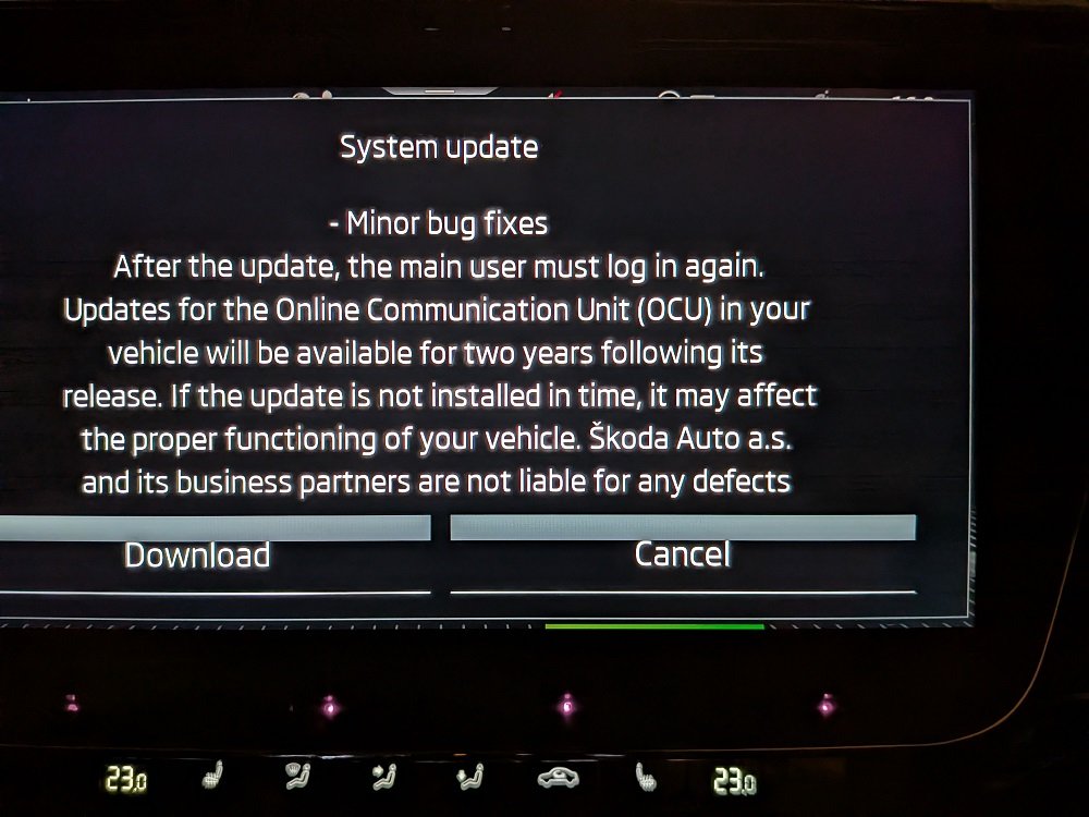

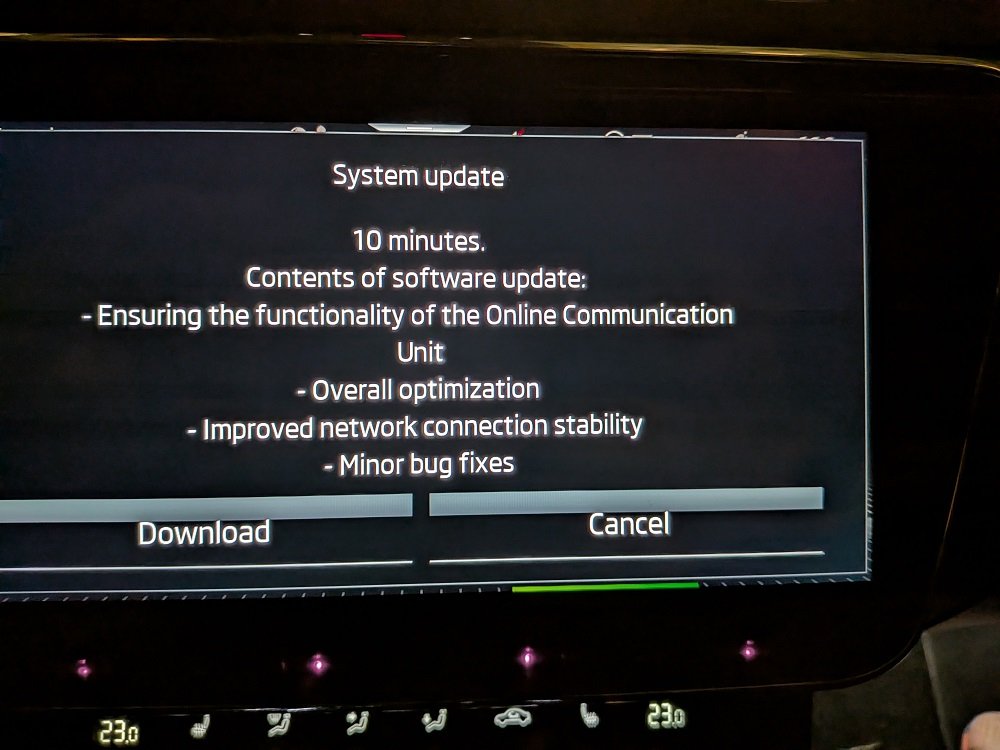

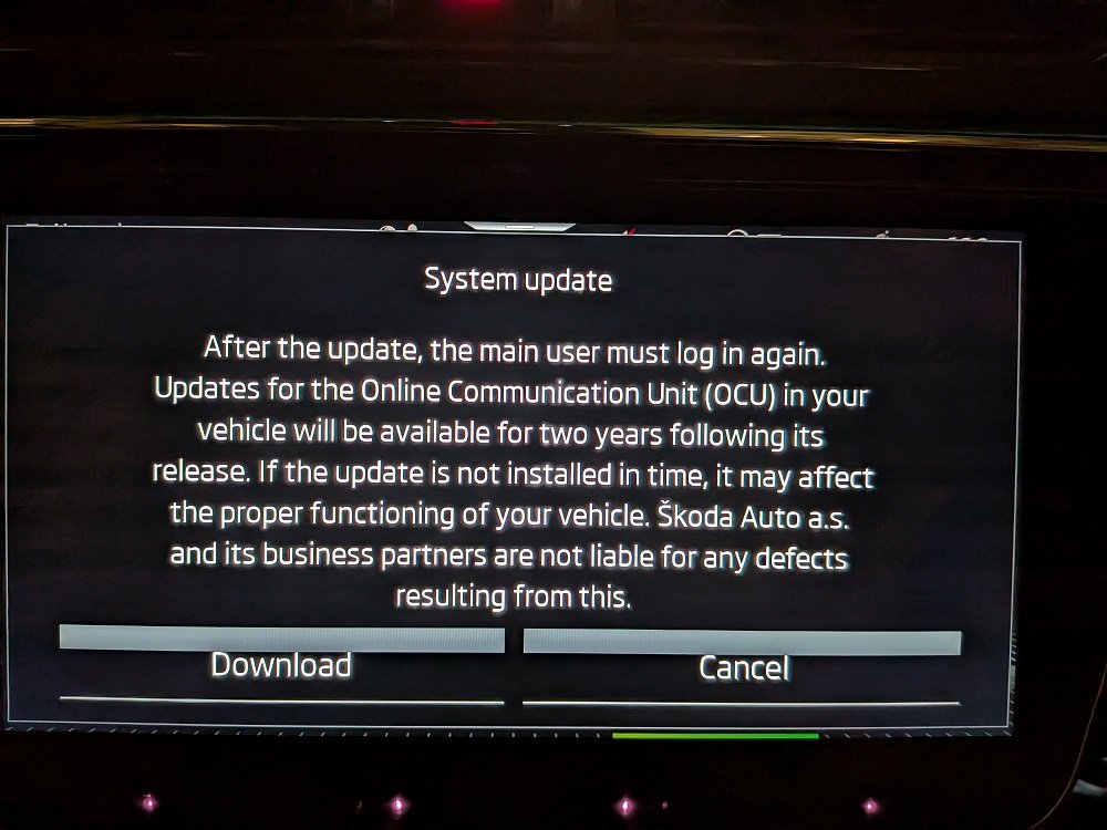

OCU Update 03A6 - Settings Lost after Update
Last week, my car offered me an OTA update for the "OCU" Online Communications Unit. I chose update and after a few days it told me the download was ready to install. The install would start when I next turned off the vehicle & would take 10 minutes where several systems would not be available & I should not drive the car. I accepted & 2 days later I came to the car. On Startup it told me the OCU update is complete. However, i realised afterwards the car was not behaving like usual & several features were unavailable.... e.g. Lane Assist is not working, speed sign recognition is not working, ACC predictive speed reduction (for roundabouts & sharp curves), phone connection/bluetooth is not working, the climate control settings were all "random" like Hi - 25, Auto-off. I checked some of the settings & found many of them were "deactivated" in the settings menu. I've turned the ones I can find back on (Lane Assist, Speed Signs, ACC Pre Learning) however, several things are still not working. Driver Assist is not working (although it is enabled) and the lane keeping is weak (like it is turned off). Lane Assist Steering vibration is not working (although it is enabled) Bluetooth/phone connect is not working - If I select "phone" from the menu the MIB hangs saying "please wait".... I can then only access the navigiation but no other menus... The update did mention that the main user would need to "login" again but it didnt prompt me to do it (There is only 1 user configured). I also had problems with the MySkoda app which reported "Window Status Uknown", however after a GooglePlay update yesterday, it seems ok now. Has anyone else seen this update & had any problems with it ? I was hoping that a quick ignition-off/on might sort it but it did nothing. I will try it again tomorrow to see if things are better....
