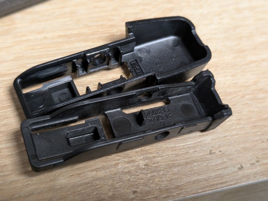

Rear wiper blade for L & K estate
My flat head screw driver was not right right tool 😬 ?
It could be the case that the latest design is more rigid than the previous one. You can't see it has crossed reinforcements in the plastic moulding which the previous one does not have. However both feel solid and unlikely to flex under the force of just the spring... My Octavia makes the same scraping noise even with the Bosch blades when they are coming to the end of their life. Looking at the profile, they don't particularly look worn or degraded. My assumption is that the rubber hardens over time in the UV light and this is what causes the scraping. It's not really how much you use the blade, rather how long it's exposed to the daylight that determines it's lifetime
The old one fits fine. Clicked back into place directly. When I fitted the new that thought immediately jumped into my head but luckily it fits without problems. Gabbo
The silence when it wipes the window was worth the wait.. I really can't see any reason why Skoda changed the design & also why is taken so long for the 3rd party manufacturers to design a small adapter to make it fit to the existing aftermarket blade

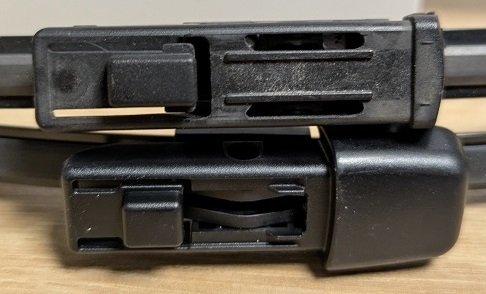

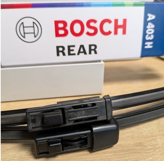

My wiper blade final arrived this afternoon. All went fine & fitted with a small suprise. The new wiper arm actually has a 1-2cm large sweep than the original part, fitting is simple & the new arm is fully compatible with the Bosch A403H blade. Total price for the new arm & bosch blade was €33 (24 + 8) not including the shipping so after 2 changes it is "cost neutral" to buying the new blade from Skoda directly. Here are some photos of the new & old wiper arm together. Top is the original arm from the car & bottom is the Skoda replacement. The original blade from the car has a higher quality finish (mottled effect instead of gloss plastic) but it doesnt really justify changing the design. One thing I noticed on the table was the placement of the "clipping" hole means that with the new arm the blade sticks out ~2cm more than the original. You can see this on the car once its fitted below..... I didnt clean the glass before hand as I thought it would help me make sure it was aligned but actually it shows clearly the difference in the sweep of the blade. Wash day is tomorrow I promise 😆
My parts are on the way today so I'm hoping to recieve before the weekend & I'll send some pictures of the differences in the parts
